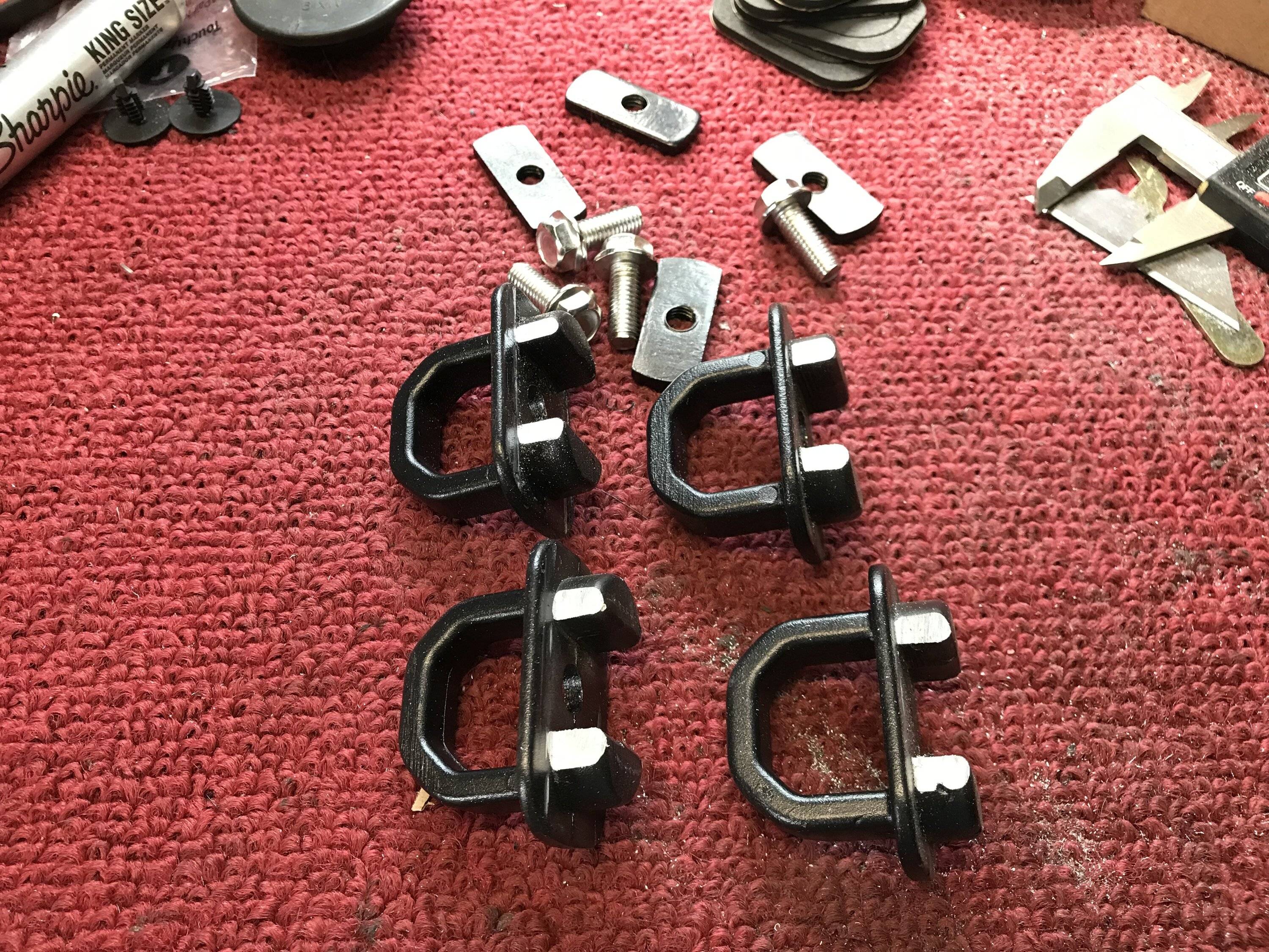

I was in the hunt for some additional bed cleats for my bed rails but didn’t want to lay down a Franklin for a set of factory ones so surfing the net I came across these on the web and of course found them on Amazon less than $16 all in for the set of 4 delivered…
Ford Maverick Inexpensive Bed Rail Cleats for my Truck IMG_1153

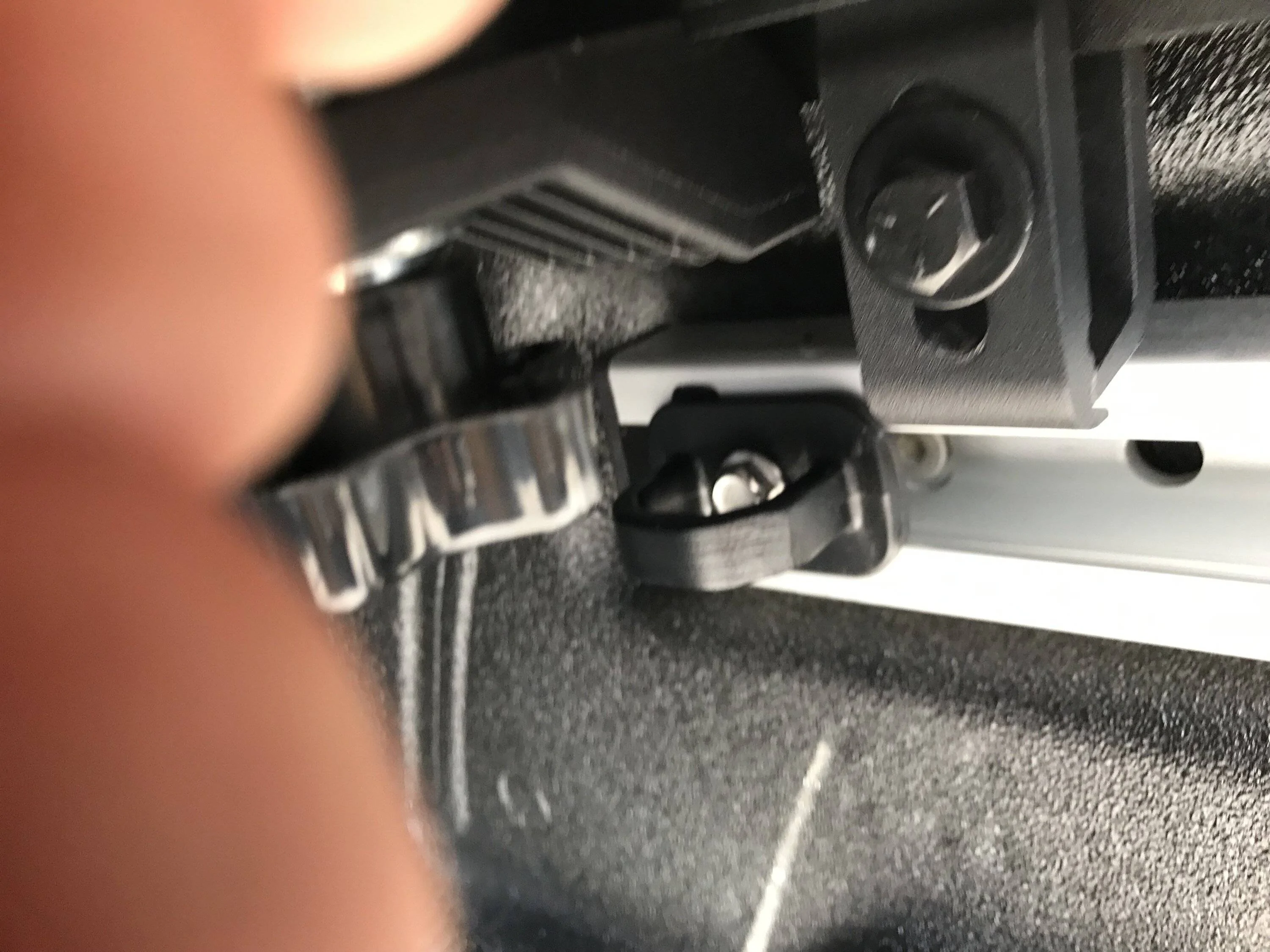

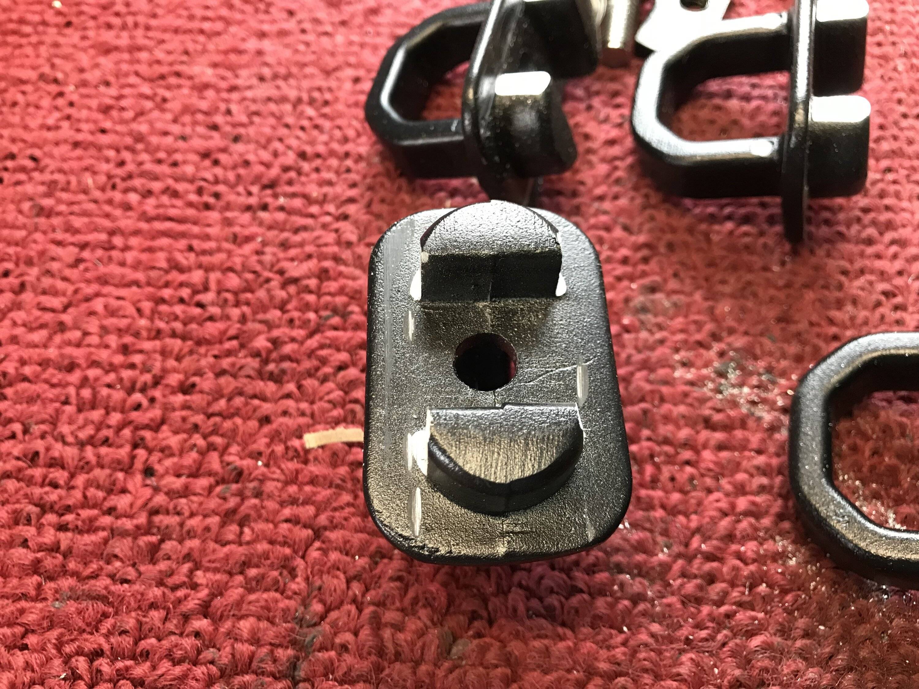

These were made of aluminum and it looked like they would work out so I ordered them, and after a trial fit it looked I would have to do a little trimming to make them fit into the rails I took a little over .030 off each of the bosses on each side and they fit perfectly..
Ford Maverick Inexpensive Bed Rail Cleats for my Truck IMG_3901
Ford Maverick Inexpensive Bed Rail Cleats for my Truck IMG_3900

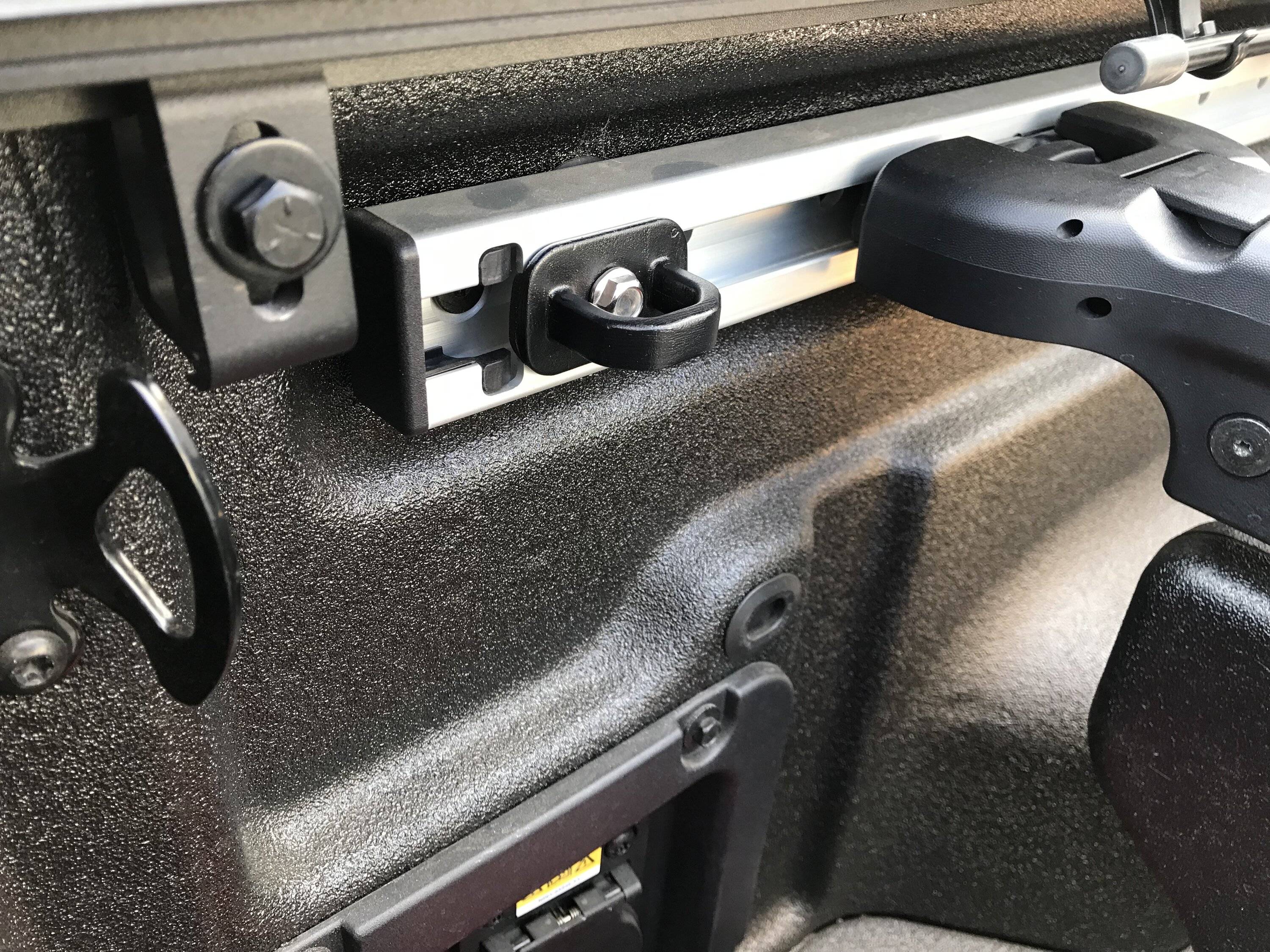

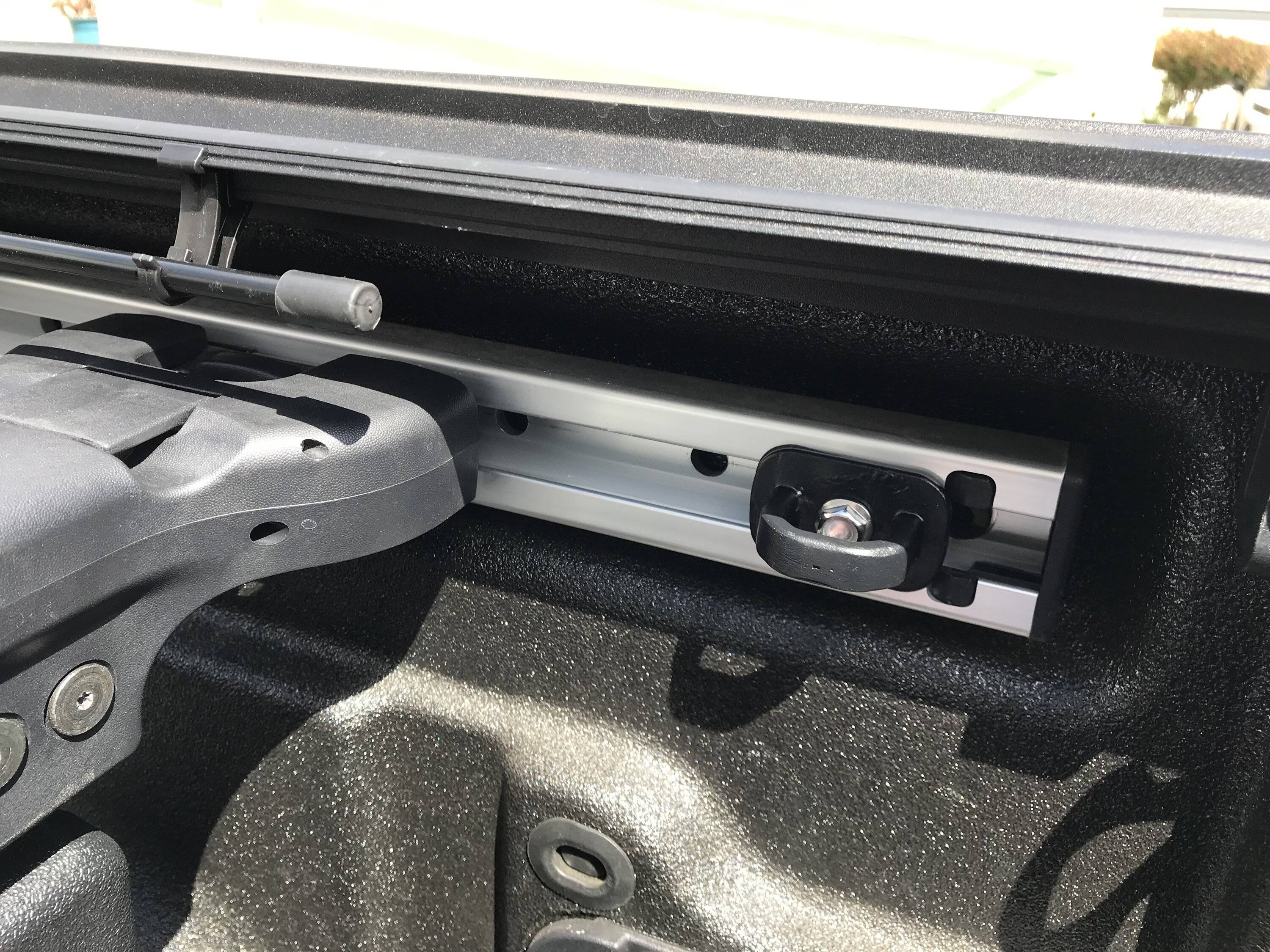

Here they are installed in the bed, they slide down the bed rail nicely and tighten with a just 12mm bolt… 2 at the rear and 2 at the front…

Yes. There are a couple of posts on this. I have the same exact ones with a photo tutorial on here, somewhere. These ones look like they are OEM parts. Good job. 👍
