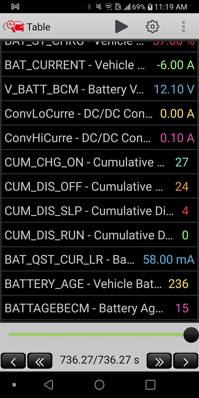

Doesn't even need to warm the engine.
Just Start it and let it sit for about 15-20 min.
Majority of charge will be in 10-15 min anyway.
Maybe the ICE will run - just depends.
But now you've just woken it, and the 75 min to go back asleep will probably use more power than just staying asleep.
Put it into deep sleep mode yourself if concerned - pull fuse 11. Hopefully get lower than 58 mA in sleep mode.
Don't lock doors so it won't do BMS relearn efforts.
After 236 days below (over 365 actually, I did BMS reset for attempted help - failure), only 4 Ah in sleep mode (that's after the 75 min), compared to 24 Ah during all the up to 75 min chunks - and I'm not doing a ton of short trips daily to make a ton of 75 min chunks.
Ford Maverick Idle for 2 weeks Screenshot_20250619-111952
