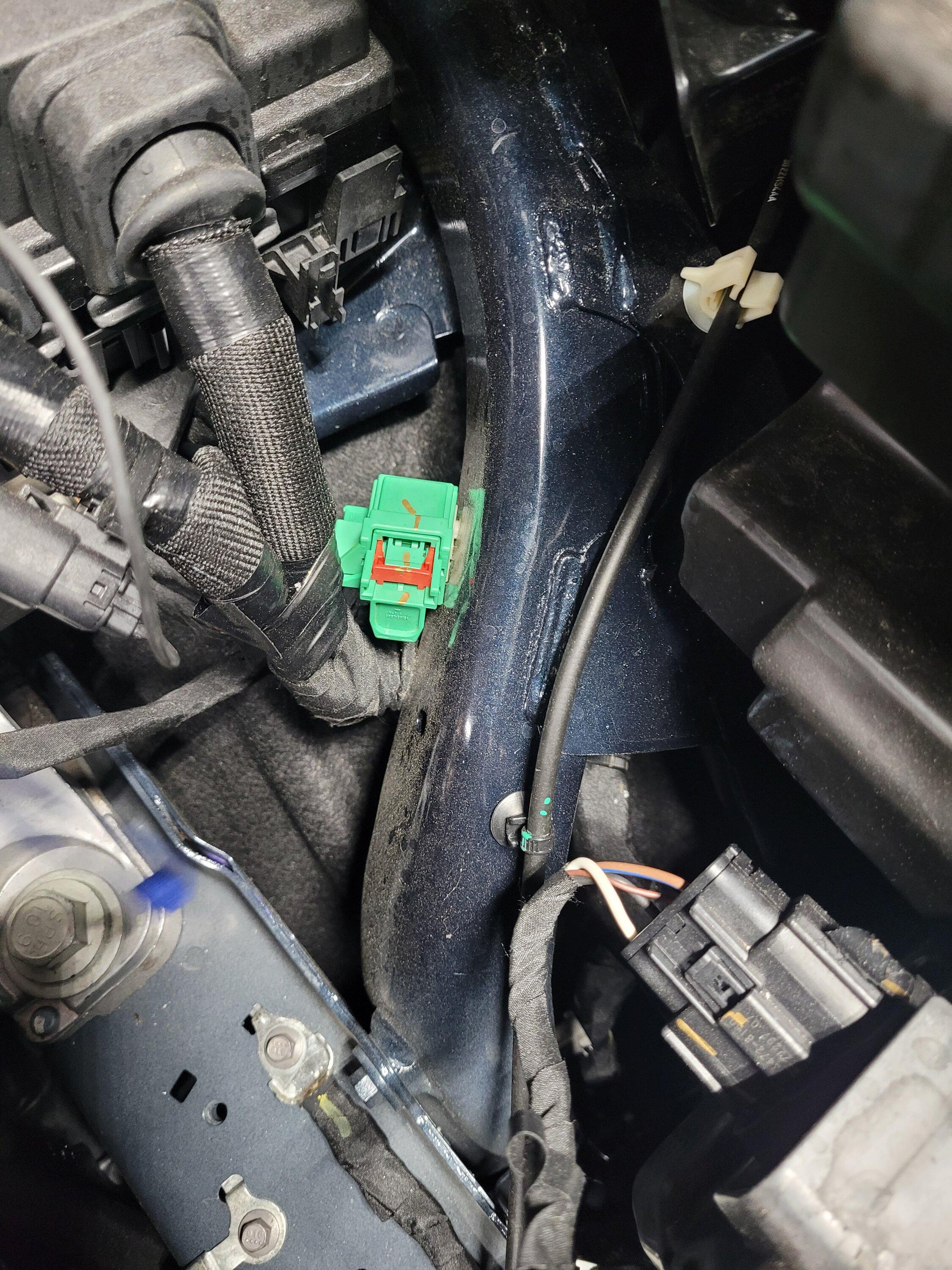

Hybrid owners need to know that there is a small green plug in the engine compartment just near the driver's side headlamp. You pull the end piece out of that plug and it kills the high voltage clear back to the battery. BTW, Page 320 of the owner's manual recommends some things to do before washing the engine.
Ford Maverick Hybrid Underhood Cleaning Safety 20230807_123502[1]
