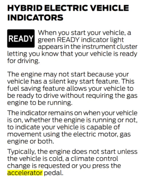

Hybrid question: can you start the ICE independently?
MakinDoForNow
Sep 24, 2021
8,479
6,045
Mash on the gas in Park and the ICE will fire up and stay running at idle speed (not sure how long).
In park the computer limits the ice rpm to that needed to generate needed electricity it knows no power is needed for propulsion.
