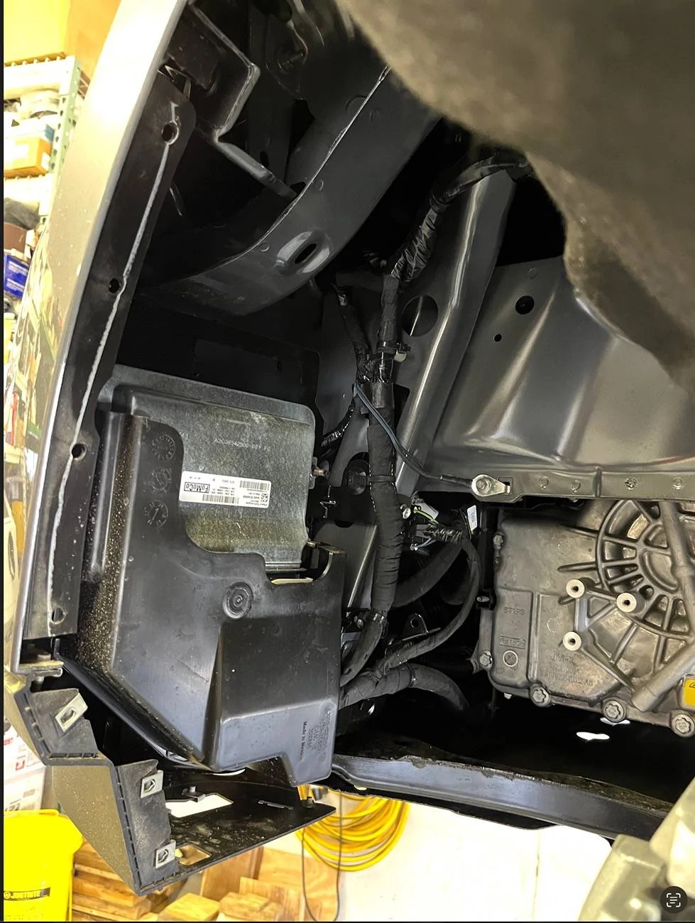

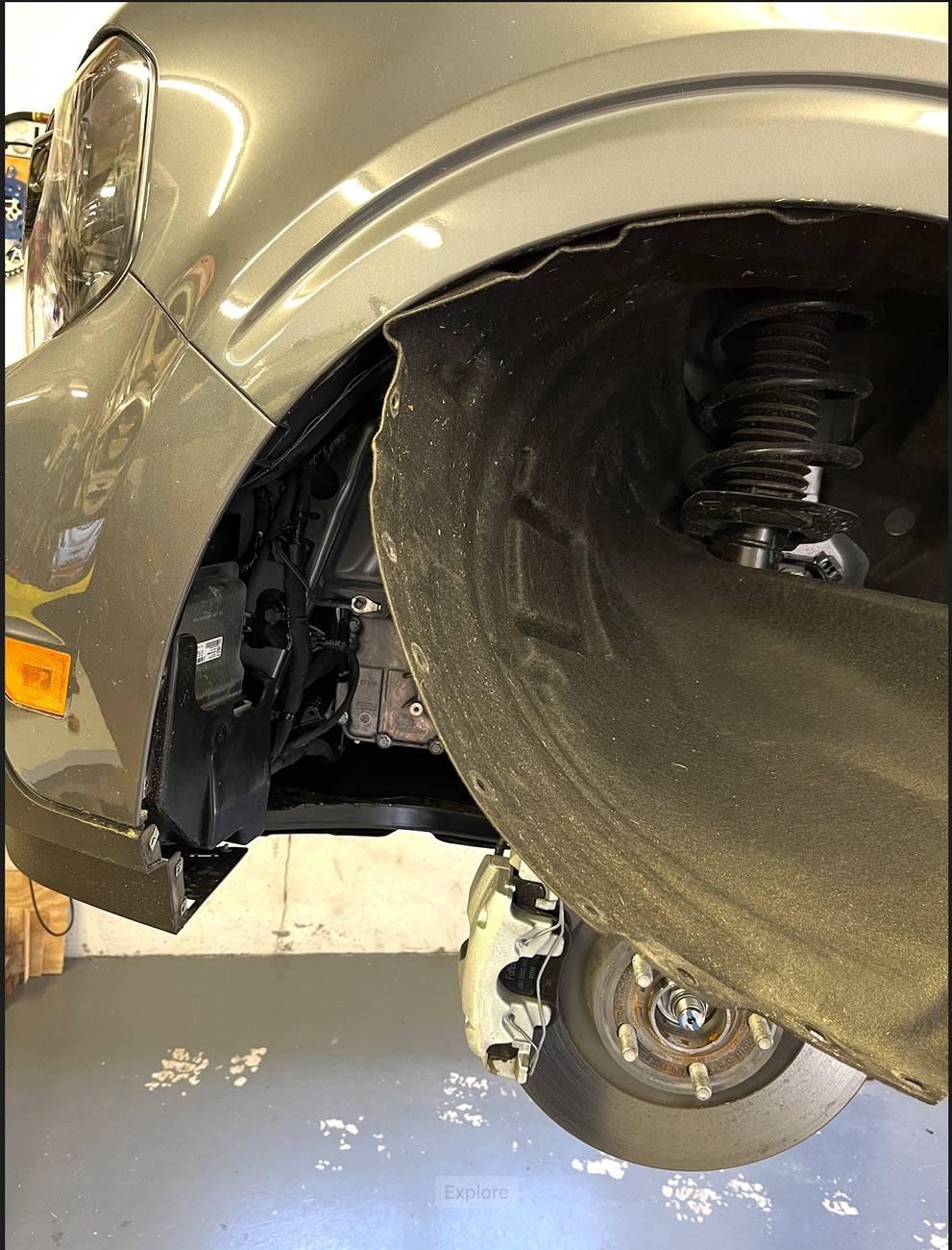

Bonilla, how easy or difficult was the install?
Gotta peel back the front driver side wheel well liner but you can then wiggle your arm in to get at the speaker connector..I had my truck on a hoist and took off front tire. Made it much easier. I thought about taking the bumper cover off but that could be opening a bigger can of worms...
