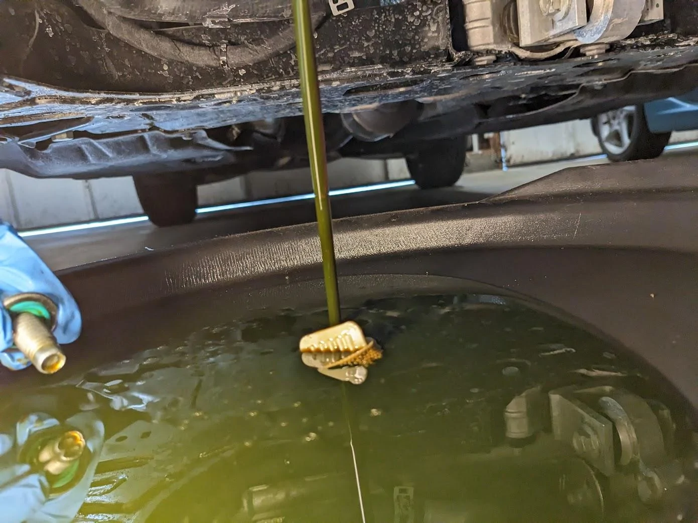

I took some of the same type pictures underneath the engine and of the skid plate yesterday during my first oil change on my Tremor. I removed the skid plate and weighed it using a spring scale, and was surprised when it came in at 20 pounds! After draining the oil, I was also surprised at the amount of oil that ran out of the drain plug when loosening the oil filter. A funny thing was, the oil came out of the drain an amber color as viewed with the sunlight shining through it, but was a fairly gross darkish green in the drain pan. Bizarre.

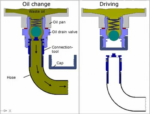

While I was at it, I installed one of those quick oil change valves. I bought it through Pegasus Racing, and it is a quality item manufactured by Aeroquip. The drain coupling takes a 3/4" hose and is a push-to-lock attachment. To release, just pull back on the blue ring and it pops loose. A knurled cap works with a built-in gasket on the valve to keep the dust out. We'll find out at the next oil change if it was worth it, or turns out to be a boondoggle!

Dust cap removed and drain coupling in place (sans hose). Amber color oil drips from the engine, but looks like some sort of green death in the drain pan.
Call Mulder and Scully!

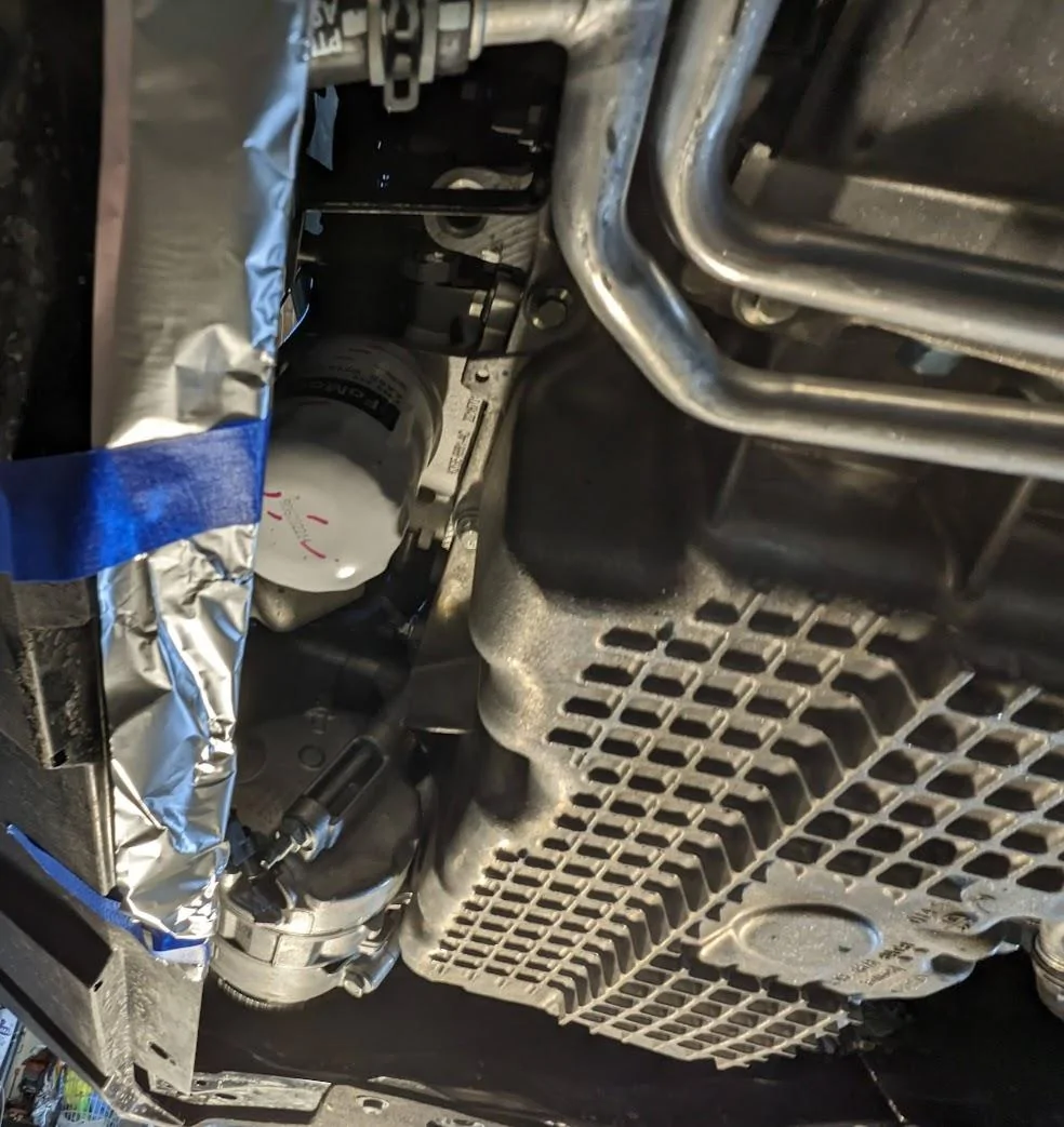

Thanks for this! Just changed the oil on my '24 Tremor. The oil filter was..... really really tight.
I had to run to the auto parts store to get a filter socket/adapter (76MM 14FL).

Mine was super tight as well. I ended up doing it late so didn’t have the ability to go to a store for a filter wrench. The screwdriver through it trick eventually worked after tearing it up a bit and getting worried I was going to have quite the mess getting it off. Finally got it to work. Quite annoying, and a bit time consuming.

I used a adjustable Oil Filter Tool that works on filters from 2 1/2" to 3 1/8"
https://www.amazon.com/dp/B0002SR4Q8
You will need something to get the filter off, it is not just hand tight.
