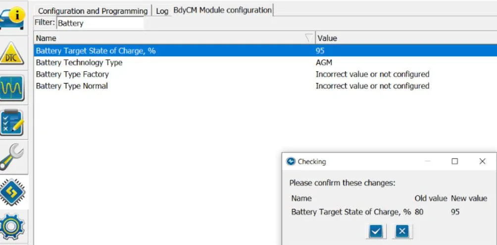

Does that actually work?
"In other words, the parameter being changed from 80 to 95 via Forscan doesn't appear to have any significant observable impact on your State of Charge, (but putting a charger on your battery might)."
https://www.f150gen14.com/forum/thr...tery-charge-rate-in-forscan.21552/post-415205
Doesn't appear to have any effect. I set it from 80% to 95% in Nov 2023.
I watched the Maverick charge the 12V battery after using it in accessory mode while using Forscan.
At start @1609 on 4-12: 75% SOC, 25 Amps Charging.
Ford Maverick Hopefully no more "Deep Sleep" for a while 75% SOC, 25 Amp Battery Current - Forscan Live Data @1609 2024-04-12
When I stopped monitoring @1704 on 4-12: 80% SOC, 2 Amps Charging.
Ford Maverick Hopefully no more "Deep Sleep" for a while 80% SOC, 2 Amp Battery Current - Forscan Live Data @1704 2024-04-12
Ford Maverick Hopefully no more "Deep Sleep" for a while BdyCM Module 95% Battery Target SOC% 2023-11-23

wondering how the up coming battery software recall will effect this condition, if at all.
Maybe this change does not affect the hybrid like the EB. I noticed via ScanGauge, that the alternator would not charge when the SoC was above 80%. When I changed the the charge level to 95%, my alternator immediately started charging my new AGM battery.

Maybe this change does not affect the hybrid like the EB. I noticed via ScanGauge, that the alternator would not charge when the SoC was above 80%. When I changed the the charge level to 95%, mt alternator immediately started charging my new AGM battery.
Good point.
