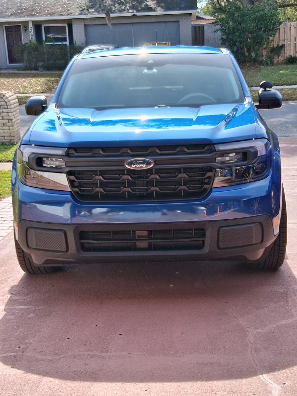

My passenger airbag light keeps flickering, the light stays on, but goes from dark light to bright light . Any suggestions on what I should do, it is only this light. Had wreck, front end crash with no airbag deployed, in Nov. of last year and it just started doing this.
Help maybe , what to do .

I would def take it back to the shop that did the collision repairs to get their take on it....first glance, it sounds like a loose ground.

Airbag crash sensor in the front end or the seat sensor.. Take it back to the body shop that fixed it see what they say. How bad was your Mav hit?

$ 11,000.00 damage to front end, the did a good job , but?

Wow yes that was a good hit. Glad your ok and the Mav was not a total loss a lot are. You said the airbags did not deploy? I am thinking its a sensor that is glitching. Give the Body Shop a ring and make an apt. They can hook it up and scan the Computer systems to see if there is a fault in a sensor.
