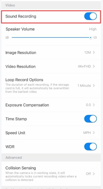

Do they record audio as well? FYI, I prefer no audio.
Yeah, it records sound by default, but you can easily turn it off in the app. Just head into the settings and toggle off "Sound Recording"(see screenshot below)

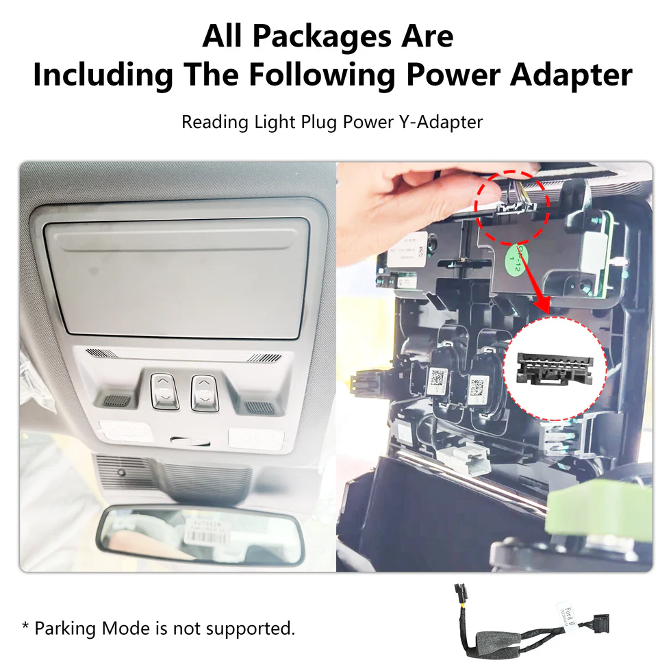

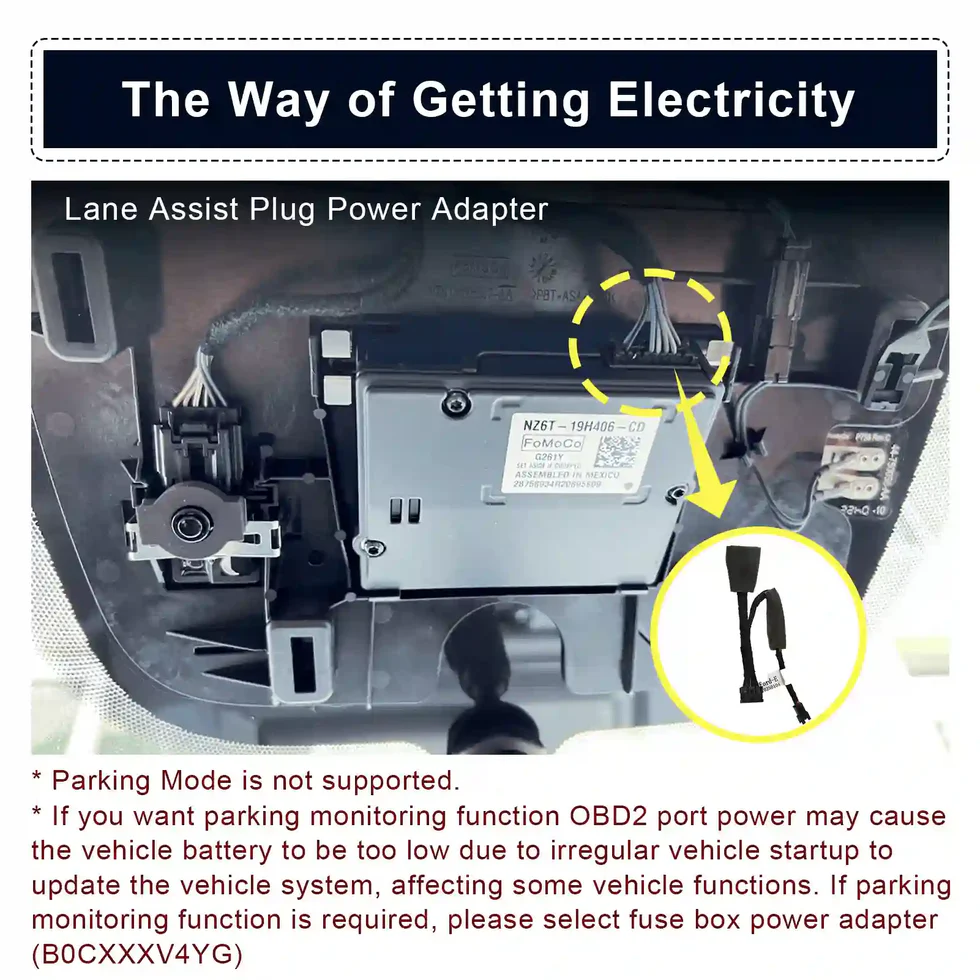

So this is a plug in even if you don’t have a powered mirror?
Yep, exactly. Neither model relies on a powered mirror at all.
  • Model A (2022–2024, like your '23 XLT): It plugs directly into the Lane Assist camera harness inside the plastic housing above the mirror.
  • Model B (2025–2026): It taps into the overhead reading light harness inside the console with a Y-adapter.
Model A:
Model B:
Do you sell these Maverick-specific adapters separately? I don't think these are the same as I see in your accessories area.
