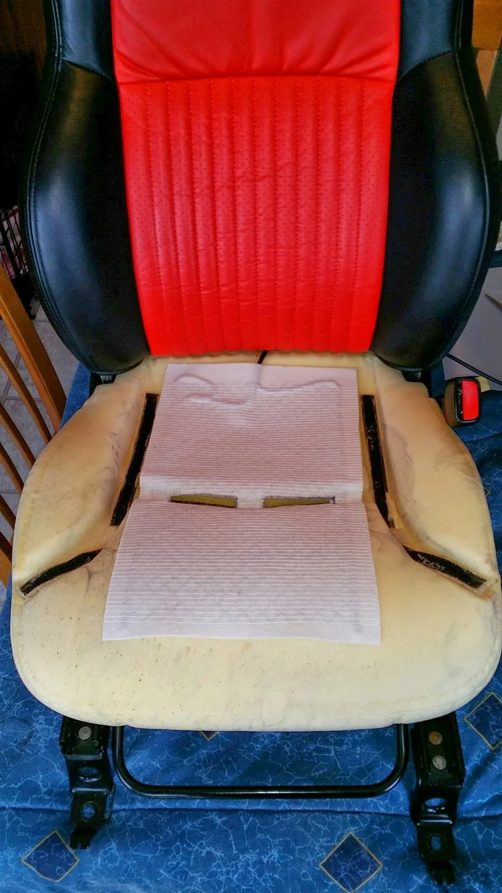

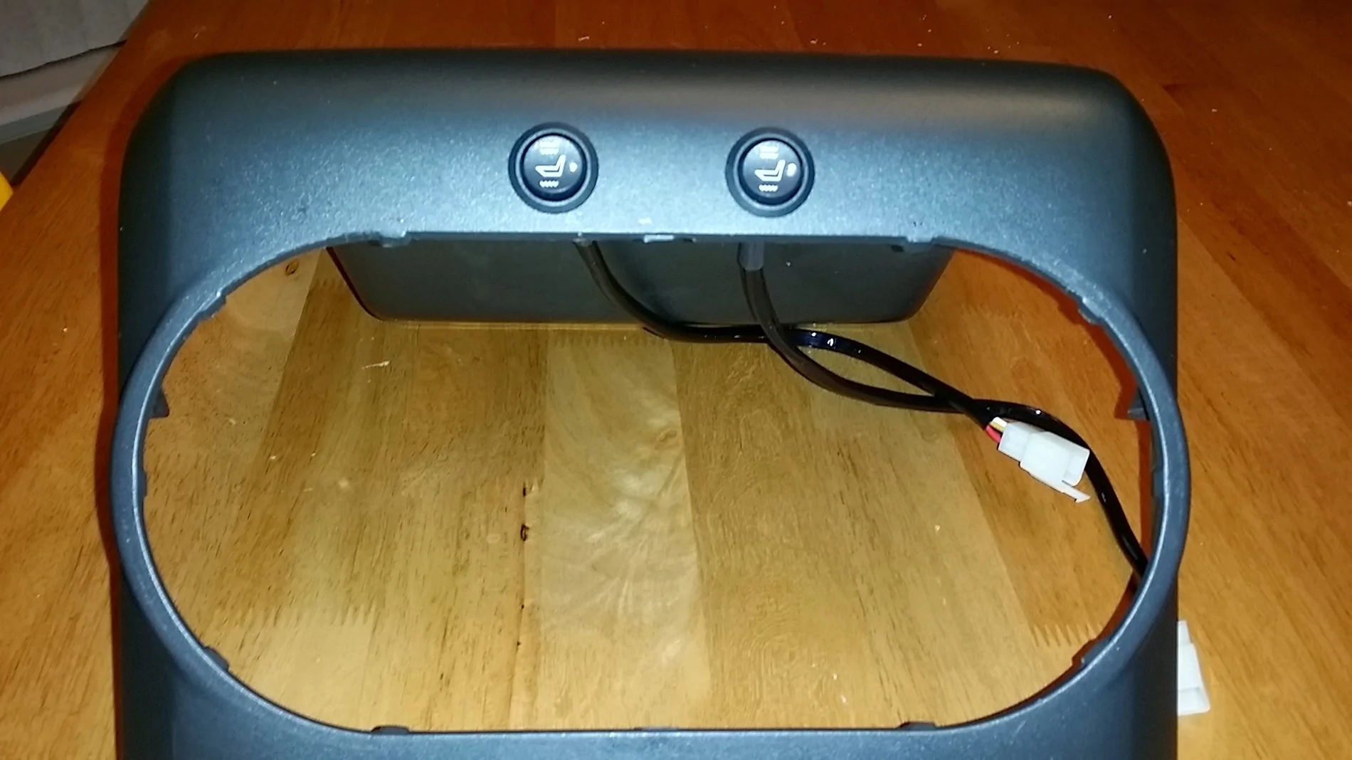

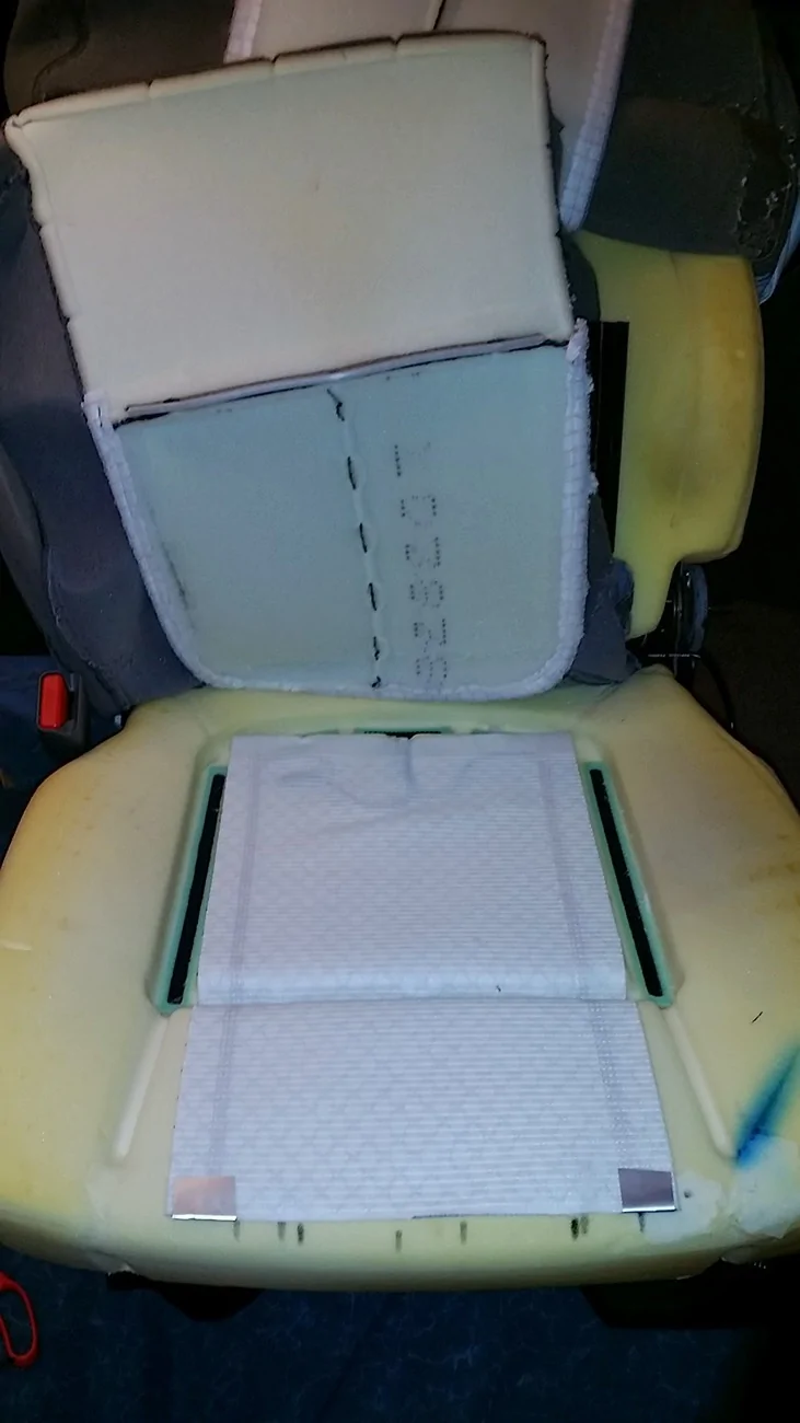

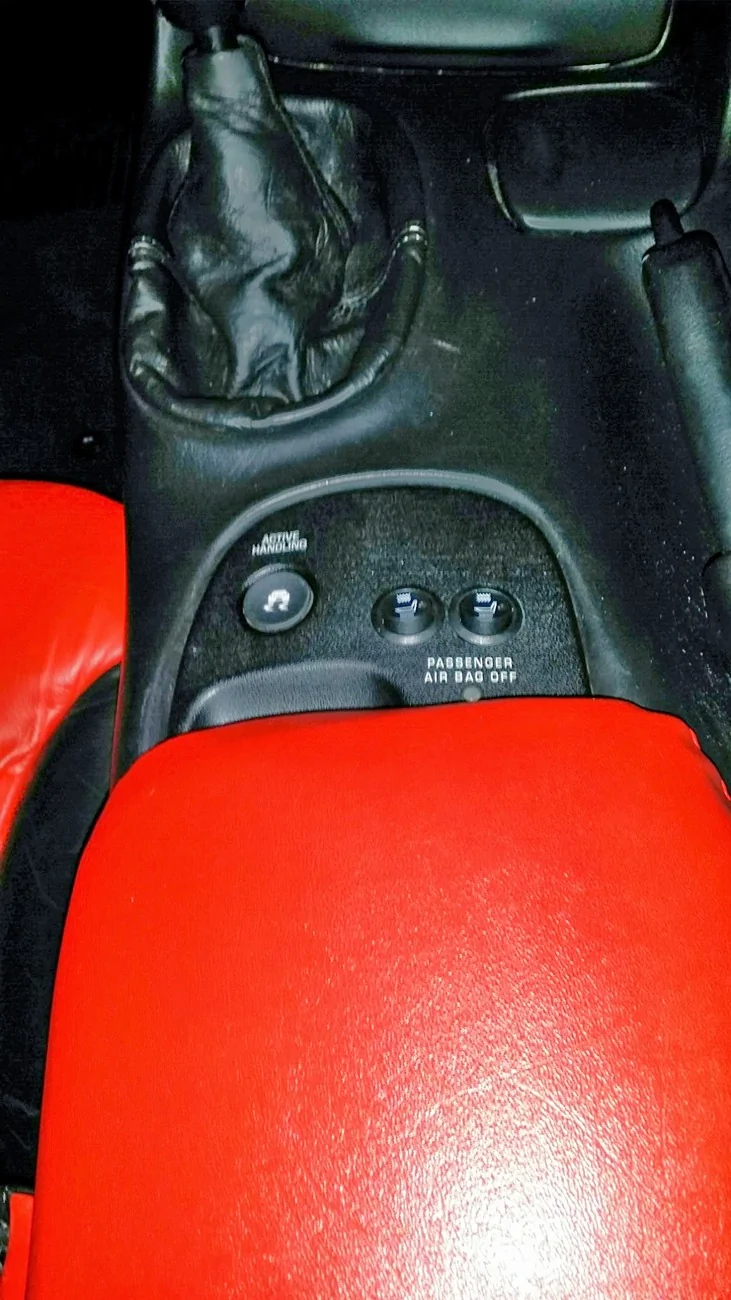

I've used heated seat kits sold on Amazon and ebay all have worked great and been easy to install. Works best if you also have remote start and tap the heated seat circuit and add a relay to power them only with the engine running.
Just use zip ties or the hog rings used to hold the seat fabric down, works perfect.
This is almost identical to the kids I've installed on my wife's 16 Fusion on my over 2012 f150 and my dad's 02 Z06.

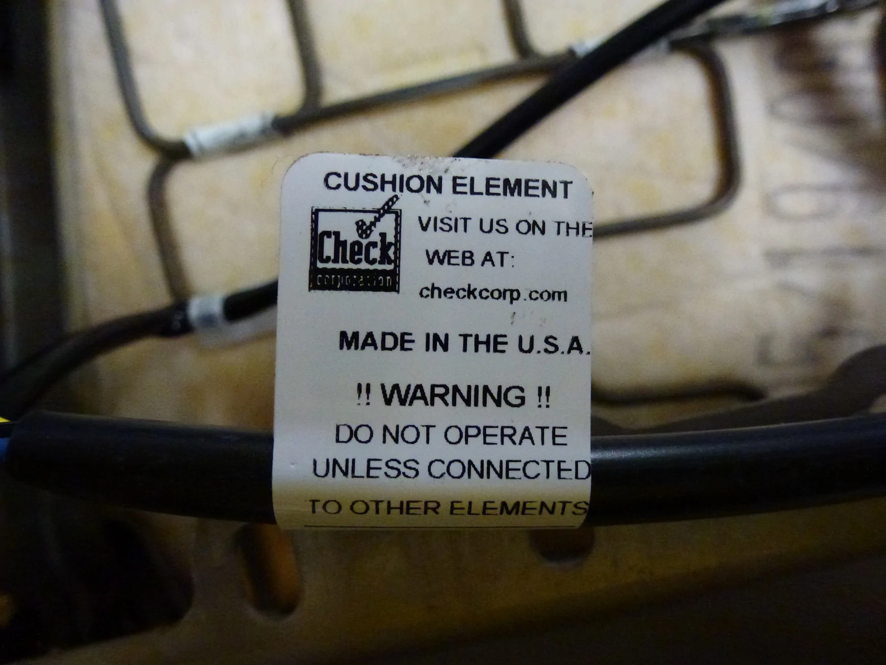

I've used heated seat kits from "Check Corporation" out of the Detroit Mich area. Installed a couple of them over the past 15 years. Great quality, Made in USA and they get HOT right away. Will be putting a set into my 1992 F-150 upon restoration
