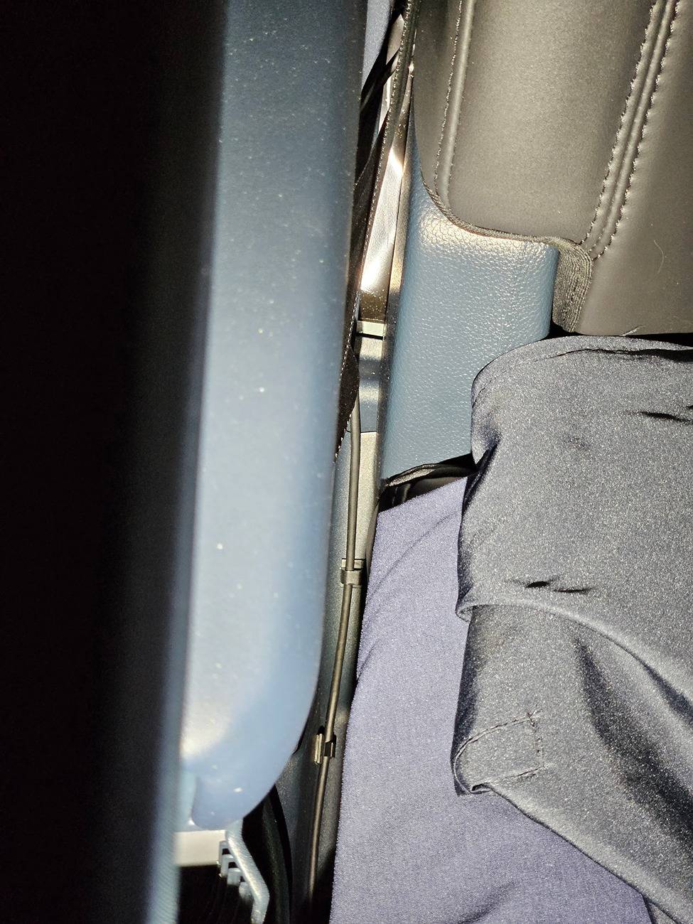

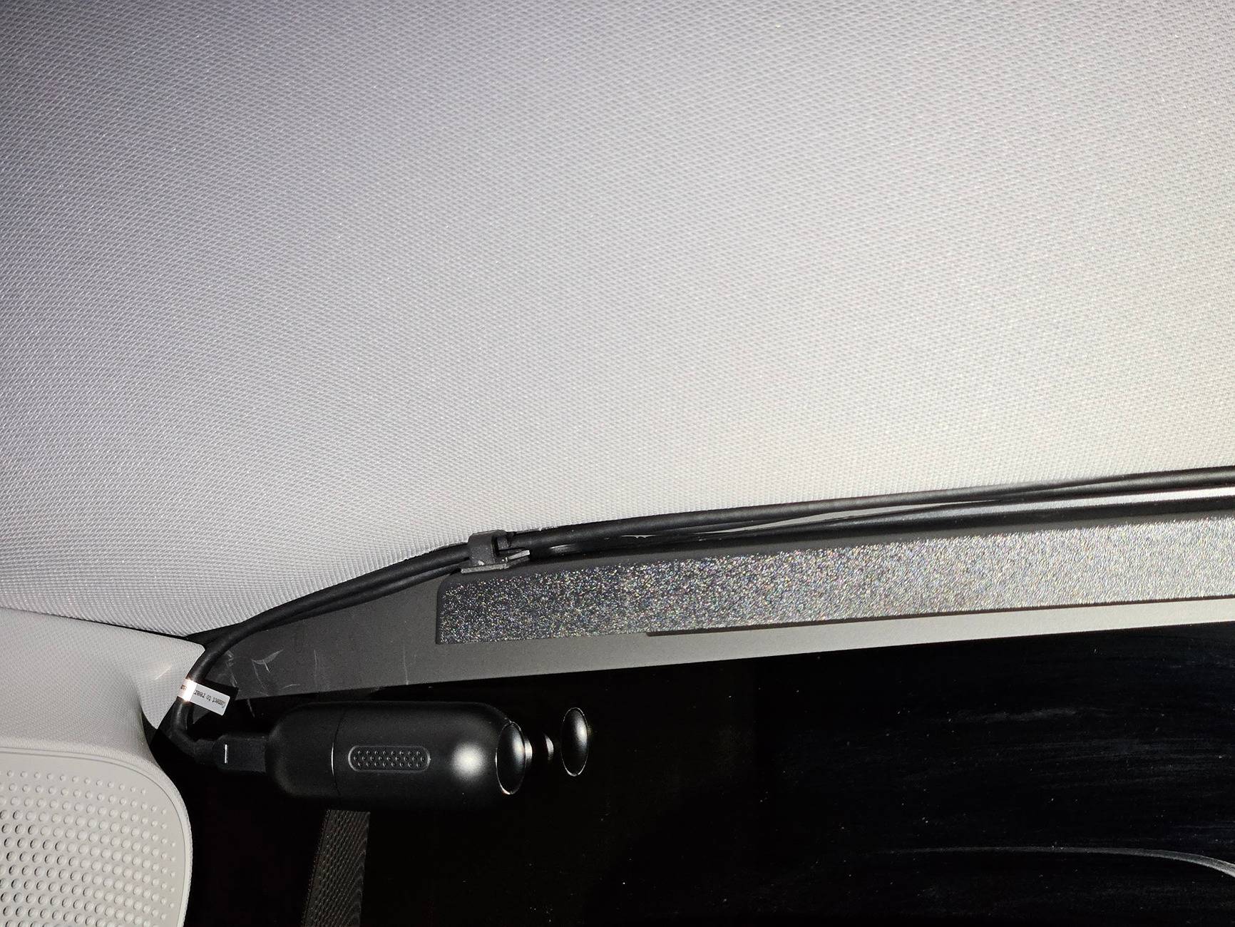

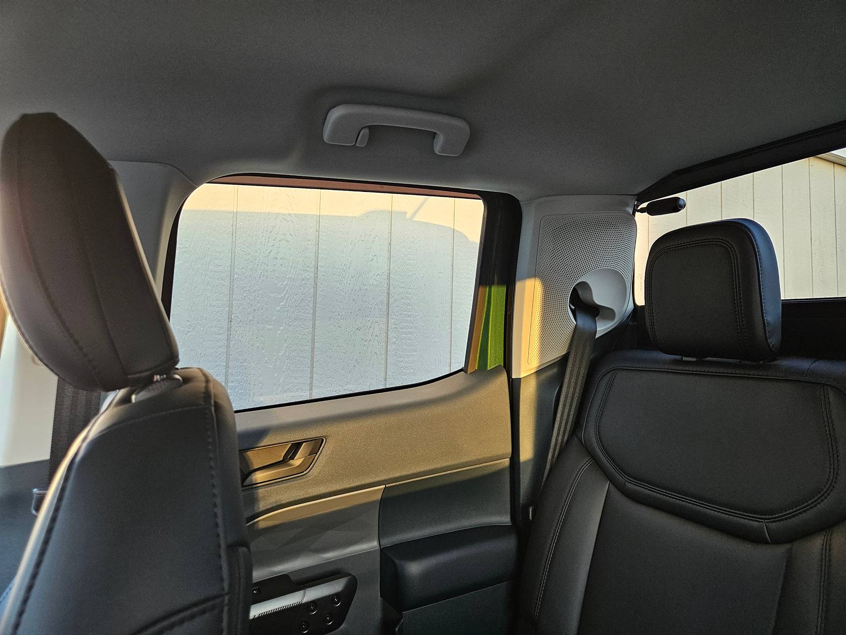

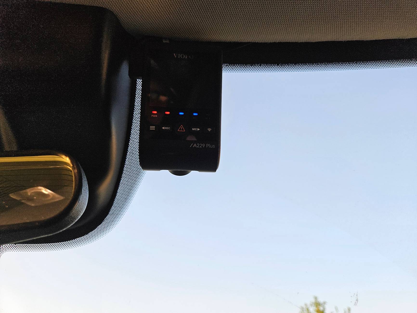

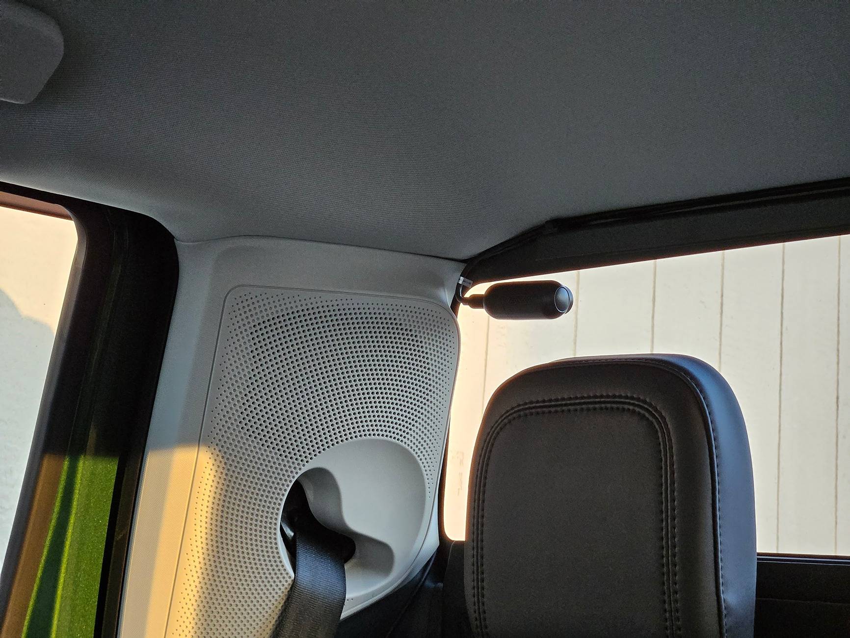

I used these cable clips to secure the rear-wire along the passenger side and near the rear headliner.
