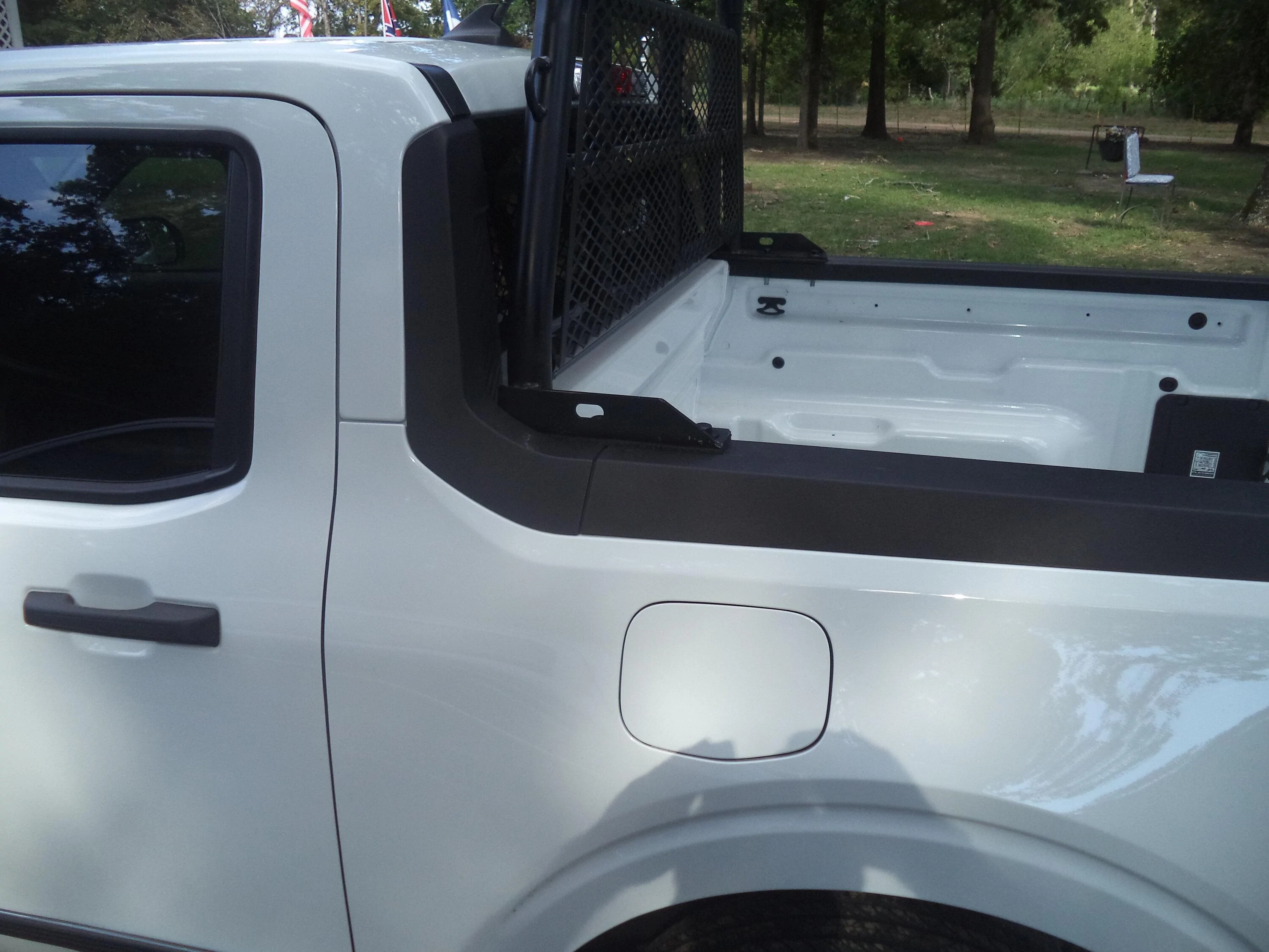

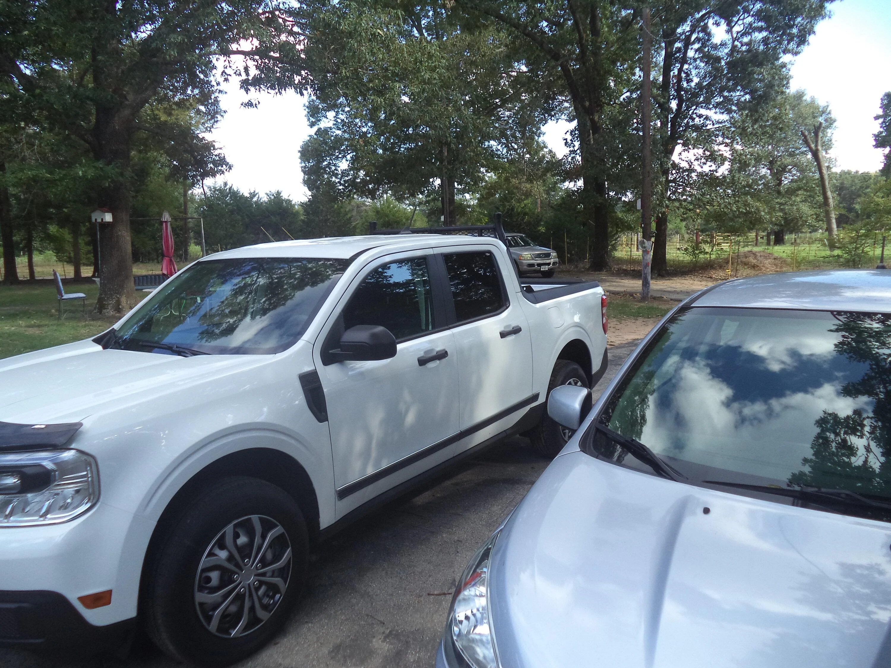

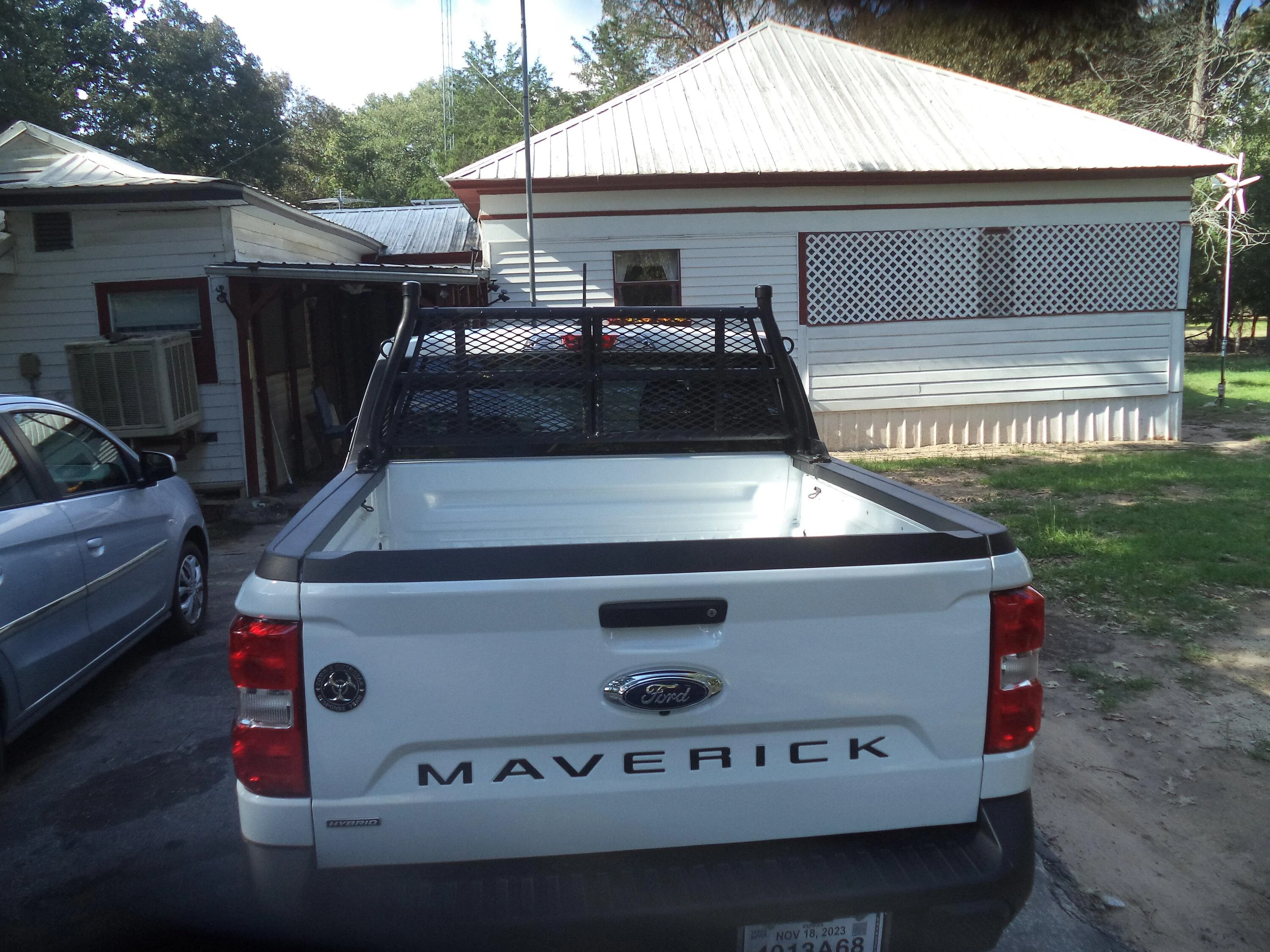

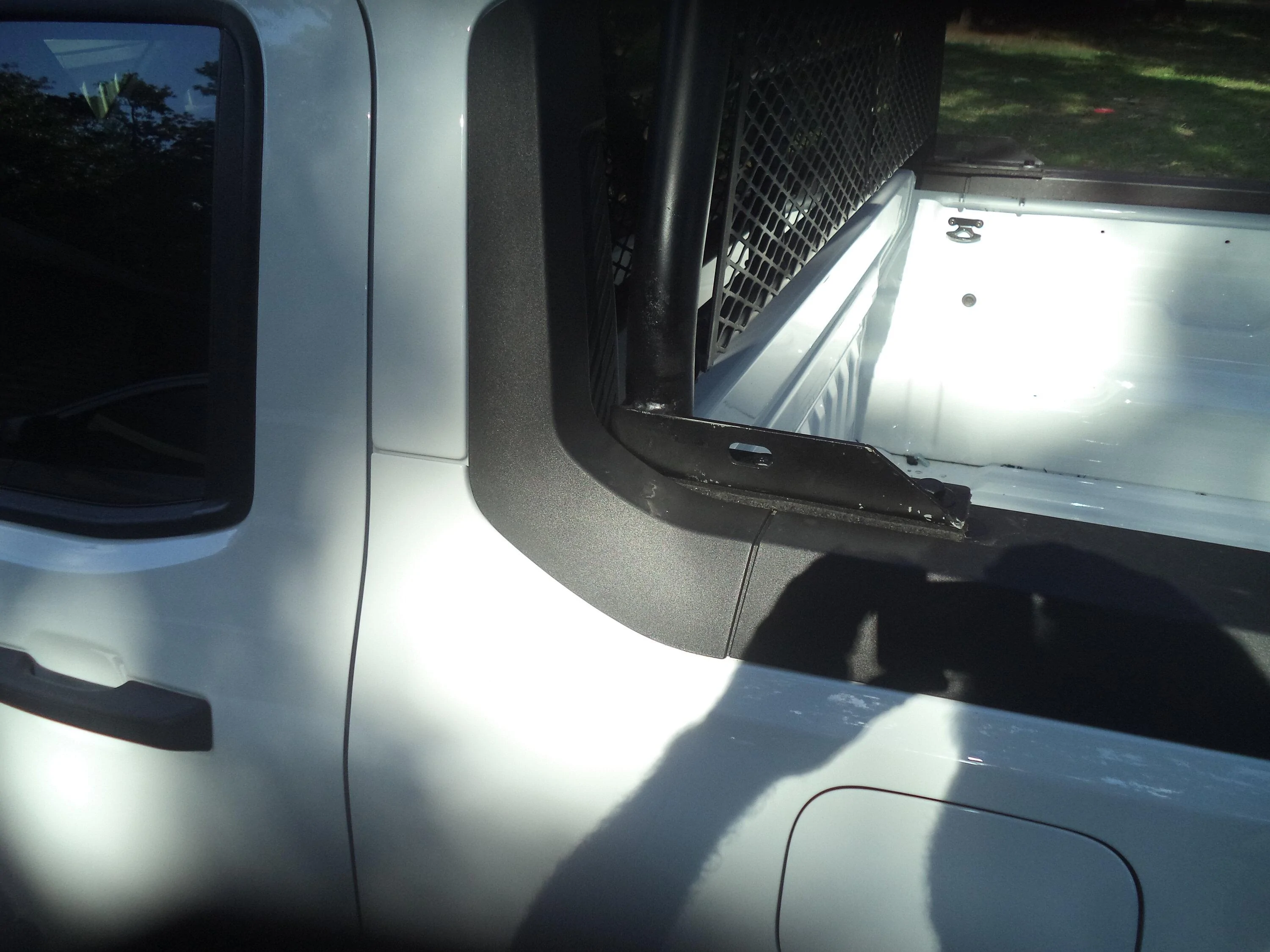

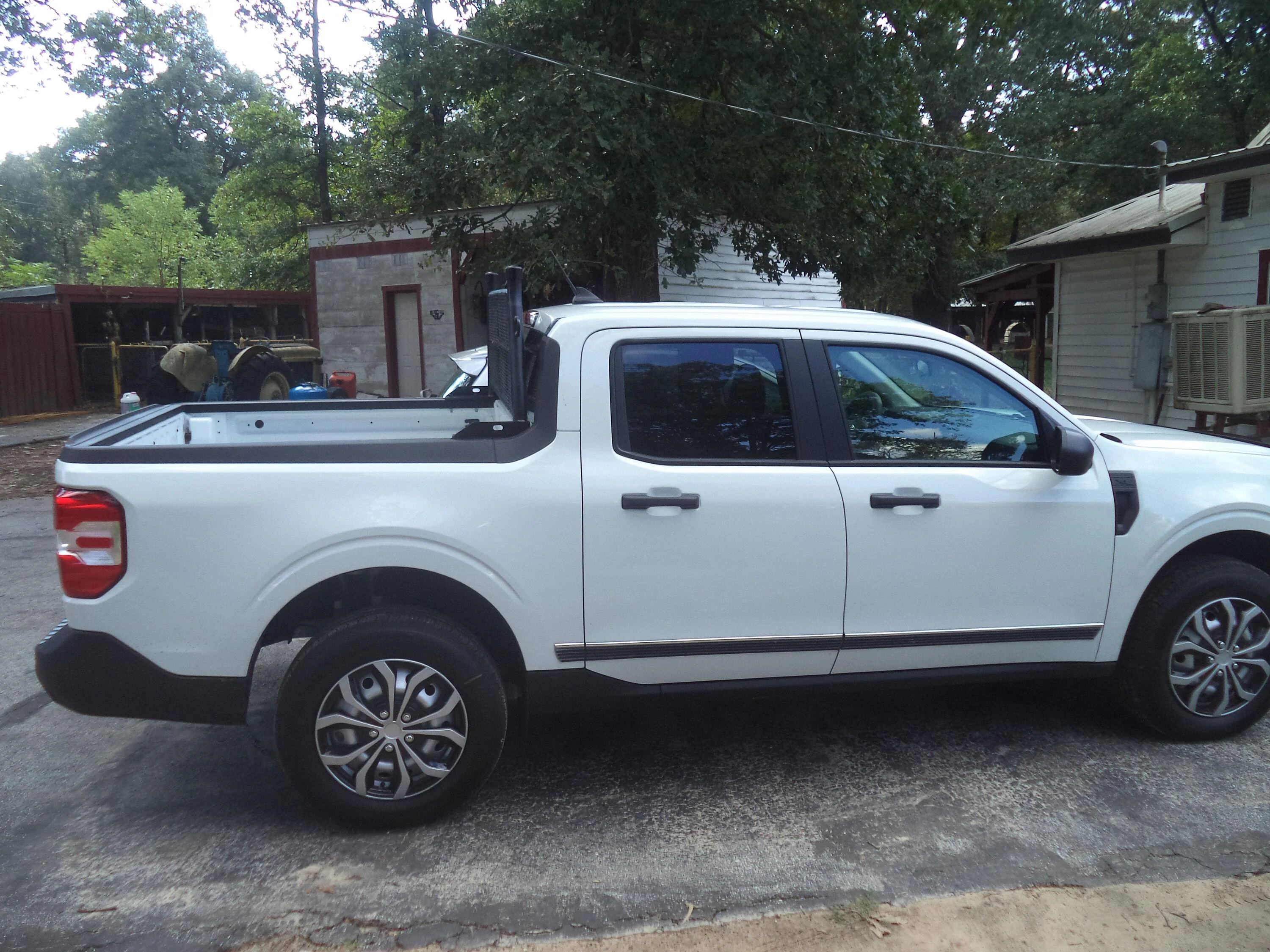

Well Here are the Pics. Just a Note the area that is the closest to the Cab I Ground that down with a angle grinder for a better fit. If I had not it would have pressed to hard on the ABS. With A HF Angle grinder it took less than 10 min.

Ford Maverick Head Ache Rack on the Cheep DSC00591
Ford Maverick Head Ache Rack on the Cheep DSC00592
Ford Maverick Head Ache Rack on the Cheep DSC00593
Ford Maverick Head Ache Rack on the Cheep DSC00594
Ford Maverick Head Ache Rack on the Cheep DSC00595
Hello and thanks for the multiple pics - that helps me visualize your project. [I too have an Oxford white Mav with the raised black tailgate letters.]
