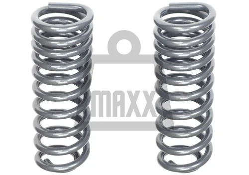

Any Maverick owners out there upgrade their rear coils to a heavier duty set up like the ones in the link below? If so, what are your thoughts?
HD Coil Springs
I know these trucks aren’t meant for “hauling” but seems like a low cost upgrade to the rear suspension that could help with sag when carrying heavy loads.

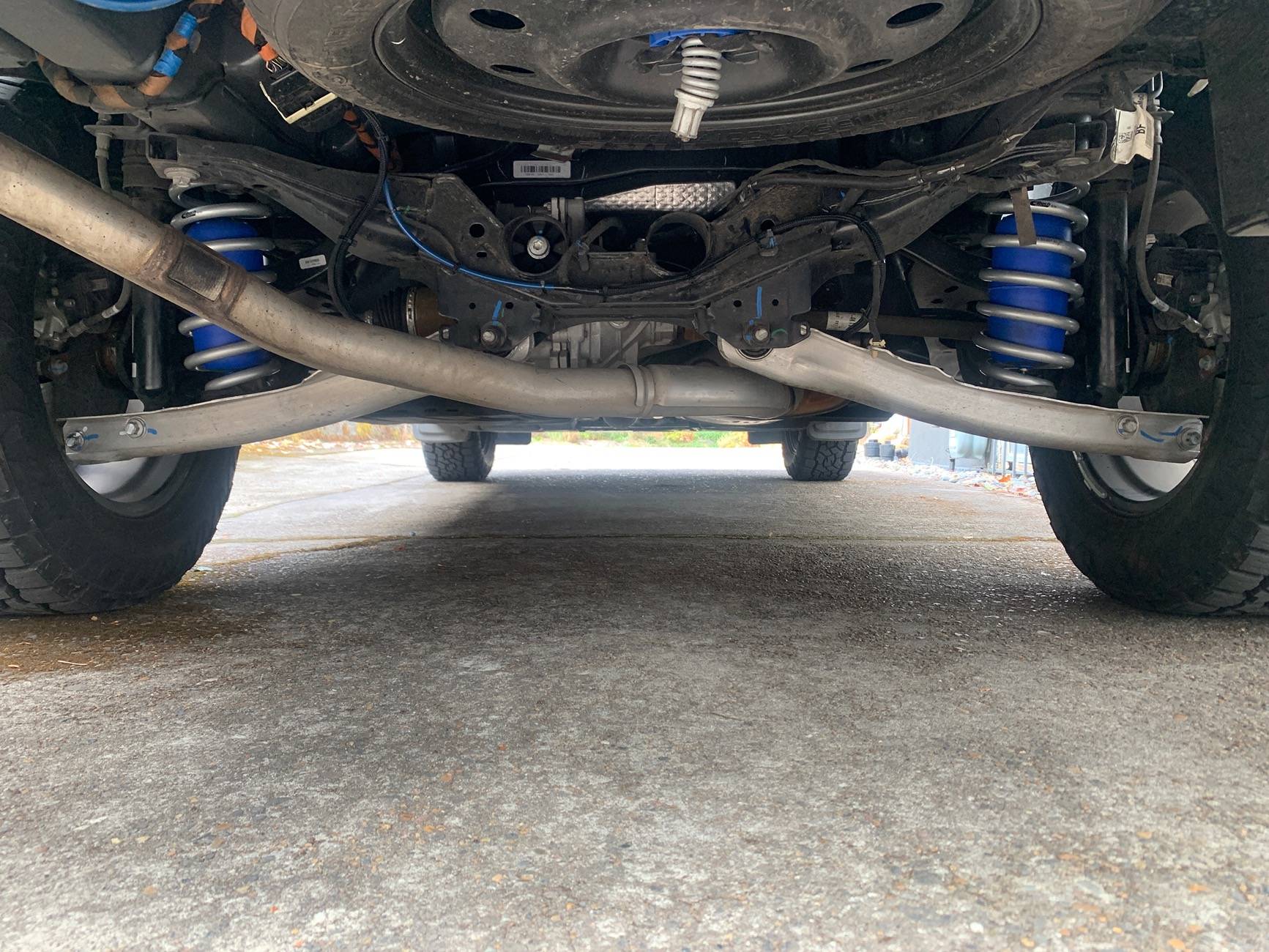

I’m actually having Firestone coil rite airbags installed later this month. They were cheaper than the HD coils. But curious what the effect would be if you combined airbags and HD coils. Overkill maybe?

How did the Firestone Coil-rite air bags work out for you ? Do you have any pictures?

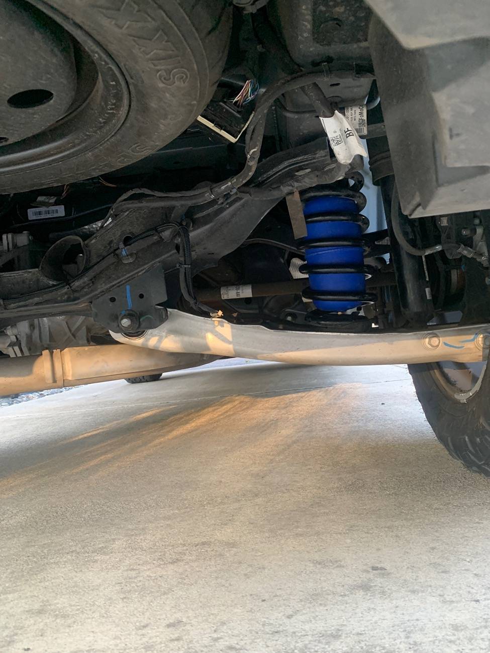

They work great! I had them installed in the stock suspension and they really helped with heavy loads and squat. But now I have them installed in HD Eibach PLK rear coils. There’s a little over an inch lift at the rear so the airbags don’t support as much as they did in the stock suspension. But they still help with sway or bounce in the suspension with heavy loads. (Pics attached - black is stock with coil rite bags / silver is the Eibach PLK with the same airbags swapped over)
