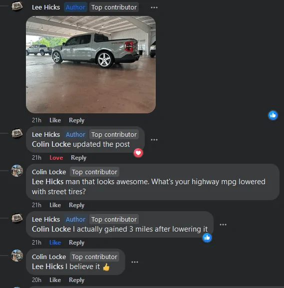

found one in a FB group. he lowered it and put on street tires! LOL we will never know how much each helped.

Yes, I'm sure. He posted pics of the before & after. No idea if he deleted the skid plates, they're just extra weight for a lowered street truck.
This truck probably would be very good for track days and autocross since you could force the PTU (center diff) into 50/50 locked, instead of it trying to go FWD anytime you're not accelerating hard, and if you're cornering at the limit, the torque vectoring rear differential unit would definitely be a benefit.
Unfortunately I think that without a front limited slip, it could have wheelspin on corner exits. You also would need a tune for track days to remove the speed limiter.

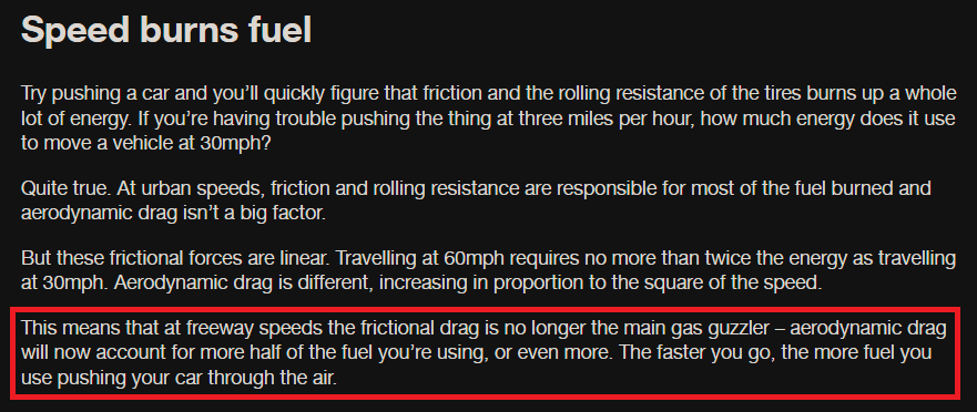

FWIW, my experience over the past year shows that the Maverick loses A LOT of fuel economy between 60 and 70 mph. Like, maybe 10 MPGs.
In my case, I have a lifted FX4 with oversized 245/70/17 tires. If I set the cruise to 60 on a flat freeway I can still get 26-27 MPG. However, at 70-75 mph that becomes like 18-19 MPG. Add in hills, headwinds, etc., and it all takes a toll.
Don't focus on my raw numbers as much as the principles. Like I said, my truck is modded and the added ride height, bigger tires and the rack I have in the back I am sure make my truck less fuel efficient than the average. That said, when it comes to MPGs, SPEED KILLS!

Yep 50-60 is the sweet spot for me too. When I'm in ID the speed limit is 60 on the same kind of raods where I live in Montana - which is 70 - and my MPG will easily be around 28 with the 245's just by slowing down 10mph. It was 30 (on the dash) for the drive home when I bought the truck for that reason (from WA though ID to MT). At 70 my MPG is around 25 and there is nothing that will improve it. If I take a trip in the opposite direction, staying in MT where the speed limit is 70 but I go 60 I get the same results. Much better MPG usually about 28. It's one reason why winter driving actually gets better MPG for me on some trips. It's at a lower highway speed.
