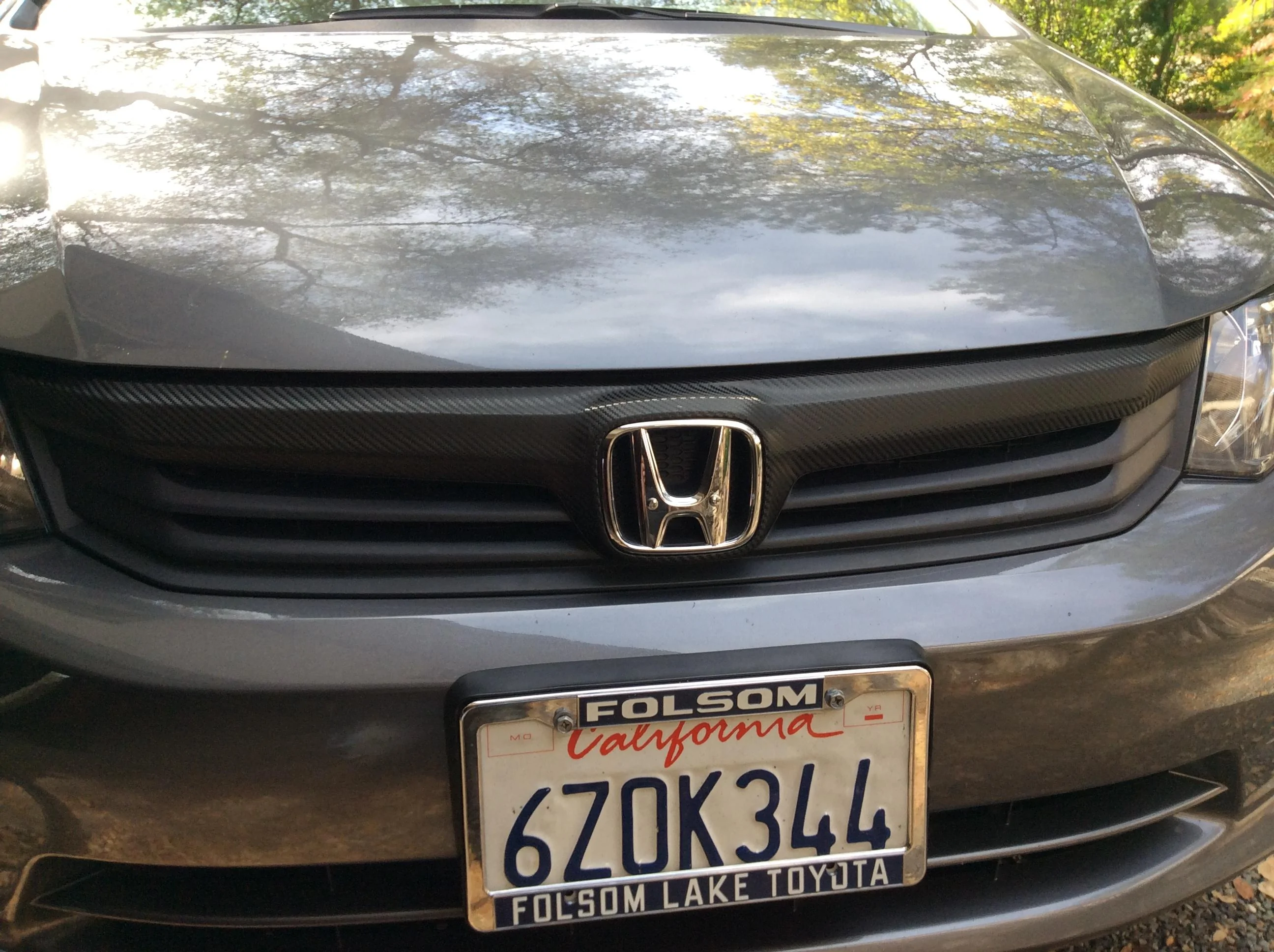

You may be onto something with the wrap. I did carbon fiber on a Honda grill and it turned out great. I didn’t like the chrome.
