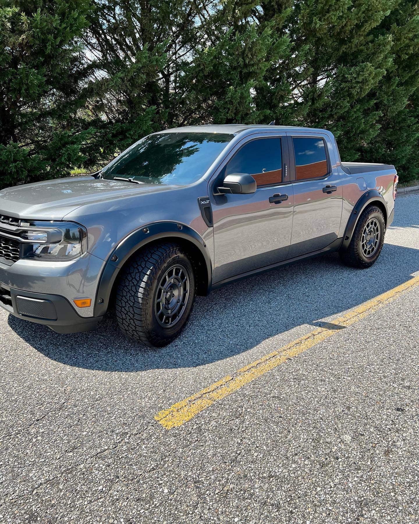

Looks great did, what size tires you put and did you use original rims?
Wheel and tire specs
Fifteen 52 Metrix 17x8 +38
Fallen Wildpeak 245/70

Never been a fan of Bushwacker flares but I’m diggin them on the Maverick
Yours is the first that I've liked the look of the fender flares on. They work REALLY well with those tires and rims. Do you have a lift on your truck? What kind of tires are those? Are they offset?

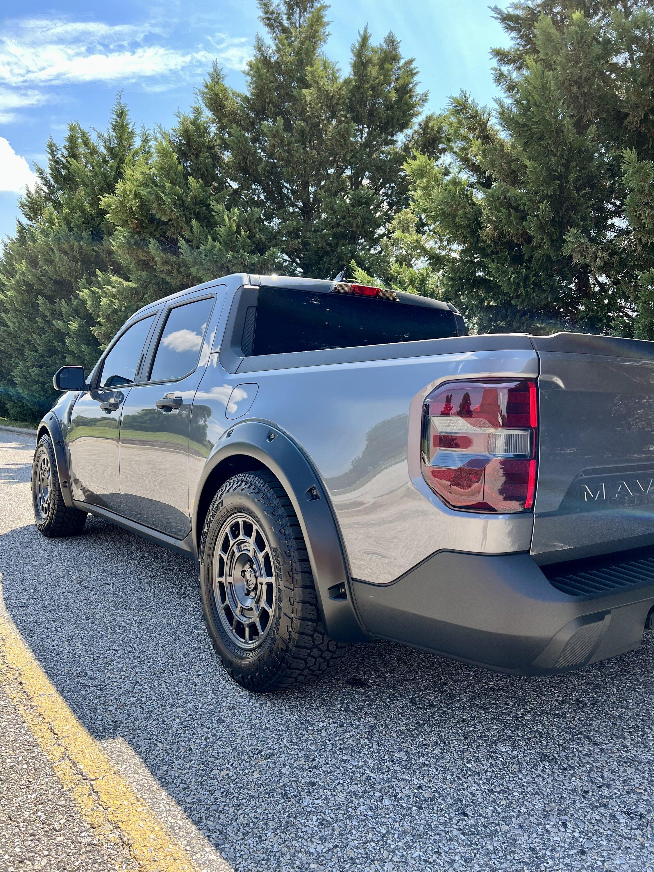

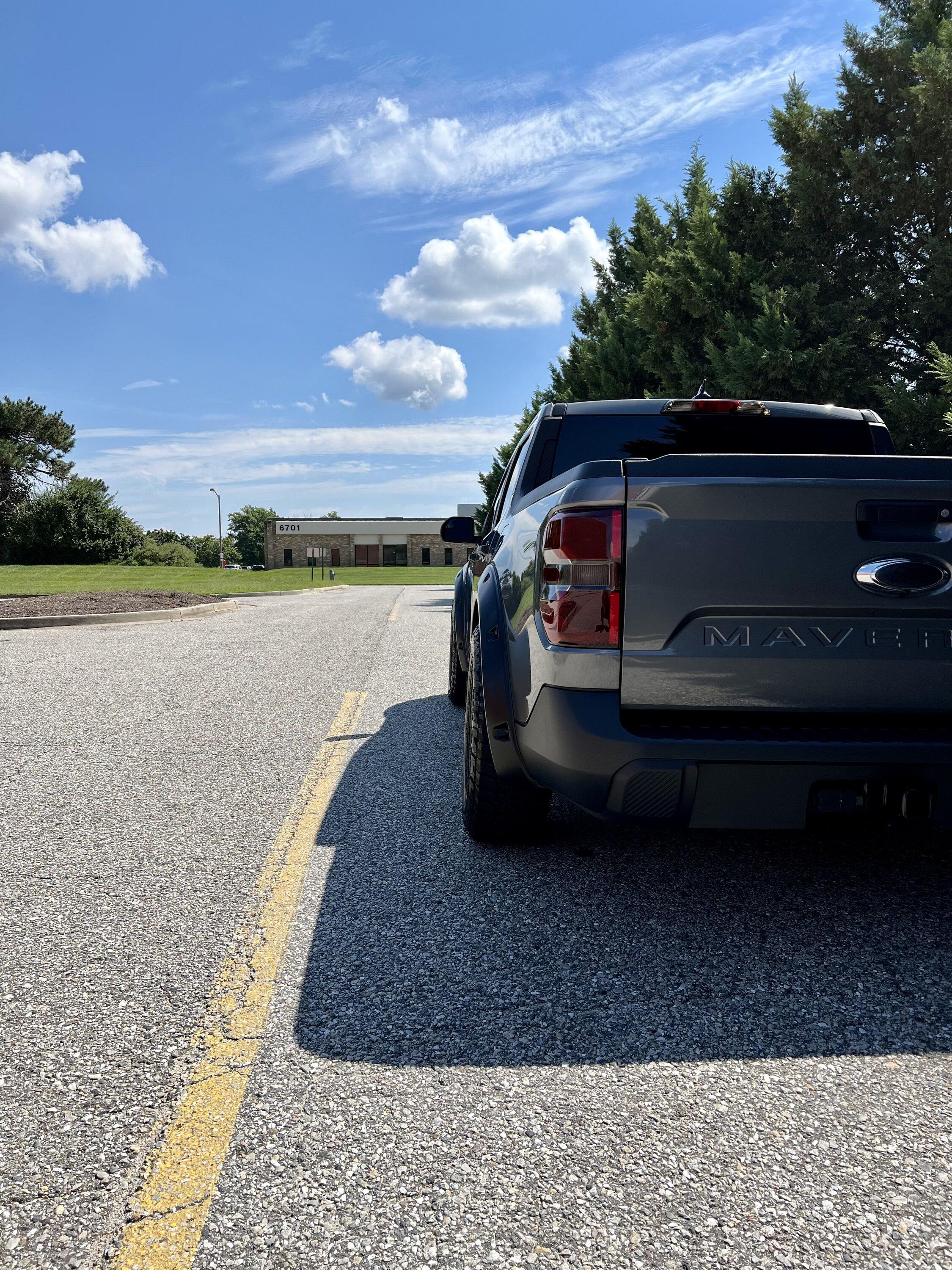

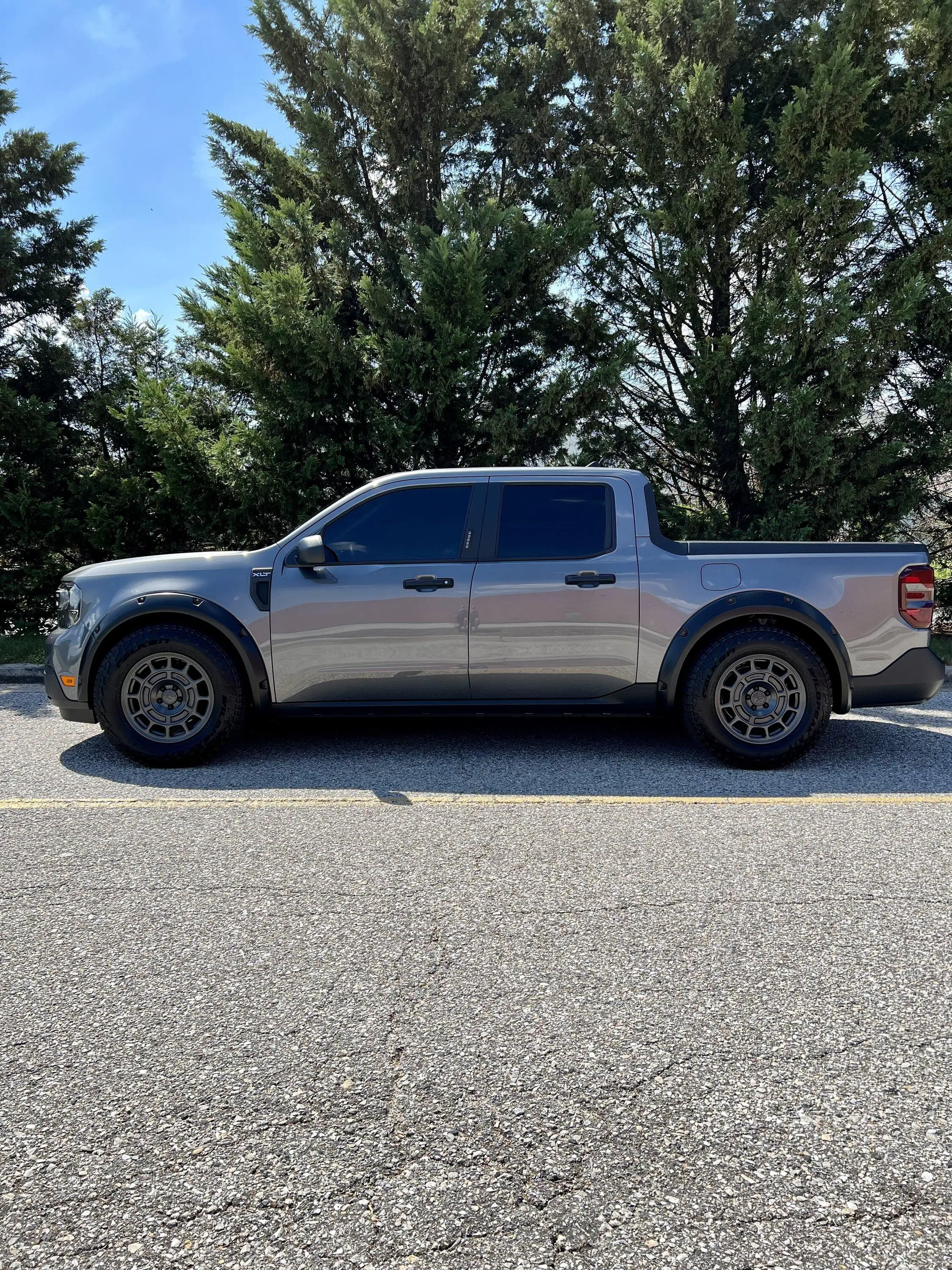

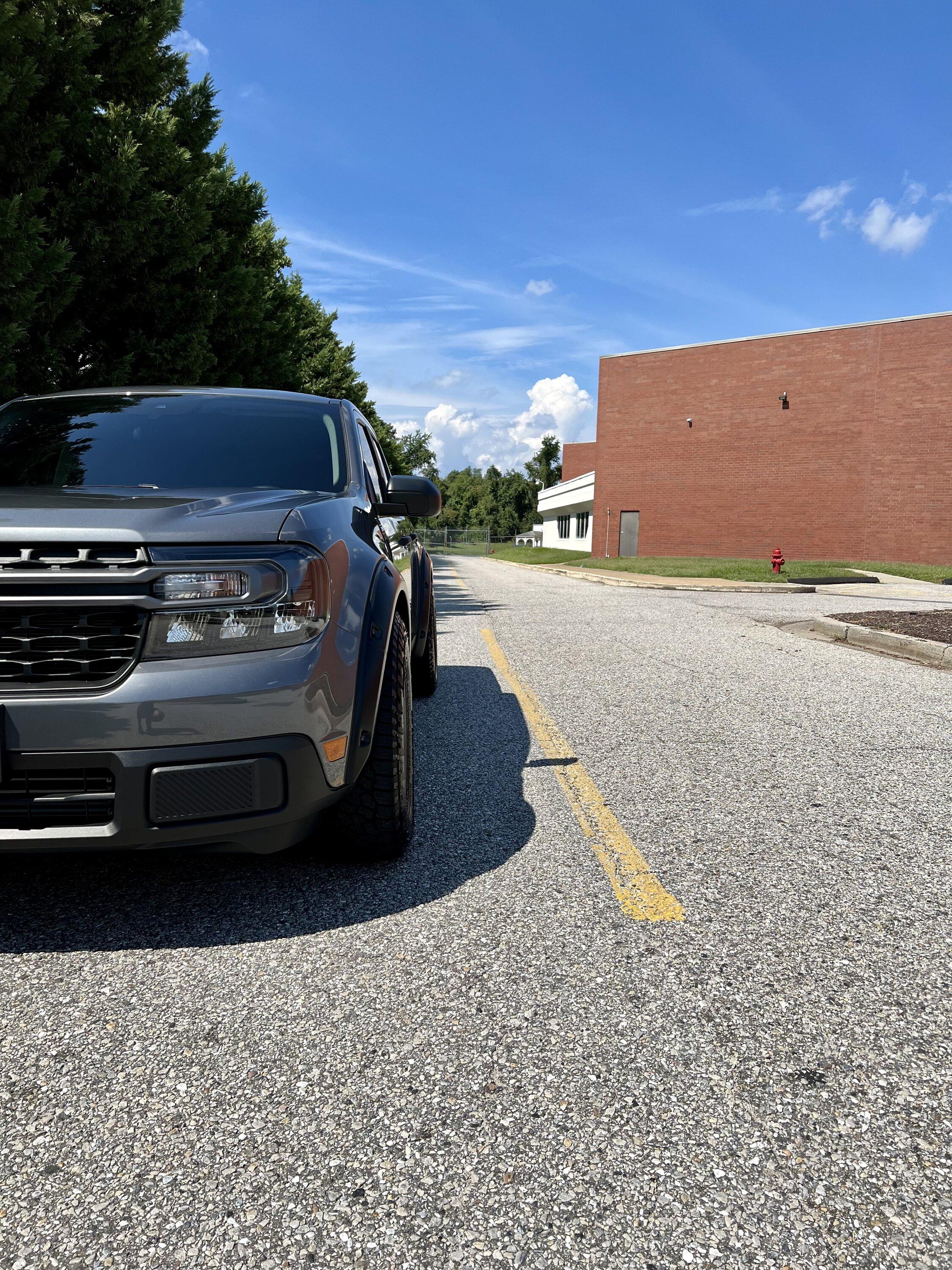

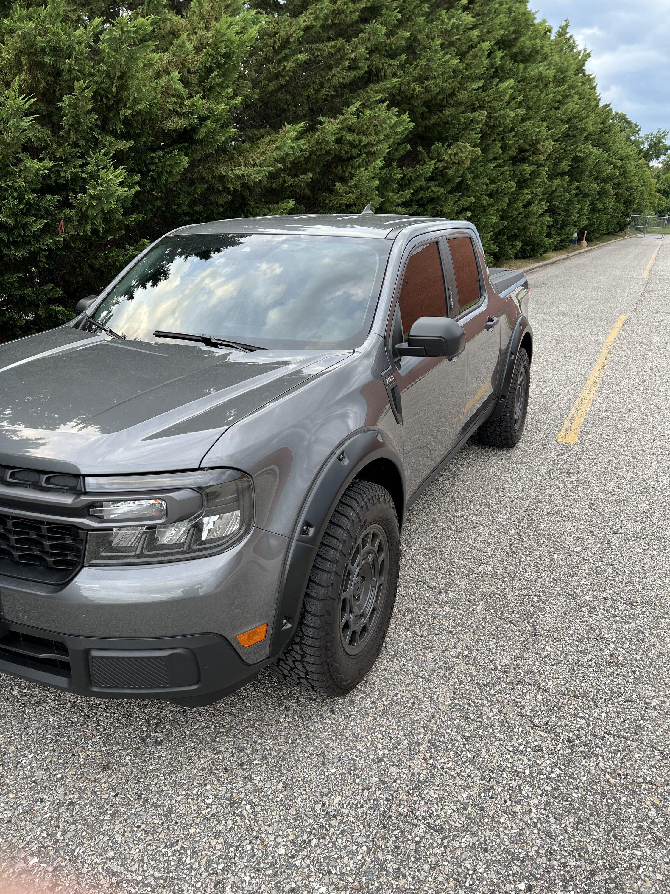

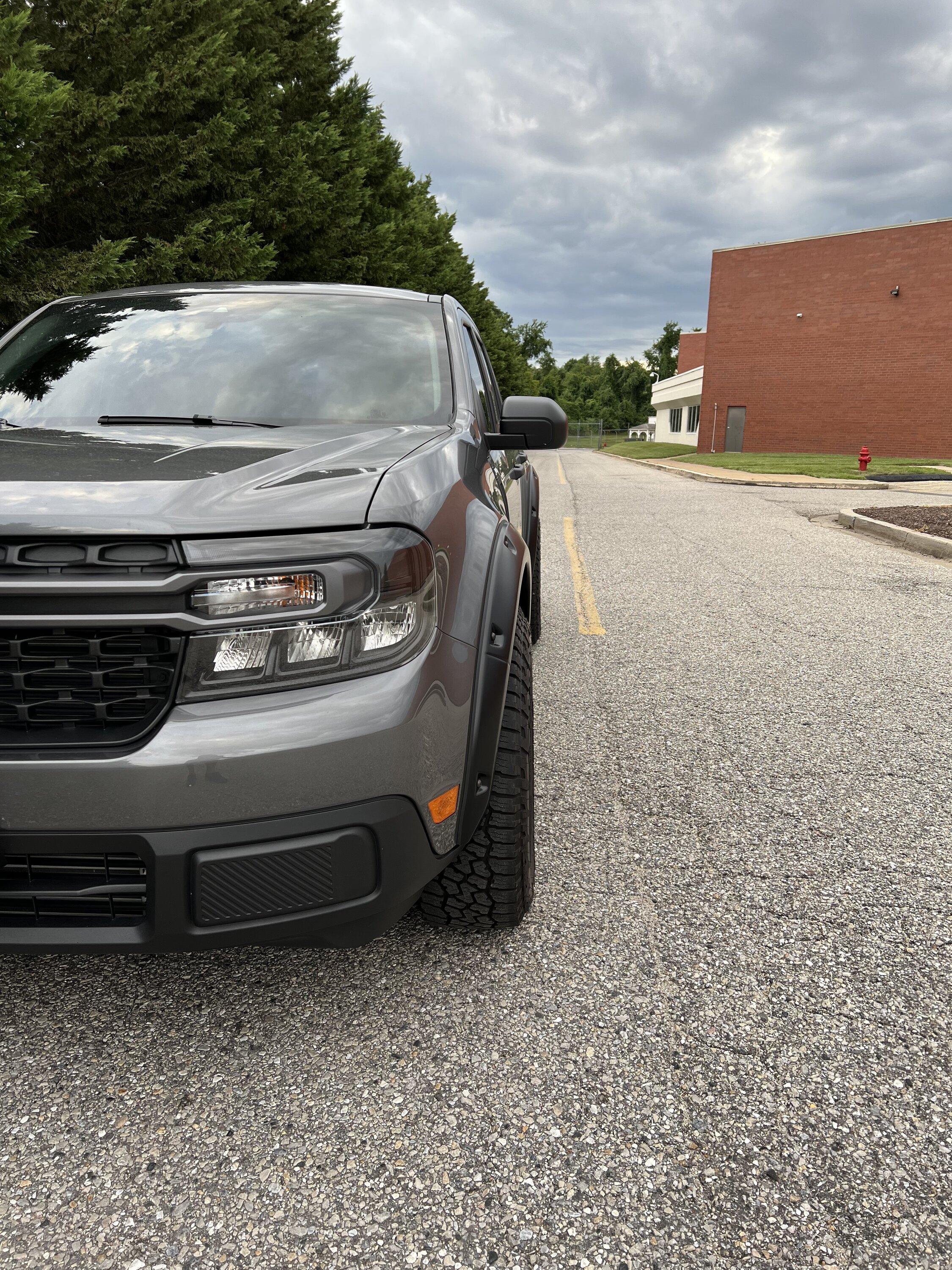

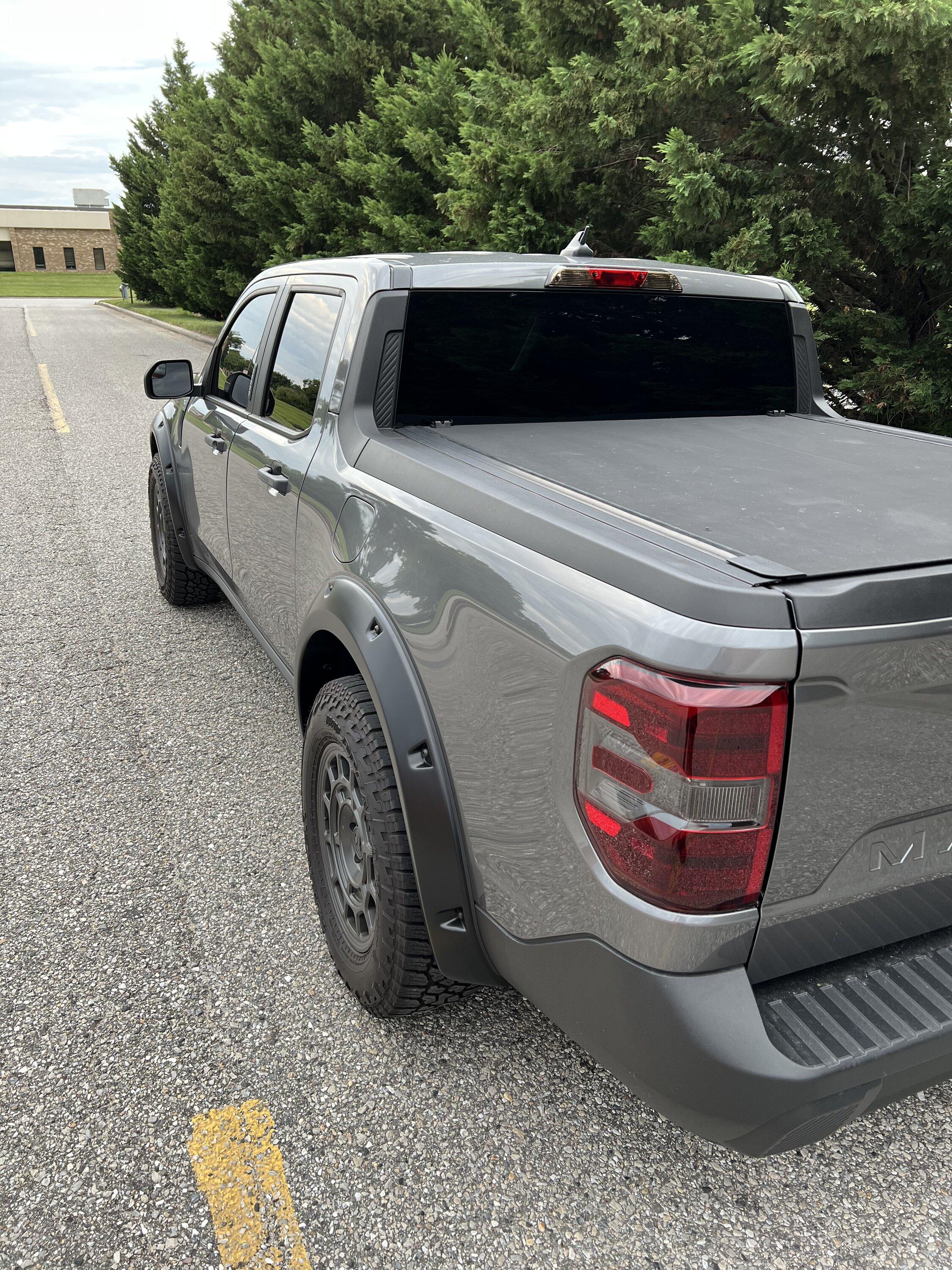

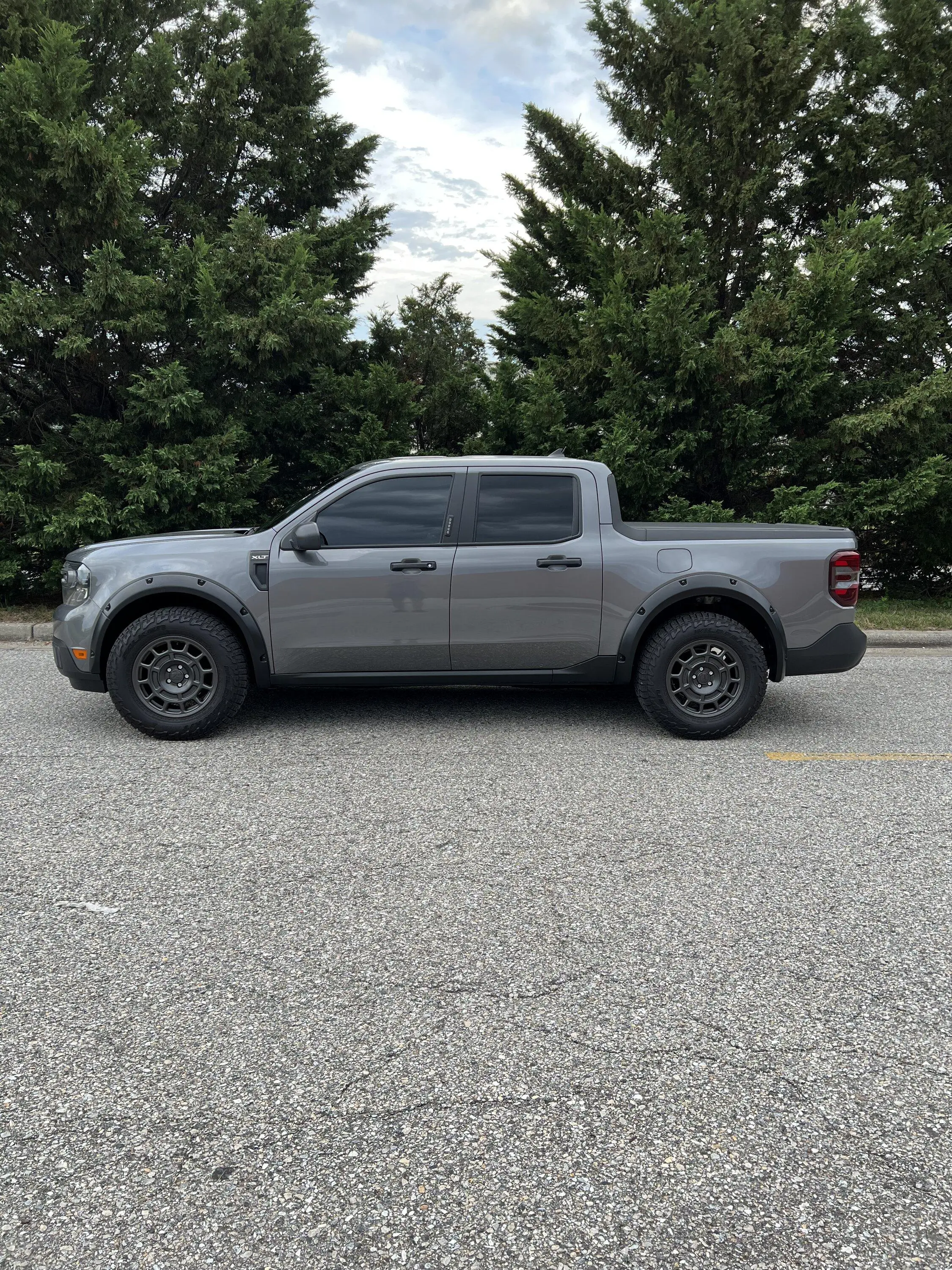

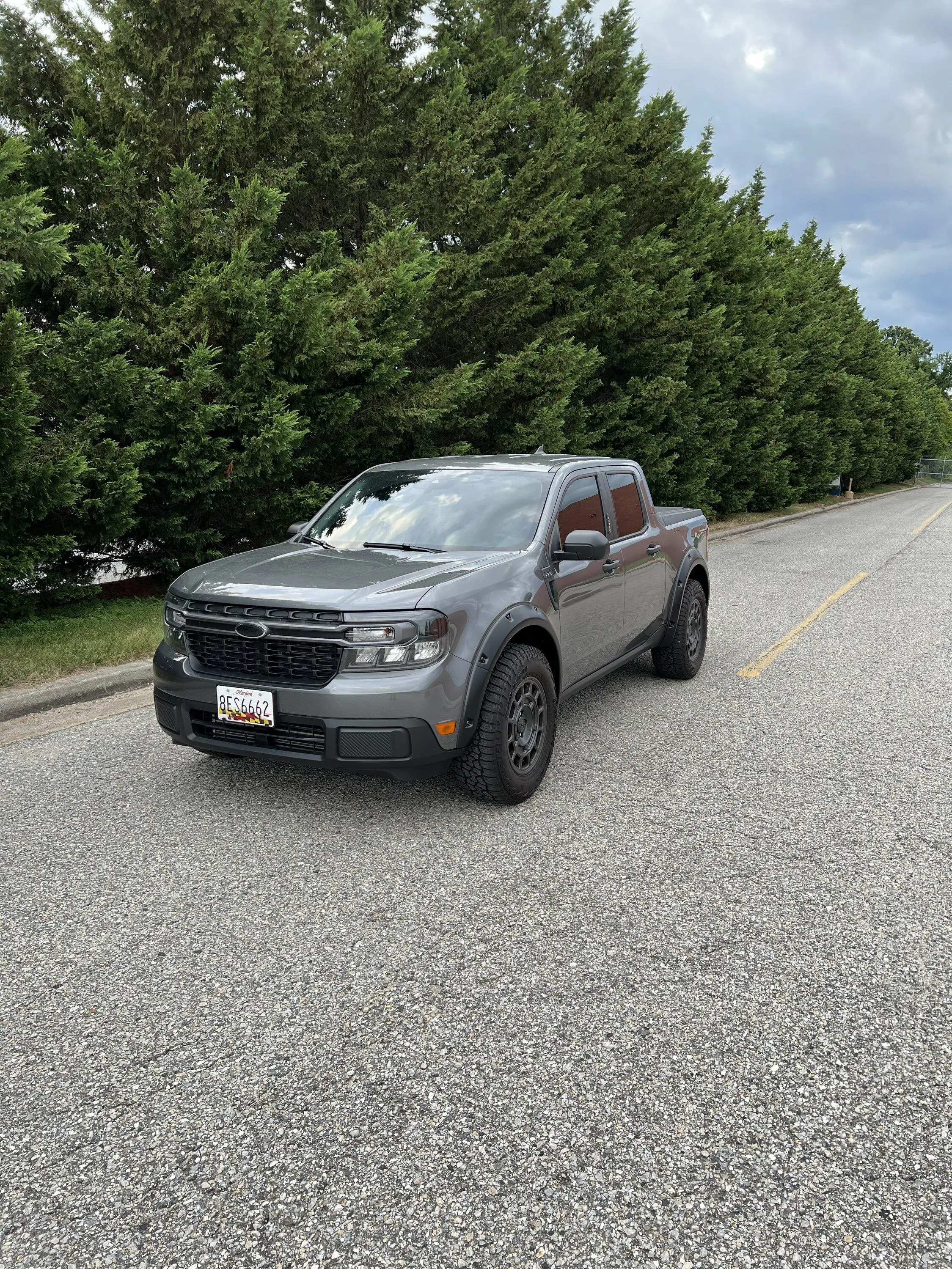

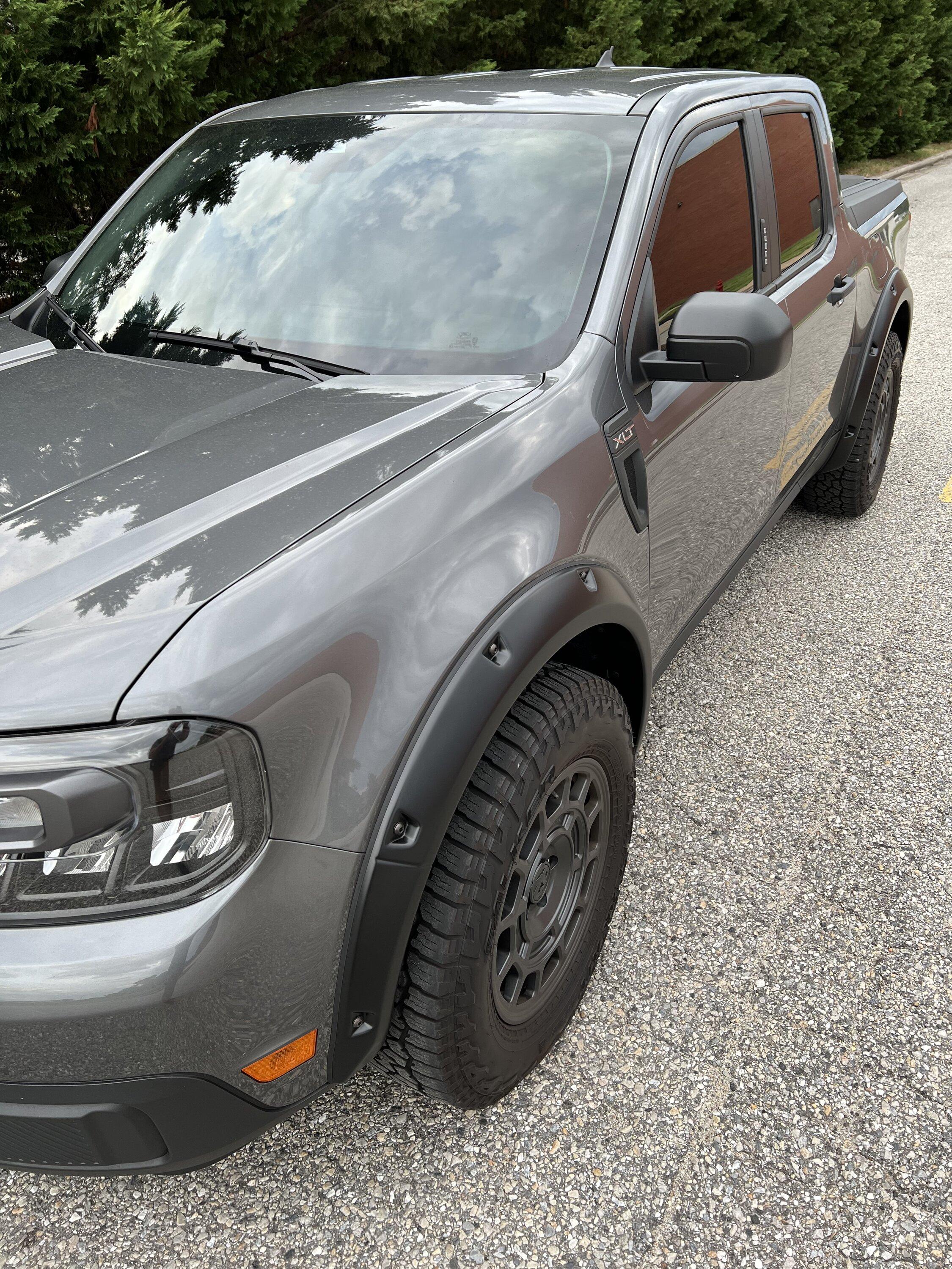

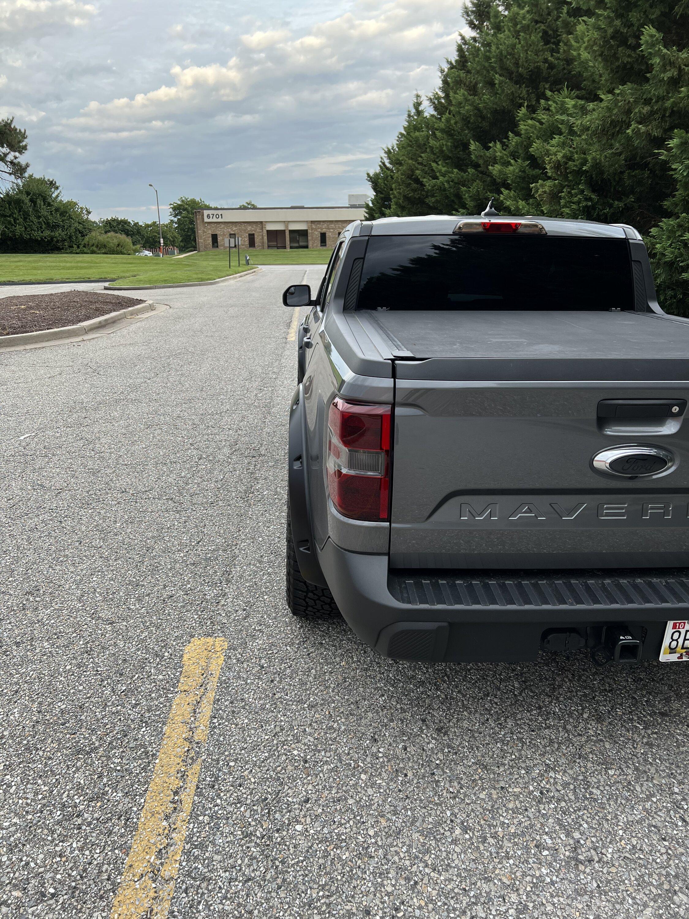

its lowered now (not a fan of a lifted Maverick)
here's my setup
Spacers 1.5” front / 2” rear
Steeda lowering spring (for Escape)
Ford Maverick Gave it some hips ( Bushwacker flares ) mav5
Ford Maverick Gave it some hips ( Bushwacker flares ) mav4
Ford Maverick Gave it some hips ( Bushwacker flares ) mav3
Ford Maverick Gave it some hips ( Bushwacker flares ) mav2
Ford Maverick Gave it some hips ( Bushwacker flares ) mav1

I'm not a fan of that type of add on but you are right... they look great on your Maverick!

It must be the spacers. How much are spacers? Do spacers affect anything other than looks?

spacers were around $200
only negative affect is the tire rub with them, but with the lower and wider stance the truck handles amazing.

Where is the tire rub happening and is it during regular driving or just lock to lock turning

on pinch weld only while turning. i flatten the pinch a bit but need to do more.

🤔 I wouldn't want that if the tires rub. Do you think they would run if it weren't lowered? Are you running larger than stock tires?

running 245/70 tires (larger then stock) i think it rubs less after lowered.
