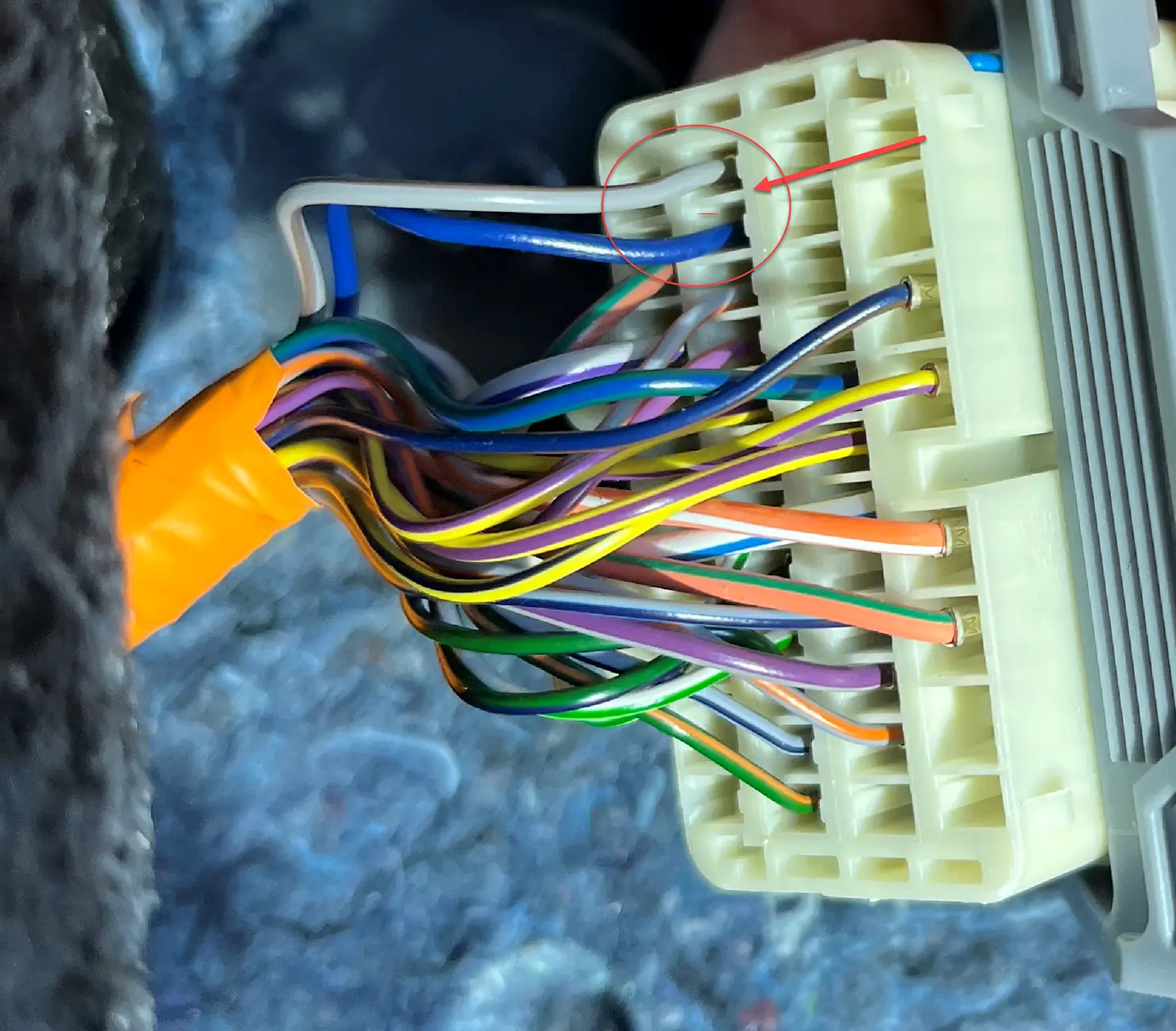

I was looking at connectors for different reason than speakers.
Looking at the audio wiring diagram, looks like Front Right goes thru C207 the connector on RH Kick panel. It's the RH one of the 2 on that bracket.
C207
Ford Maverick Front kick panel / speaker wires. 1772133261015-4a

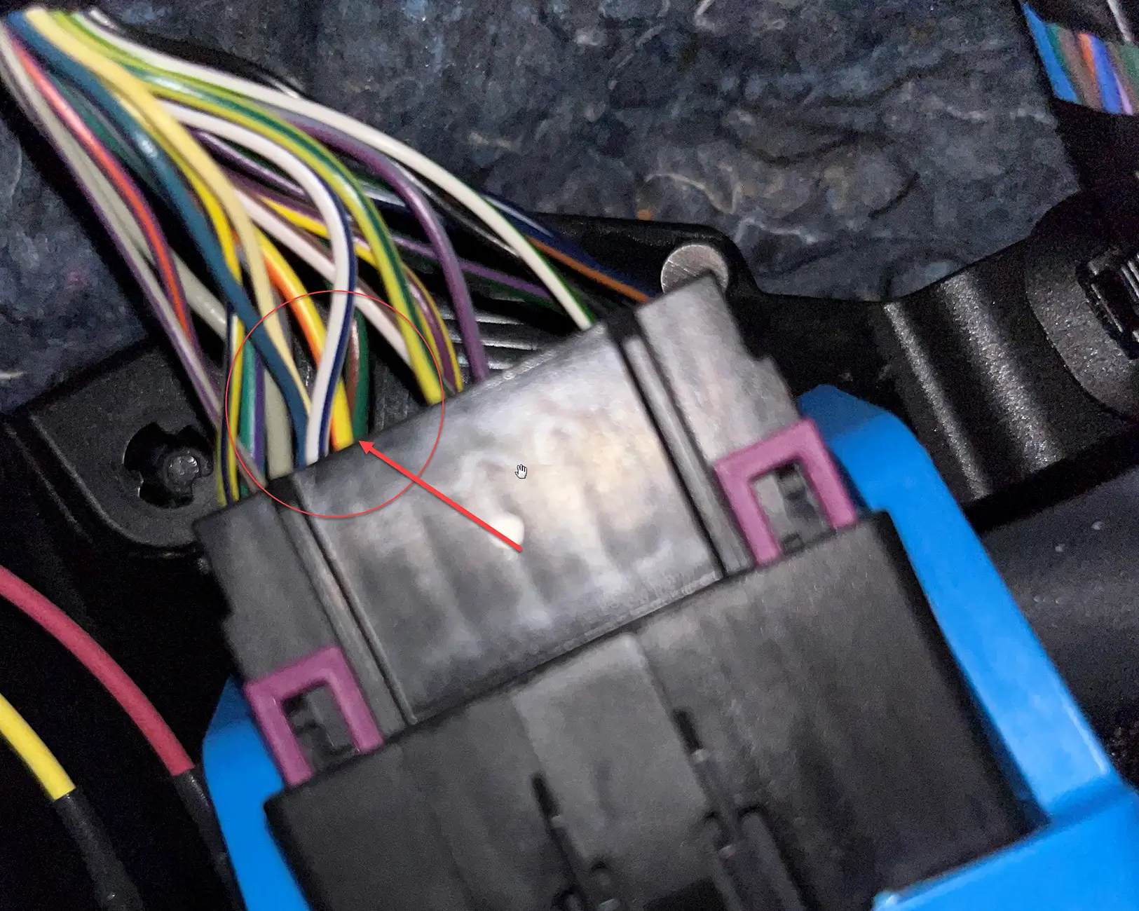

Front Left looks like it's on C201 the lower one under the dead pedal.
Ford Maverick Front kick panel / speaker wires. 1772133315907-c0
C207
The photos definitely help.
Right front: + is yellow/orange - is green/brown
Left front: + is blue - is gray/brown
