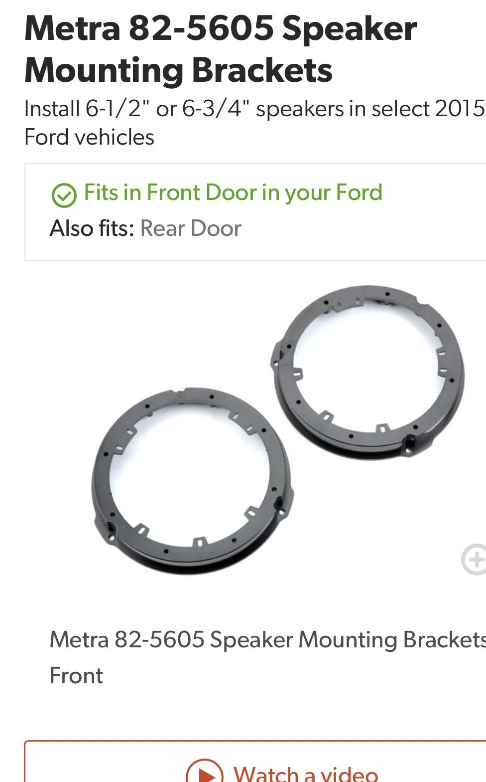

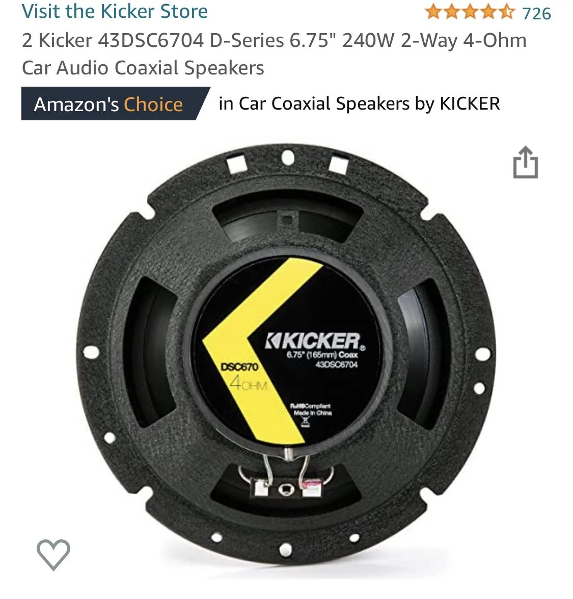

I’ve been following a YouTube tutorial on replacing front speakers. Unfortunately he skipped over the adjustments he made to the brackets Can someone tell me what needs to be done to these? Based on the links in the video description I think these are the correct brackets. I’ve also attached the speakers I purchased. Thanks!

I just used tile nippers to snap those tabs off (then I drilled a hole for the speaker wire to come through, because the wiring is on the outside of the adaptor)

Where did you drill the hole?

Why is it when I went to the Crutchfield site on this speaker bracket and clicked on 2022 Ford Maverick, it said it doesn't fit the Maverick?
