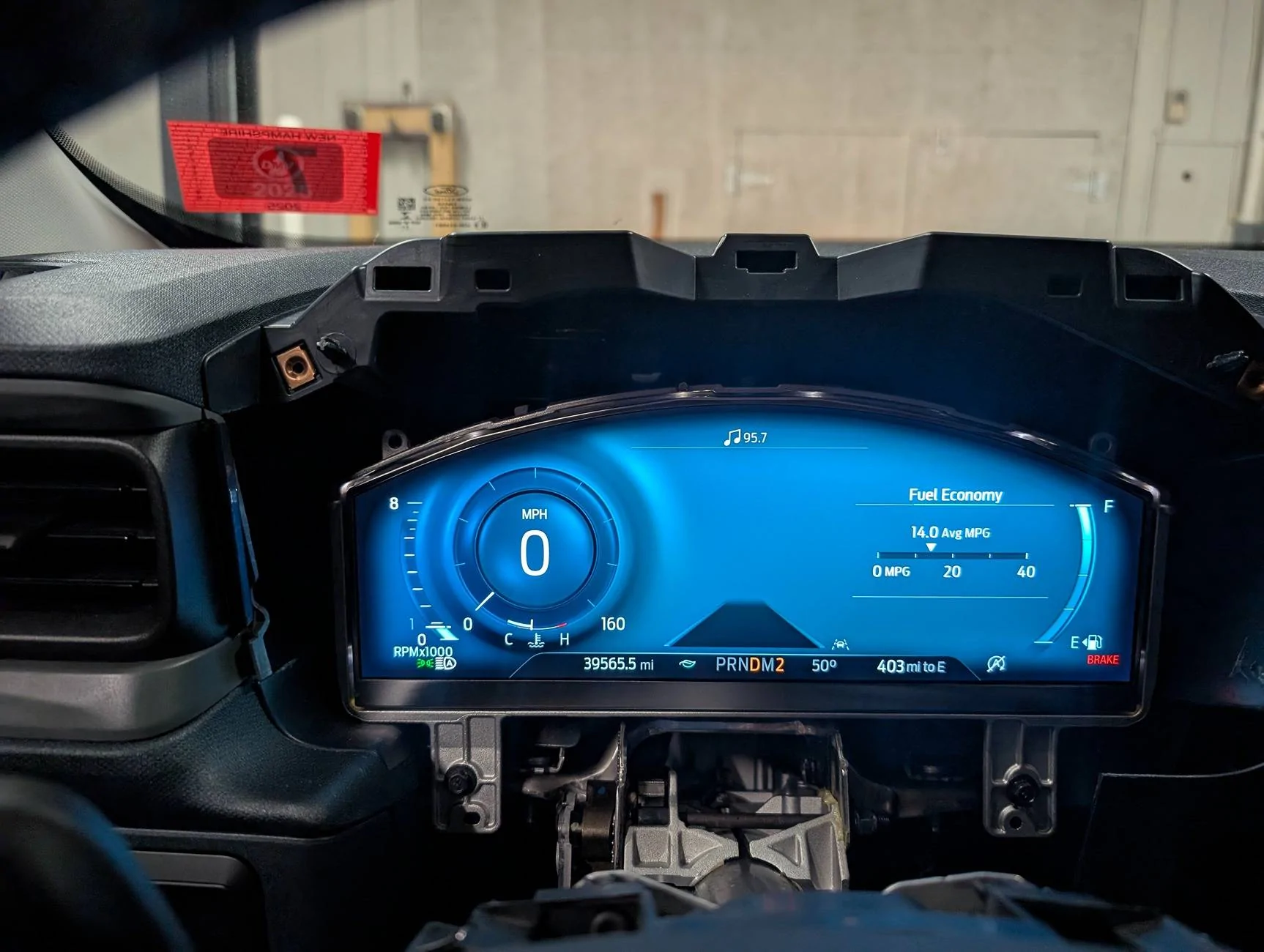

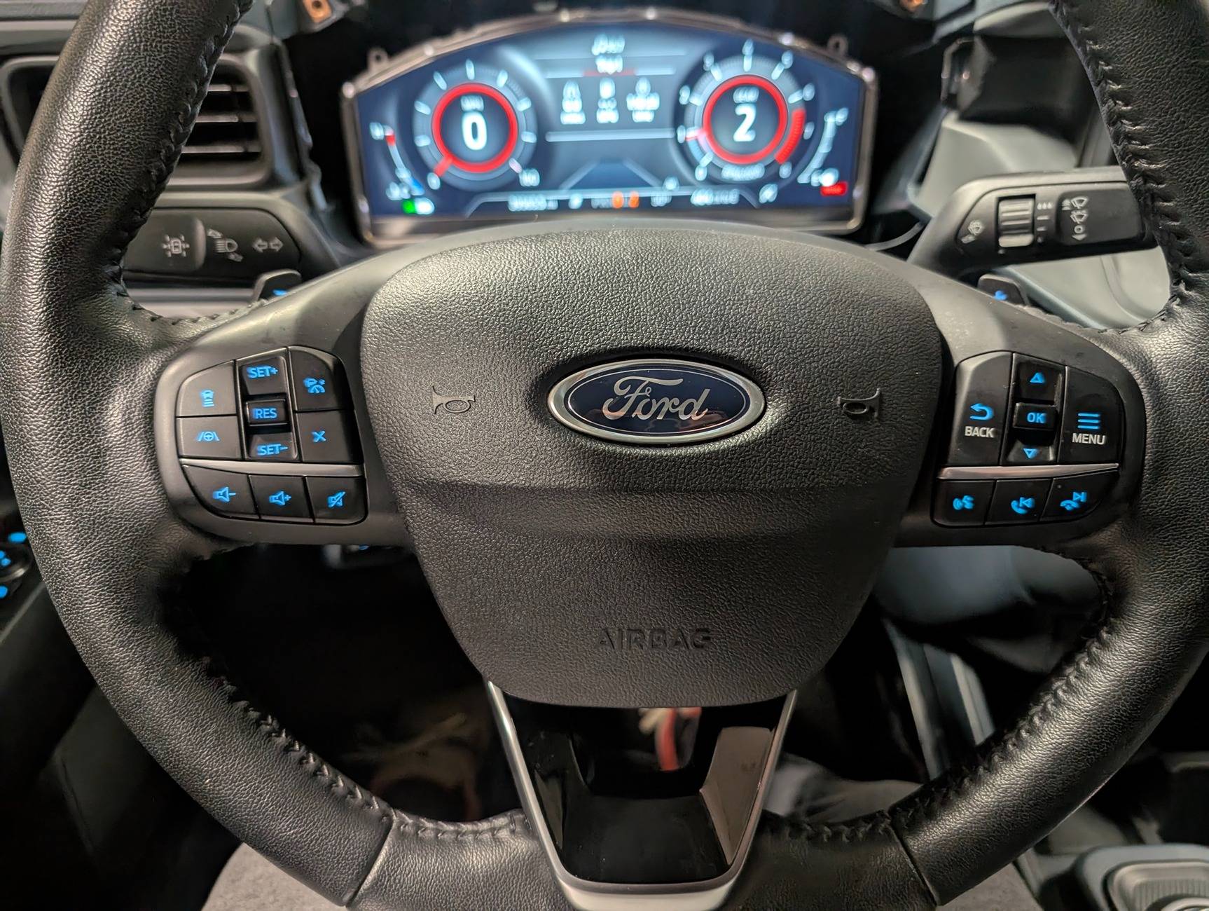

Escape steering wheel with cruise control, Lane. Keep assist, and adaptive Cruise (2020:
Ford Maverick FORscan issue with '22 EB AWD after cluster swap, others 1000017359

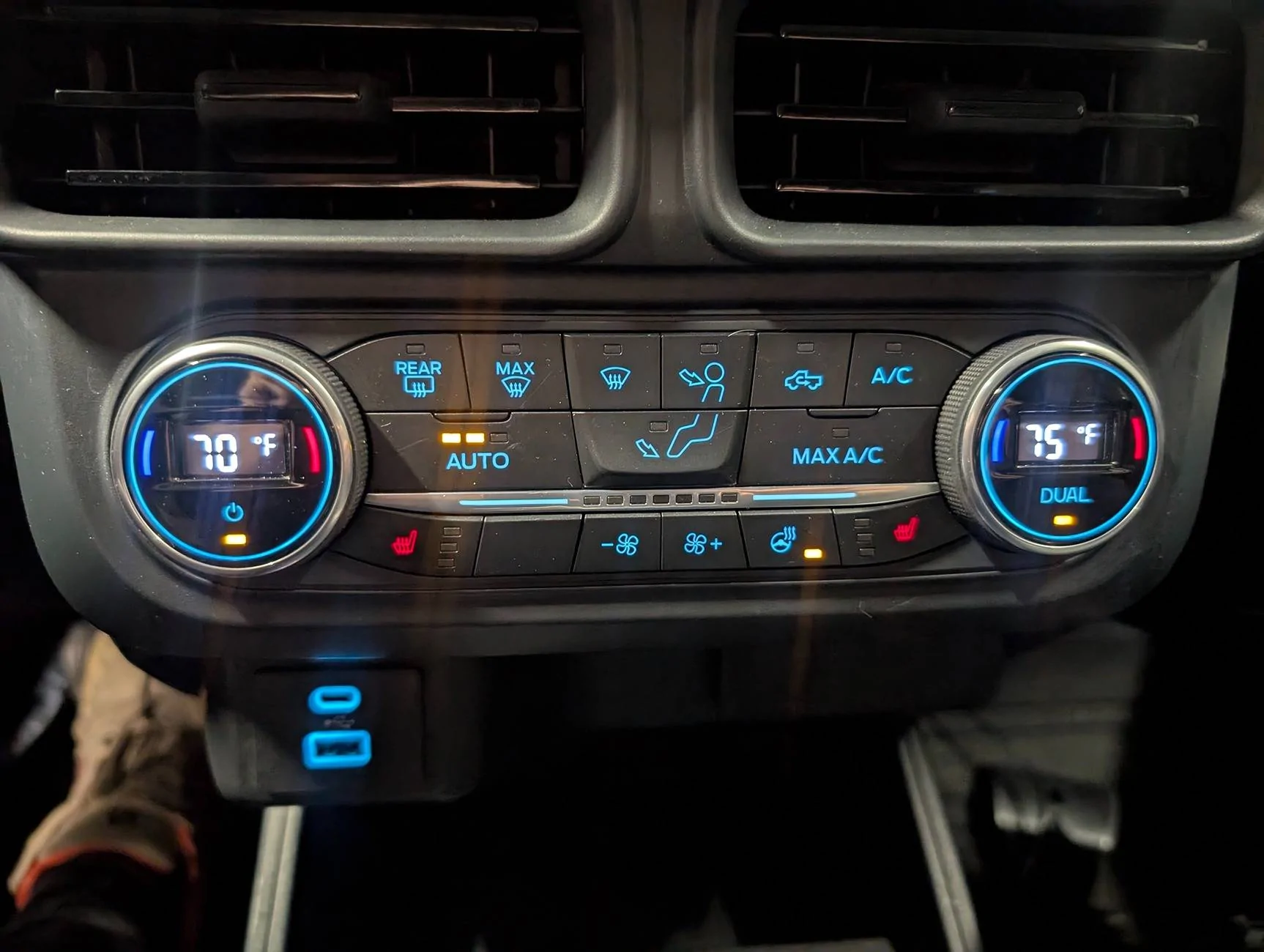

Escape dual zone HVAC controls with heated steering wheel button (2020)
Ford Maverick FORscan issue with '22 EB AWD after cluster swap, others 1000017360

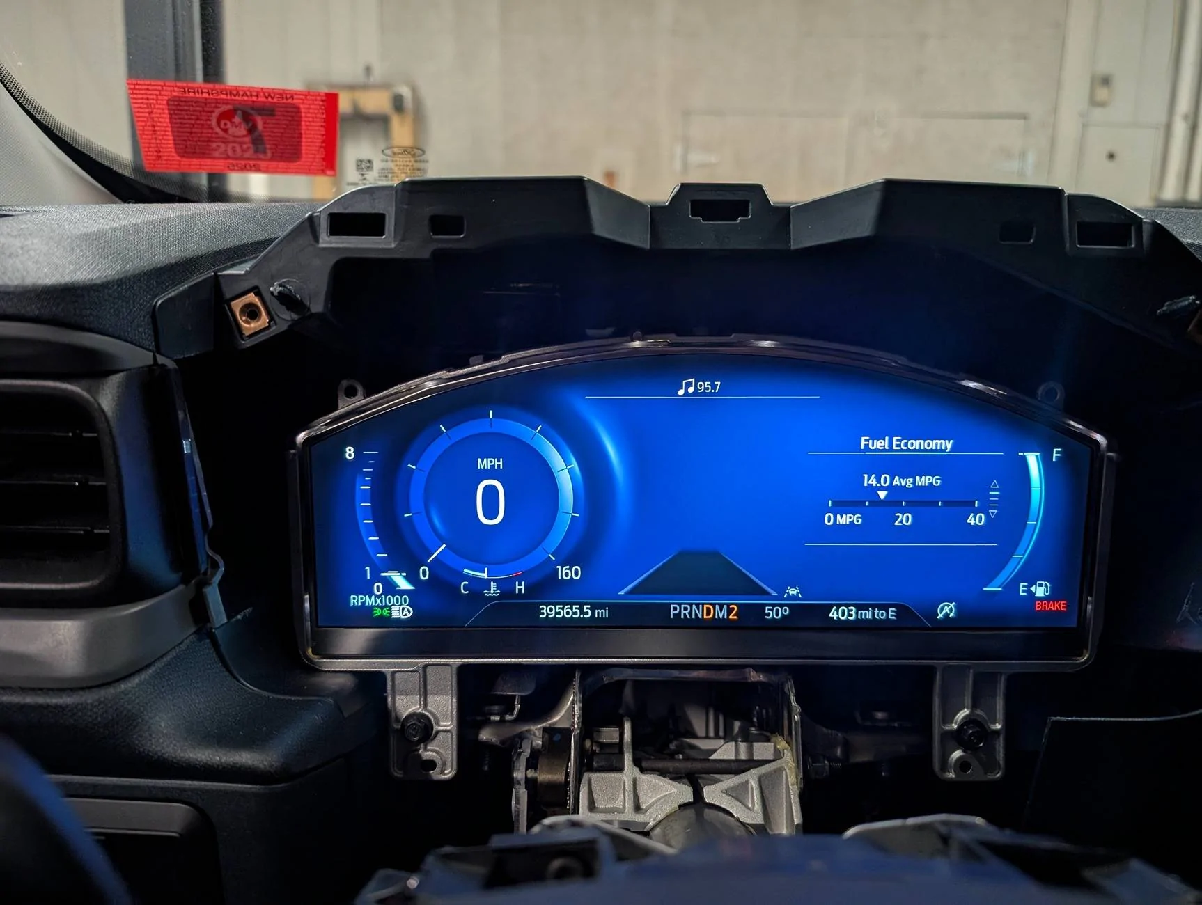

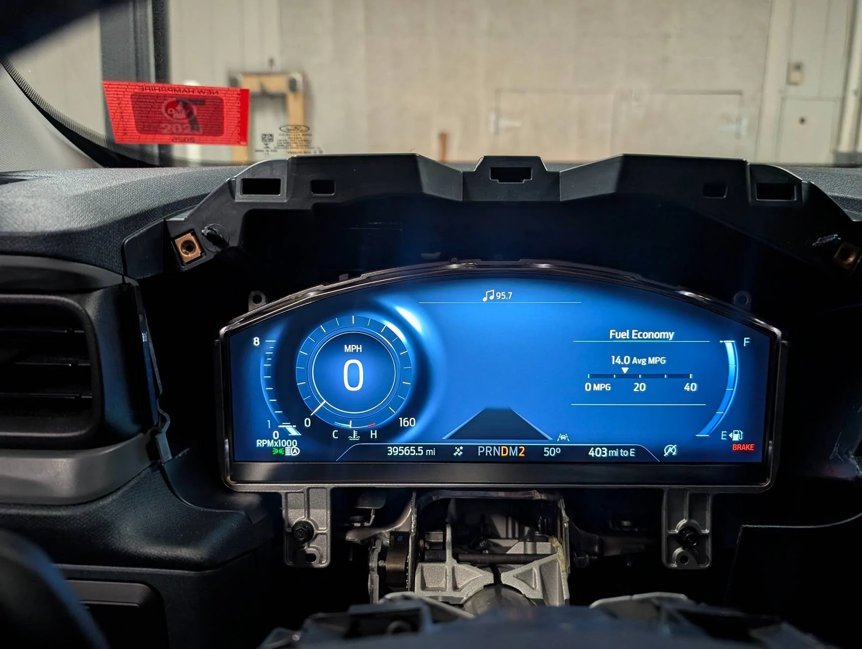

Explorer ST digital cluster (2022):

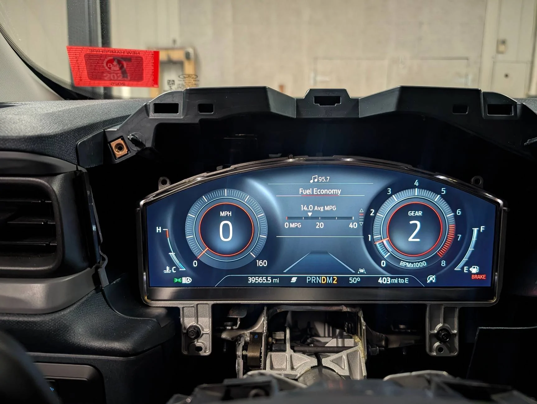

Normal mode
Ford Maverick FORscan issue with '22 EB AWD after cluster swap, others 1000017362

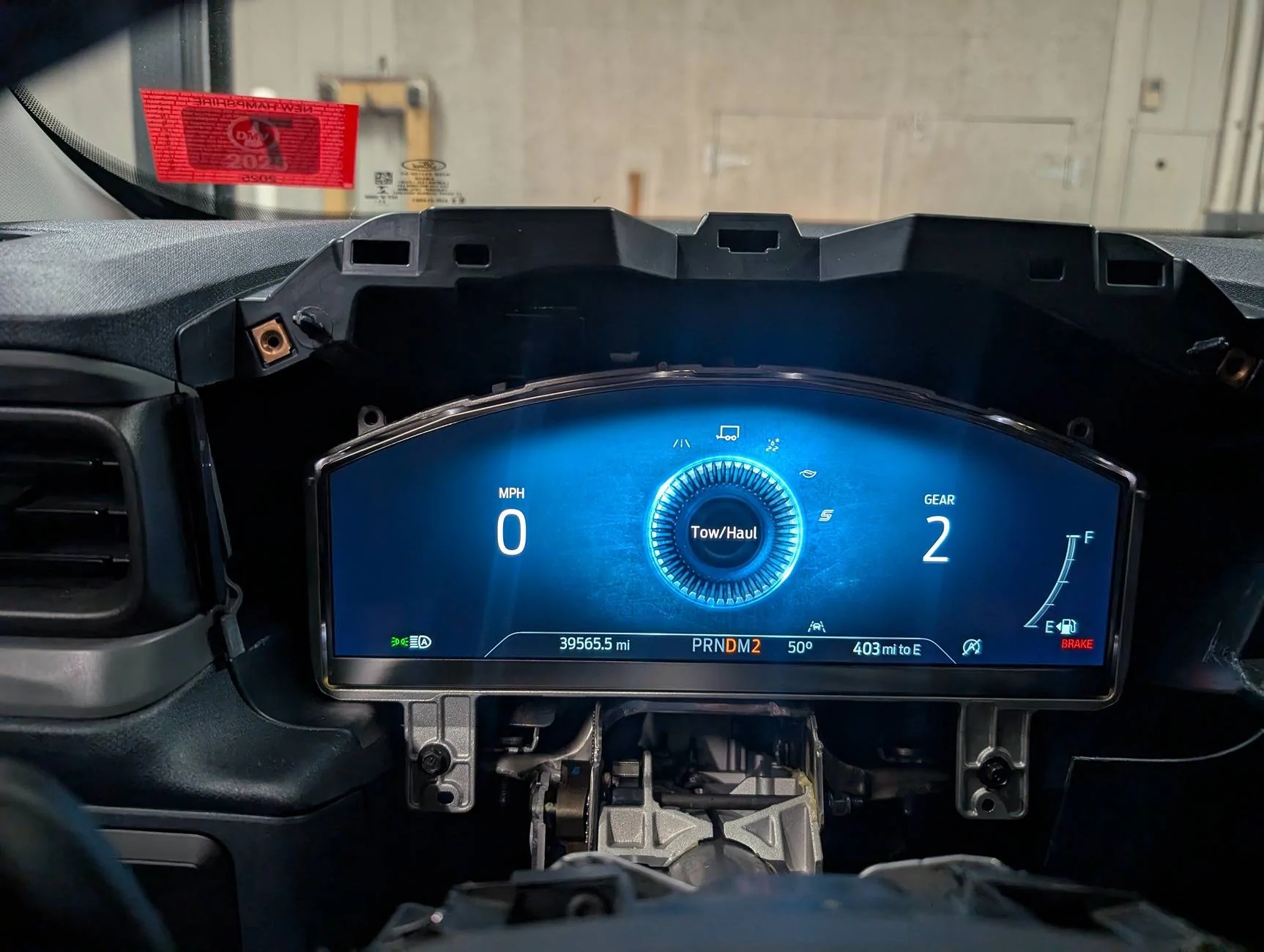

Tow/haul mode
Ford Maverick FORscan issue with '22 EB AWD after cluster swap, others 1000017363
Ford Maverick FORscan issue with '22 EB AWD after cluster swap, others 1000017364

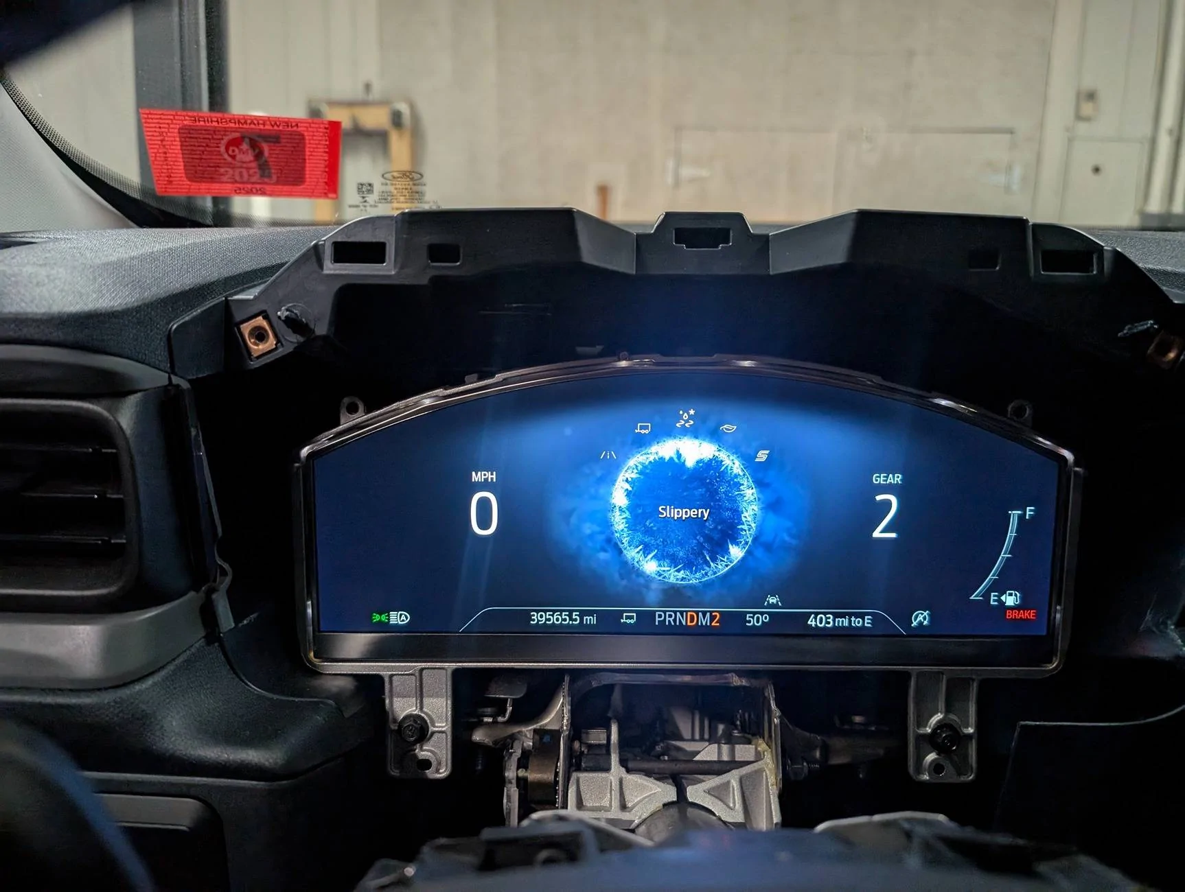

Slippery mode
Ford Maverick FORscan issue with '22 EB AWD after cluster swap, others 1000017365
Ford Maverick FORscan issue with '22 EB AWD after cluster swap, others 1000017366

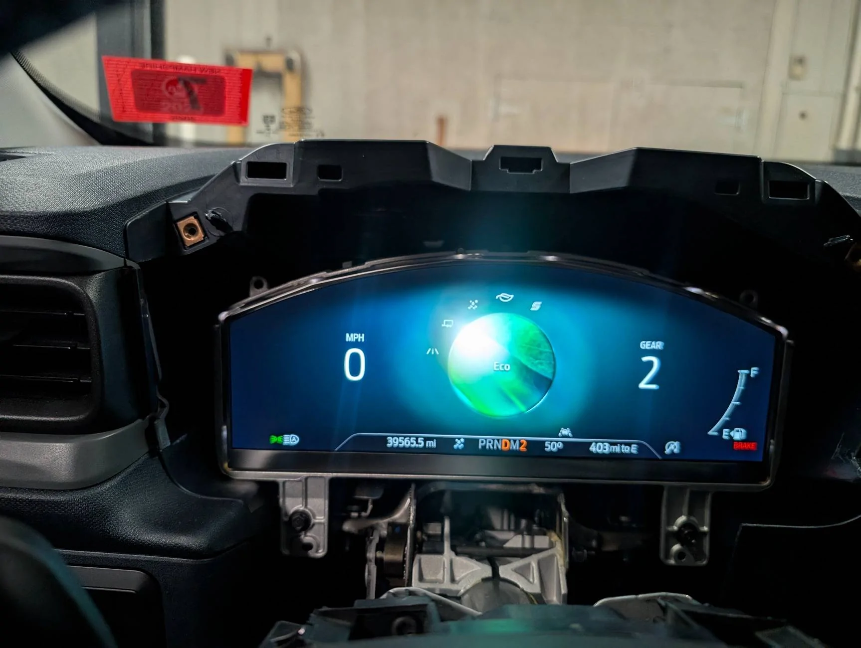

Eco mode
Ford Maverick FORscan issue with '22 EB AWD after cluster swap, others 1000017367
Ford Maverick FORscan issue with '22 EB AWD after cluster swap, others 1000017368

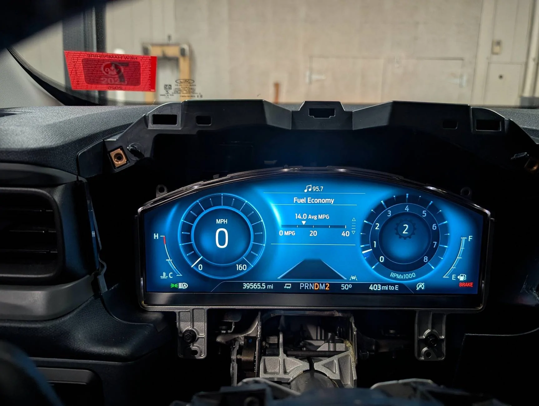

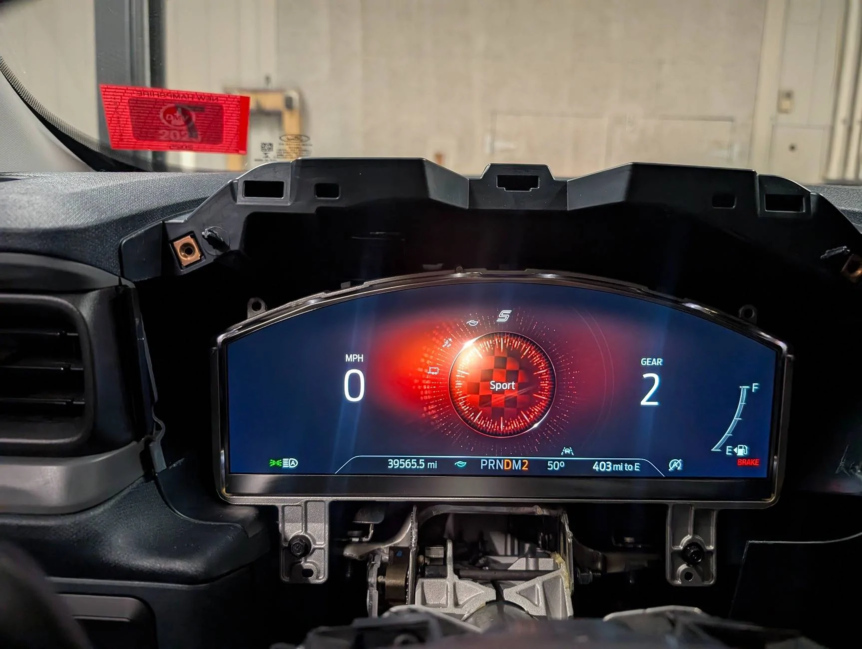

Sport mode
Ford Maverick FORscan issue with '22 EB AWD after cluster swap, others 1000017369
Ford Maverick FORscan issue with '22 EB AWD after cluster swap, others 1000017370
