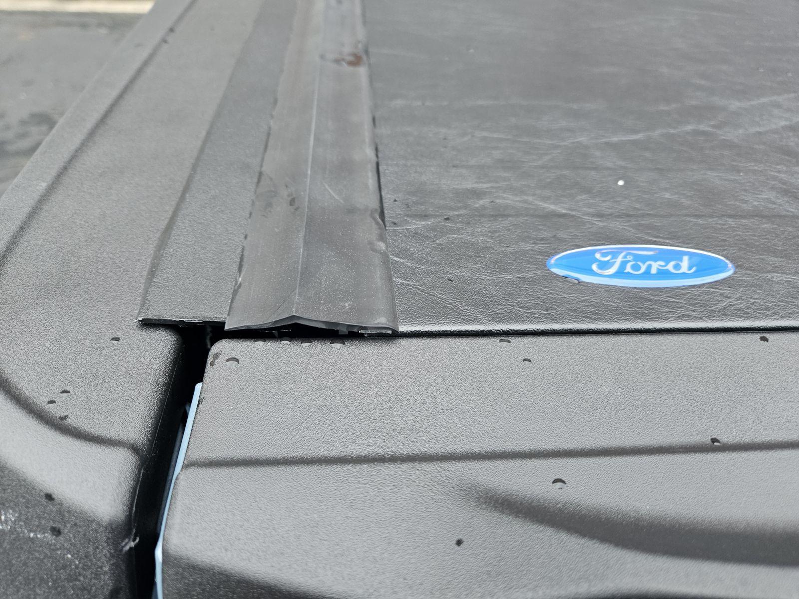

I'll search for Lonesome Gloves video. My main issue is the 1/4" gap at the tailgate, love the cover otherwise.
When you say "met the bed" are you talking about the front, rear or?
If you loosen the bolts and pull it towards the tailgate and have someone tighten them, you should be good to go. Unless it's defective and made too short.

Sorry met the tailgate.

One last question before attempting to move the cover rearward. I have 2 concerns. 1 is that the rubber seal at the front of the bed is perfectly in line right now & may lose it's seal. The other is that the roll up rubber may be too tight against the tailgate after moving rearward.
Any thoughts would be appreciated!

The seal at the window should have been installed as close to the bed as possible, not up against the glass. I closed the tailgate before tightening the bolts to check that they touched. This is my first rodeo with one of these and it turned out ok. Not sure dealer install would have been better. Maybe have the dealer take a look for they're opinion. Good luck.

Thanks again!
Been to the dealer, not much help.
I did loosen clamps & move it back 1/2" & am happy with it so far, just wish the rubber seals on top were not cut short😒
