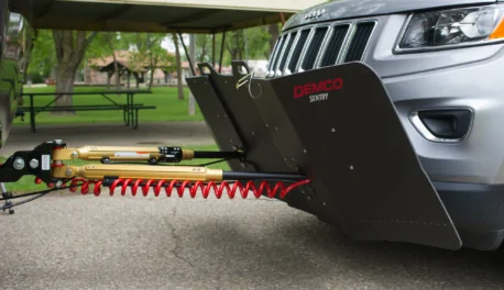

I also added a deflector to my DEMCO setup to keep road debris damage to a minimum. Tried it once and it seemed kind of flimsy, which is why I will be reinforcing it with Aluminum stiffening struts before the next trip. Below pic is generic; not my setup.
Ford Maverick Flat towing electrical connections 1784916395300-54
