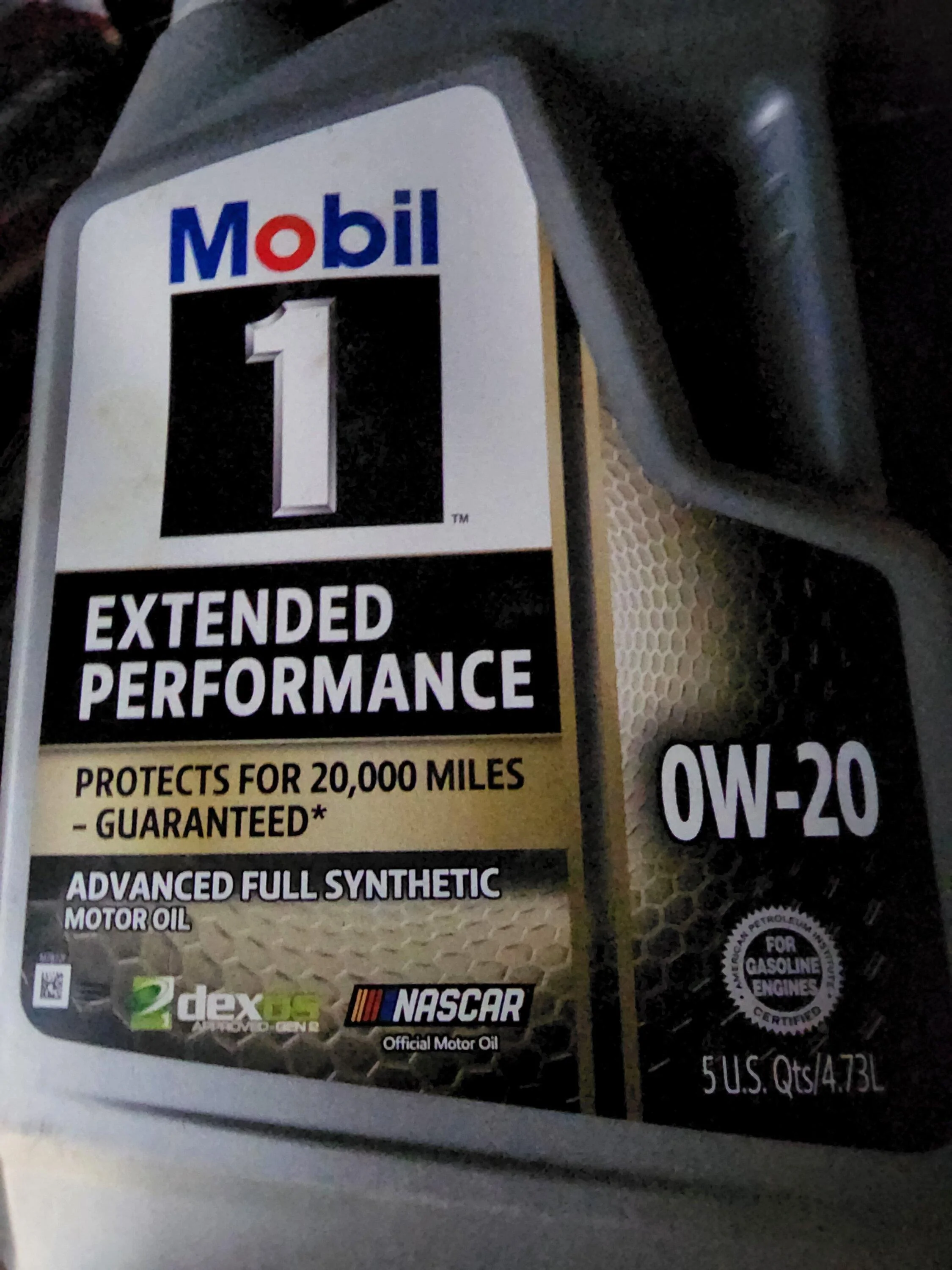

Espeer, PH= phosphorus
If you use the M1, try to get the EP M1, which is good for 20000m OCI. You can get it at most Wally worlds @$25 for 5qts.
The EP has a more robust additive package in it.
