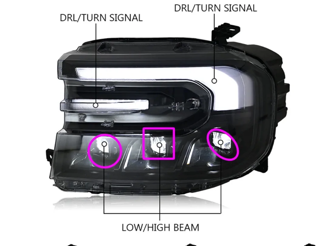

Damn that's so cool! I hope at some point you can do something for early model (2022) peps! The Shadow Unicorn could use some wicked looking "eyes" like that!
You can kind of make the reflective buckets glow, but it’s not as effective as if you were to use an aftermarket 22-24 headlight that has the 3 projector lenses in it. You could put much better demon eyes in those
I'm at point now that whatever I do has to be a plug-n-play setup. :ROFLMAO:
By “you” I meant, it’s possible 🤣 but what I mean is with headlights like these or the yet to be released form lighting ones, I could add demon eyes to make these lenses glow. Without the projector lenses which the stock headlight doesn’t have, the effect doesn’t really work well.
Oh I get you. Well I'm really more interested in the amber turn signal/drl setup like you have. Having "eyes" would just a bonus.
That can certainly be arranged much easier!
