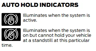

Left to right:
Drive Mode Selector
Traction Control On/Off
Brake Hold On/Off
You messing with us? LOL
Not exactly "brake hold" is the one by itself above the 3.

Ford Maverick Wondering What This Button Was On Lariat 1648400844368
Manual, page 198
