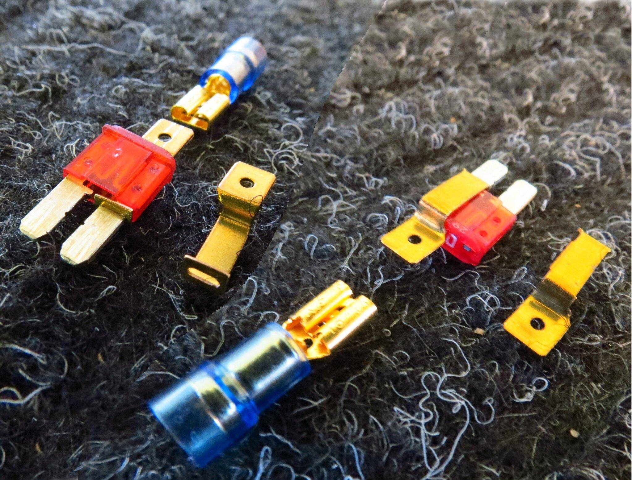

I went with fuse #6, but as that other thread mentions, a standard tap won't fit in that location.
For the fuse locations where there isn't room for a standard angle tap, I found these (the gold pieces in the photo):
Ford Maverick finally got everything i ordered to start my audio upgrade, have a few questions. fusetap-jpg-
It's a simple metal tab that slides over one of the fuse prongs that allows a spade connector to be attached. I bought these at a car show swap meet, but I think this might be it if a person wants to order some. They work great. You do need to then add a separate fuse inline on the new wire to protect whatever accessory you're powering. More pics & detail of connecting to fuse #6 can be found on page 6 of my build thread (link in my signature below).
Yeah, entirely too much exposed and energized metal for my taste. I much prefer these fabbed-up taps, although they are only sold in a pack of 10…
