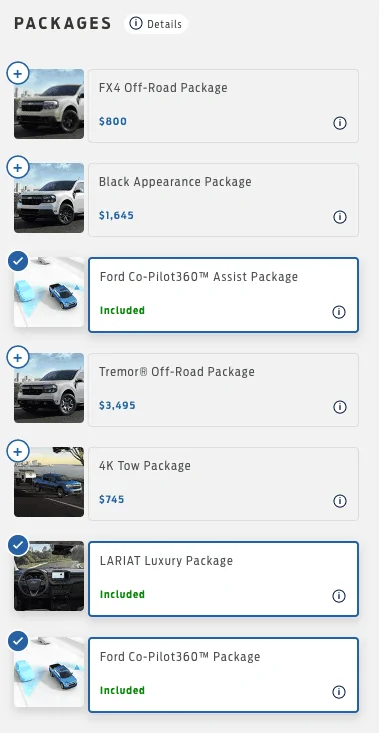

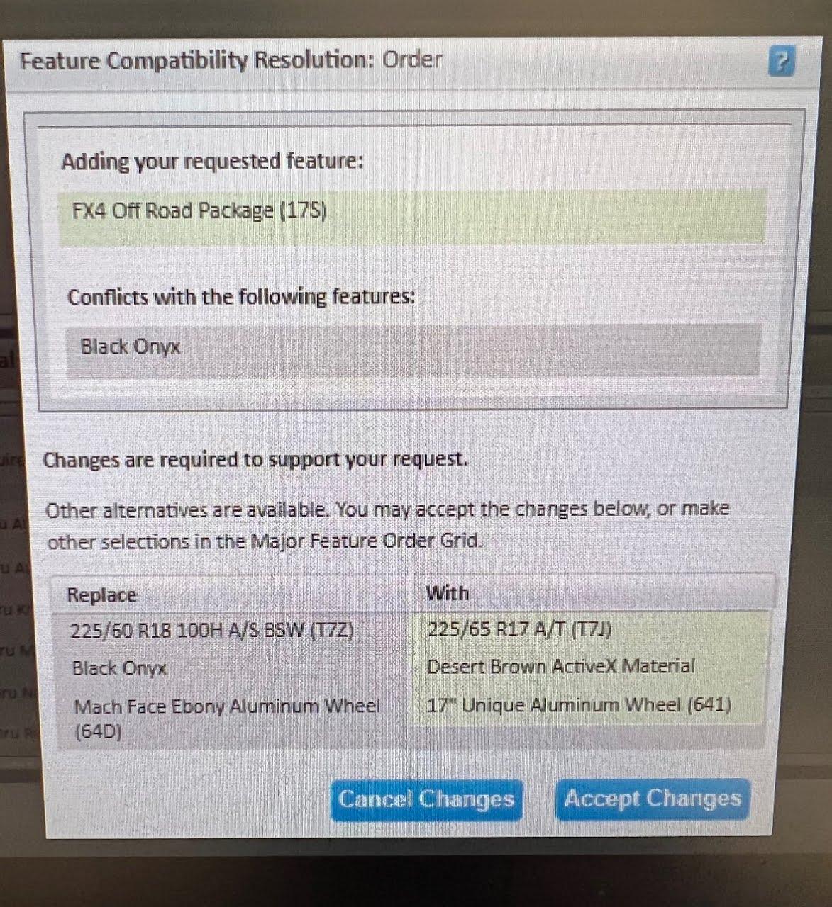

So dealer called today, said my request to add FX4 to my Black Package Lariat is a conflict, gave me the photo below and told me to pick:
question for the class: what does the fx4 offer that I'd be losing out - BAP is pretty crucial for me but since the truck already has the 4kTow and Lariat tech features, idk what all the FX4 would really add besides two hooks??

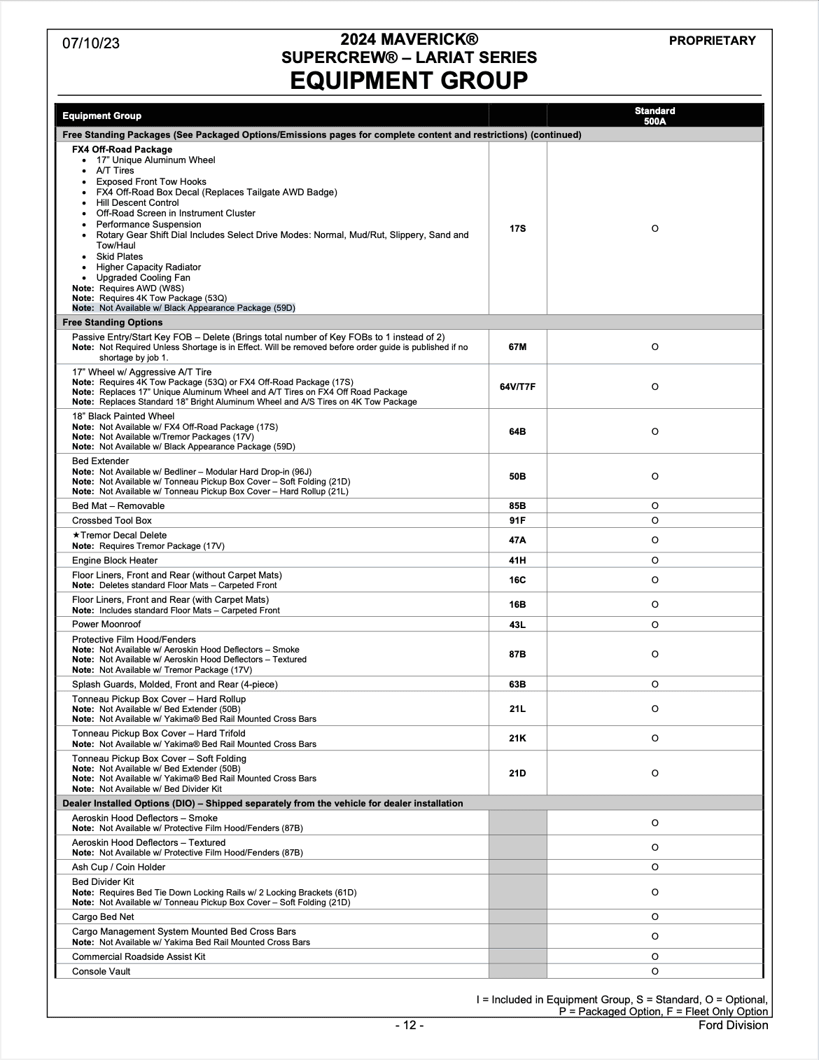

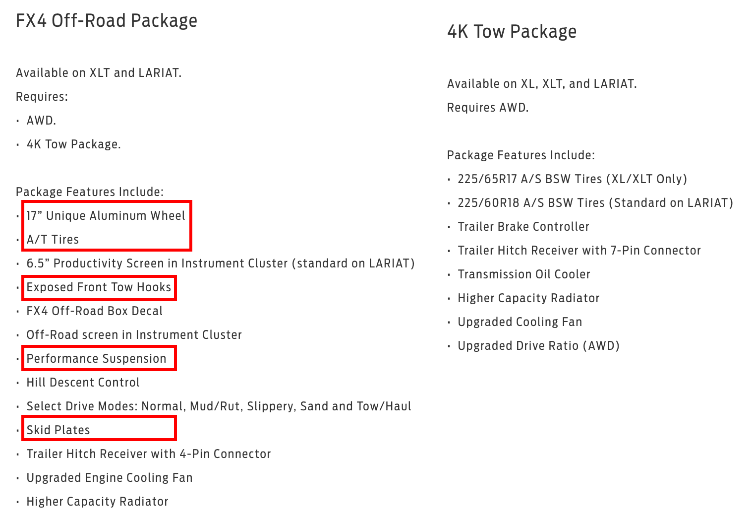

If BAP is crucial to you, you answered your own question, get BAP instead of FX4. Not loosing much on FX4 compared to 4K Tow.
Mainly AT tires (17" vs 18"), tow hooks and skid plates. Not exactly sure what "performance suspension" means to the Maverick. Maybe a small lift?

That's what I thought, a small lift from the factory. And yes, BAP is cosmetics only, FX4 is actual upgrades.
If the reason for BAP is only the seats, then NOT worth it. You can get Katzkin covers or something similar.

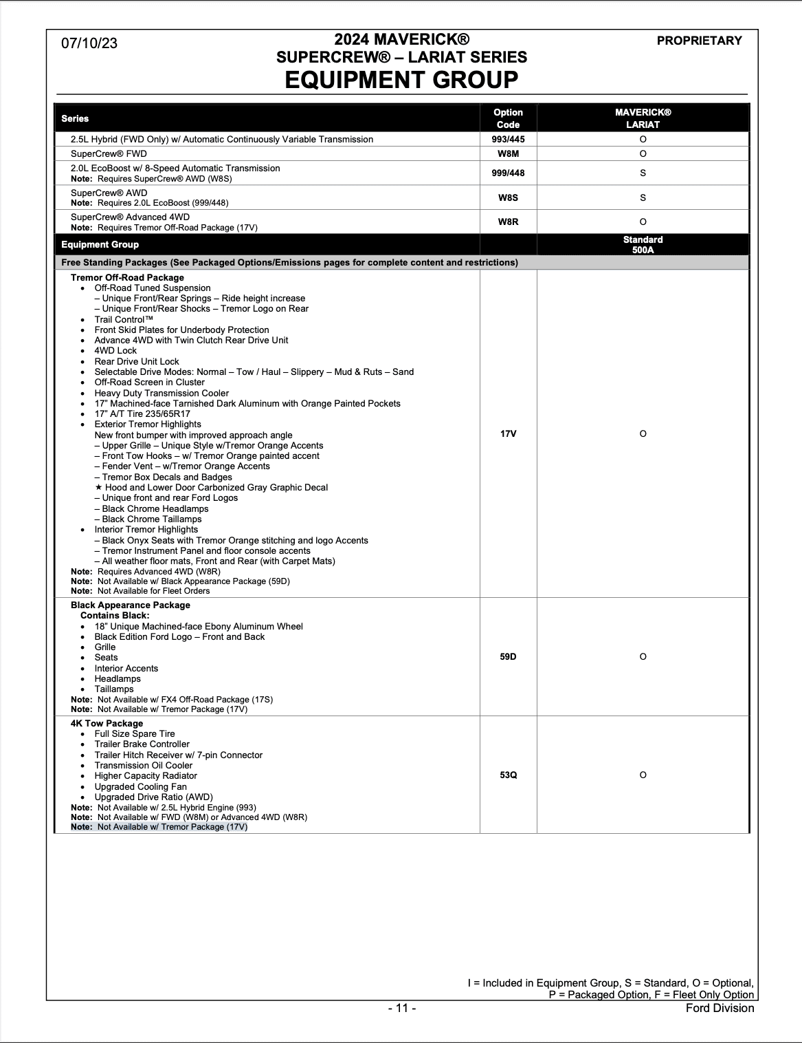

with the Tremor you get some of the BAP, seats, exterior lights plus all the FX4 goodies, Wildpeaks and more

Absolutely true! But you loose on the 4K tow. Tremors can only tow up to 2000lbs and have reduced payload capacity

Yes, FX4 and BAP are mutually exclusive. As noted, Tremor gets some of the BAP touches, but is incompatible with 4k tow, whereas FX4 requires 4k tow. Ultimately, it comes down to what your priorities are for this vehicle.
BAP + FX4 (if you could get it) would be $2,445. Tremor is $3,495.
