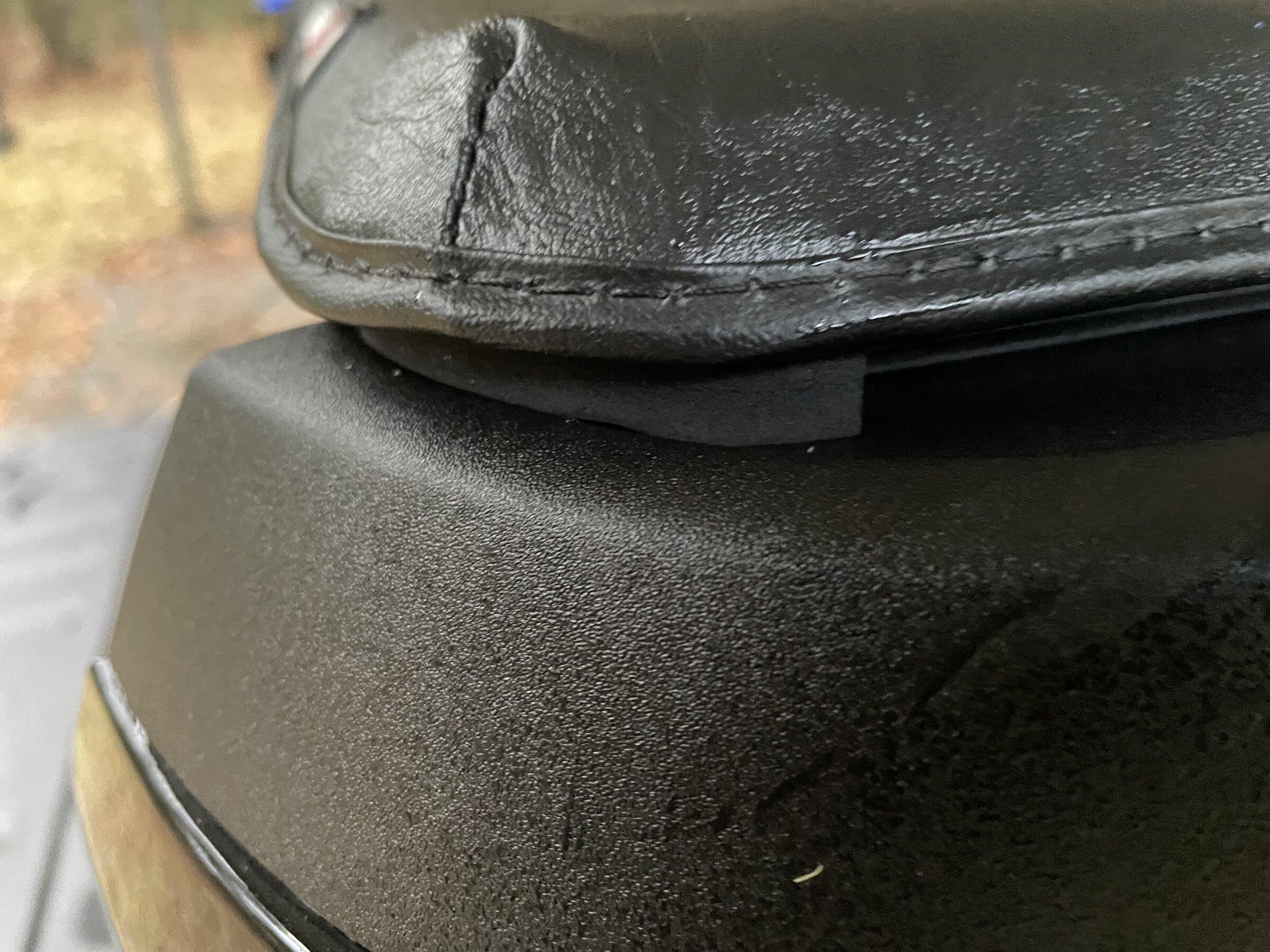

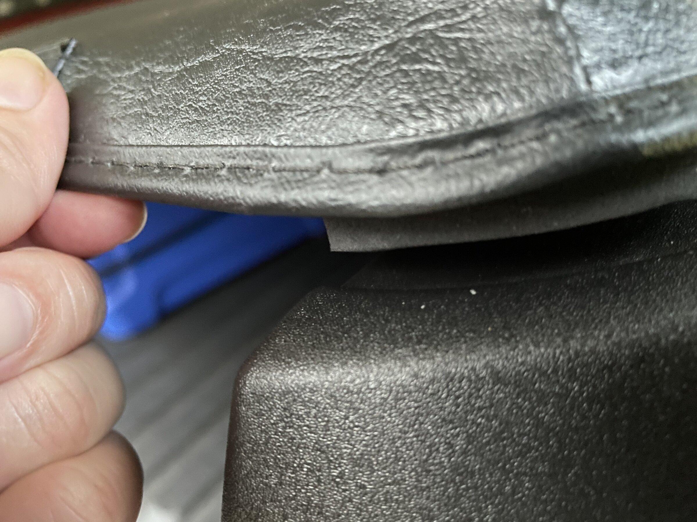

I have reattached it a few times and find the best fit is in the back near the tailgate. The bottom of the tonneau cover has a lip at the back and it should touch the lip of the trucks plastic rail in the back, but not sit on it. i think that is what you did too. I will eventually take a pic of that. Some people have asked how to fit it, and I think that’s how it works. The other issue with these tonneau covers is even when you got it set up right, it can get crooked once you start tightening the hooks

Here is more of what I mean about how to fit the cover right.., the lip on the bottom of the tonneau cover should touch and be flush with the lip on the back plastic tail but not sit on top of it.
Ford Maverick Extang Trifecta 2.0 soft-fold tonneau cover installed 0CE1960A-BC18-444C-8355-2D473CA941DC
Ford Maverick Extang Trifecta 2.0 soft-fold tonneau cover installed 451DF595-96E6-493E-ACC8-93674325D3A2
