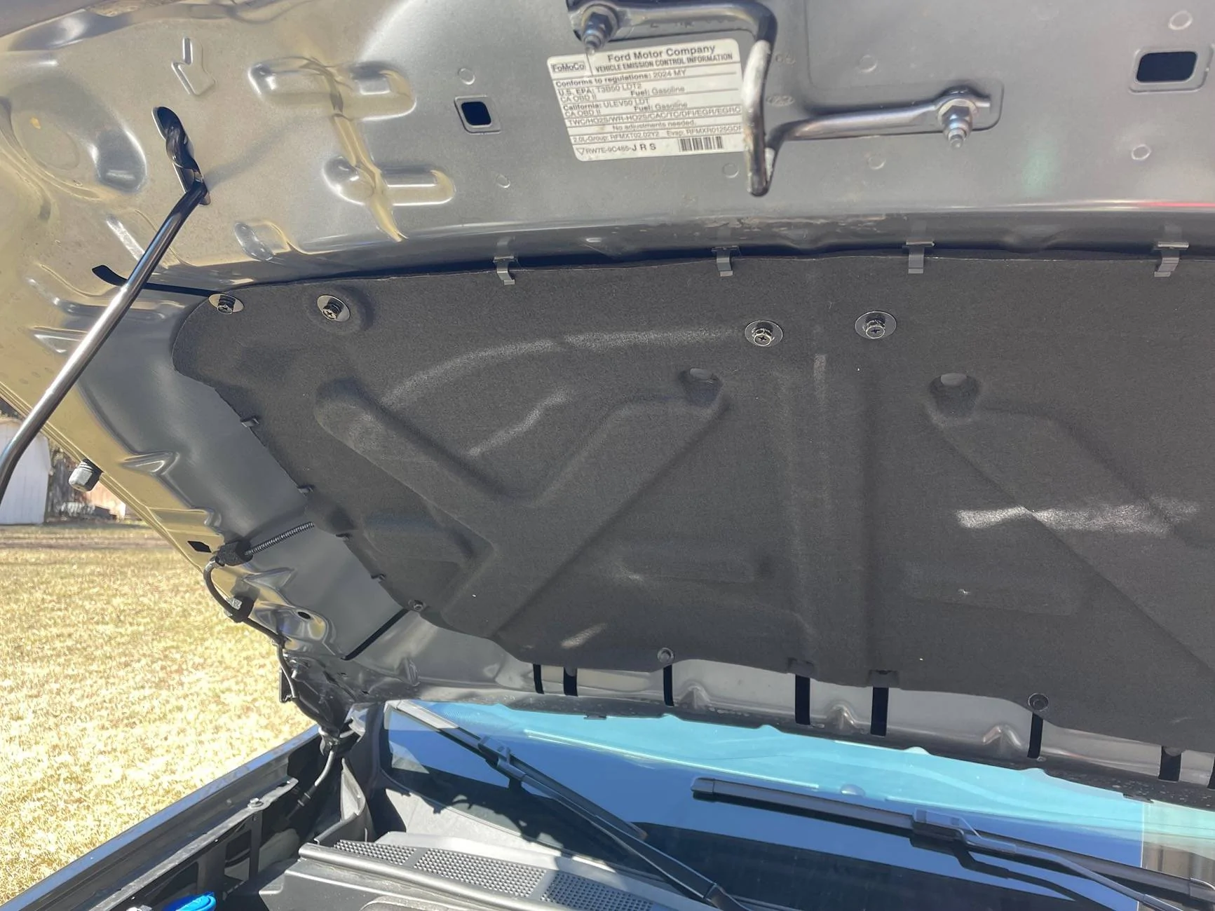

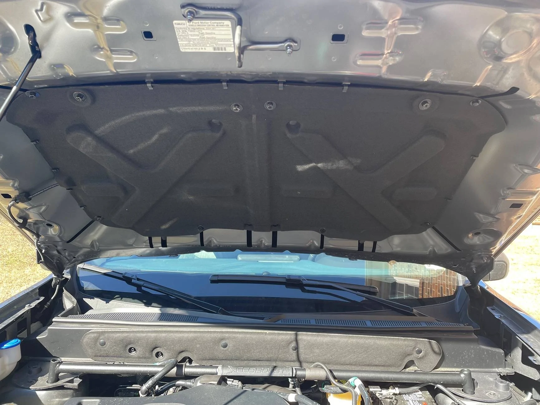

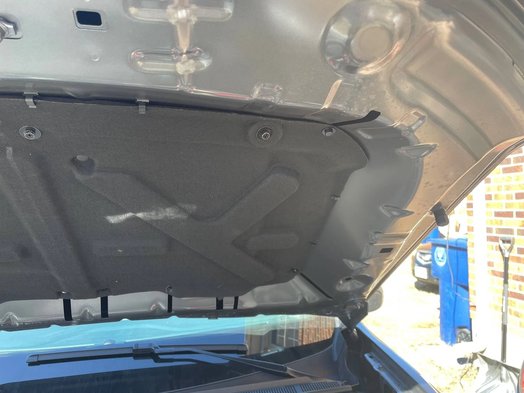

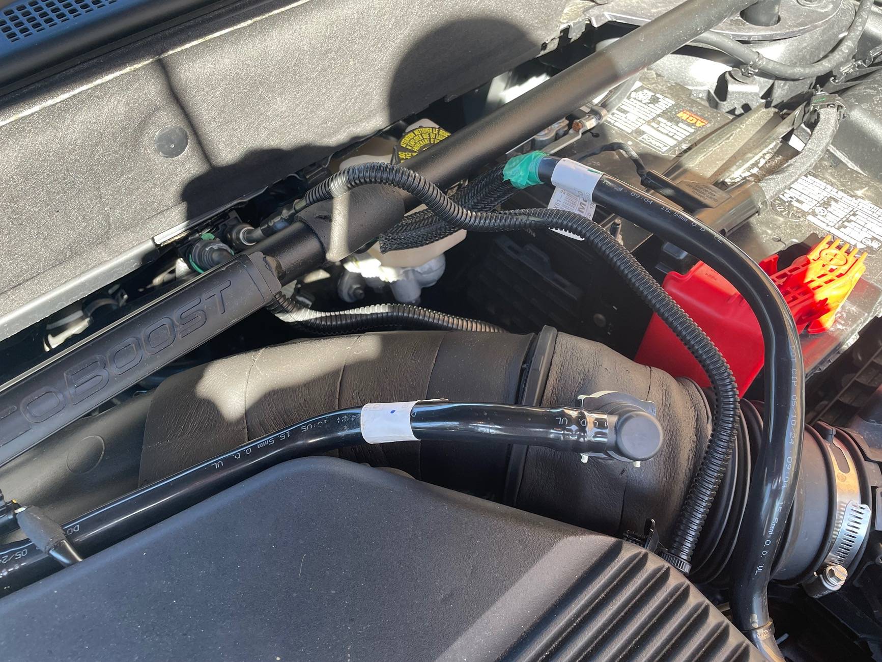

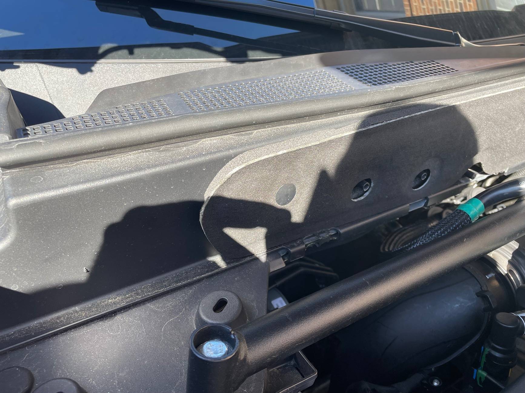

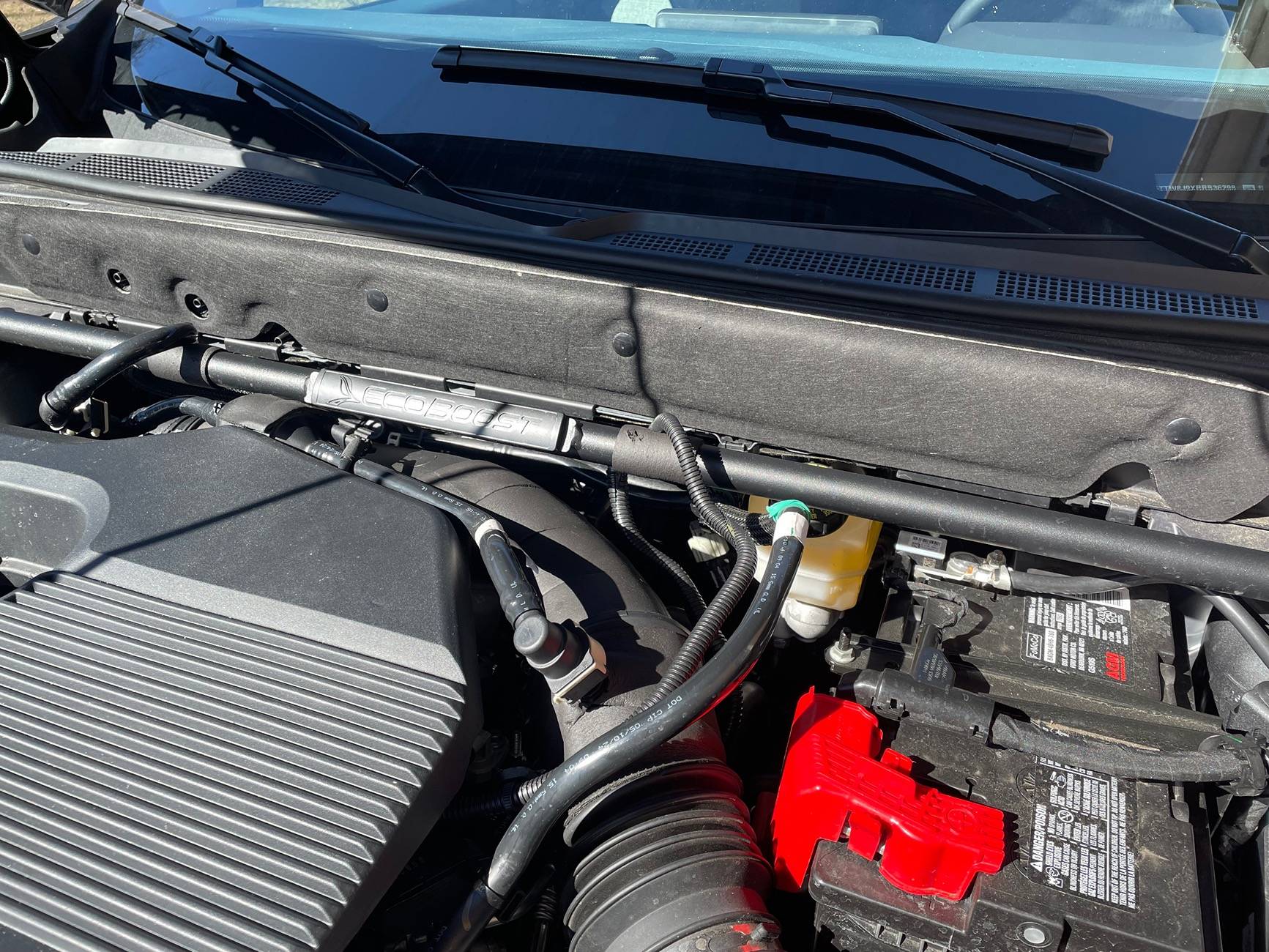

Here are the pictures of my hood mat. I could have done a better job with the clips and extra fasteners. Some are not quite symmetrical. Also the cowl insulation and intake wrap. The intake wrap is doing double duty as sound deadening and IAT insulation. The factory intake has heat shielding on the bottom, so in my reasoning a little more won’t hurt. The foam I cut to back the cowl insulator unfortunately shrunk after I pulled the paper off the adhesive backing so the cut is not perfect. To be honest I wasn’t sure I could live with the direct injection noise, I thought I made a mistake buying the ecoboost. I had that awful sinking feeling of regret. Now I am okay with it.

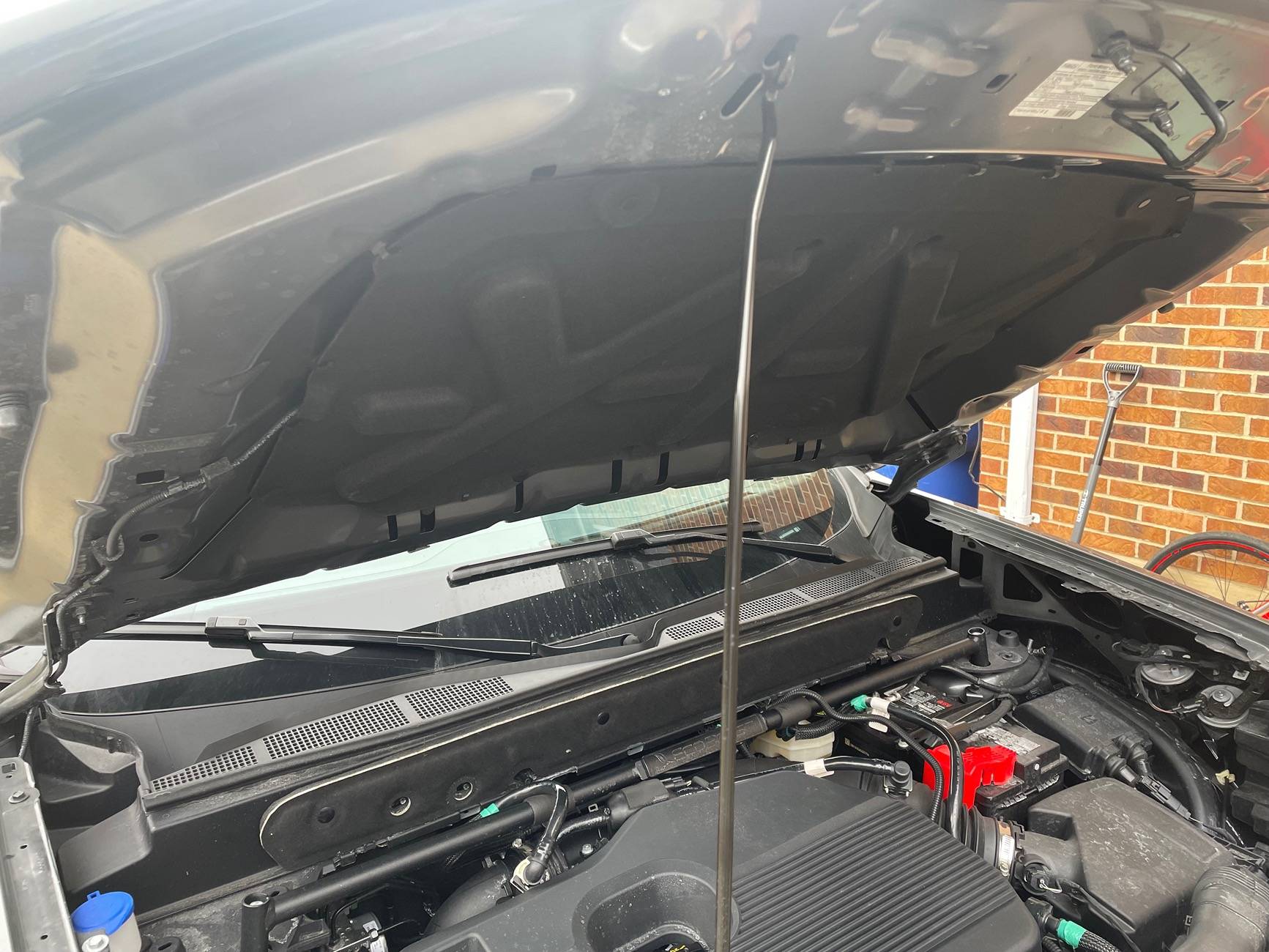

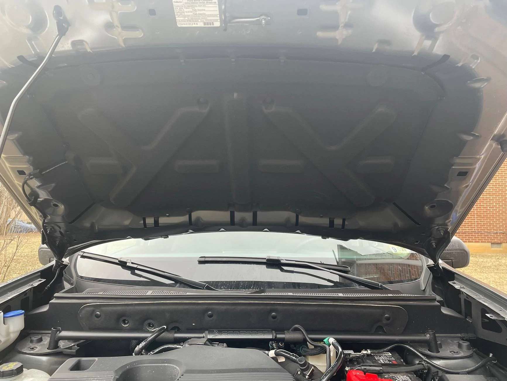

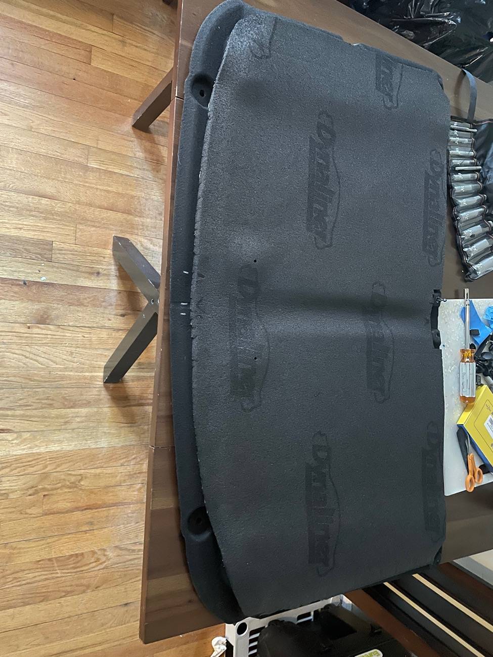

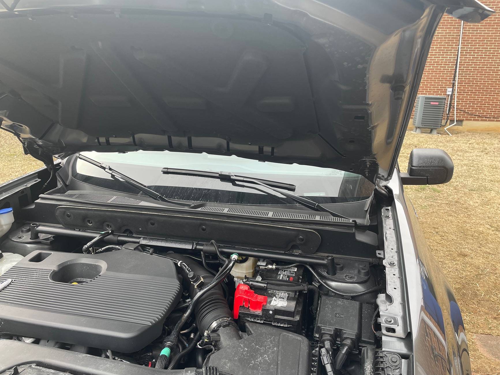

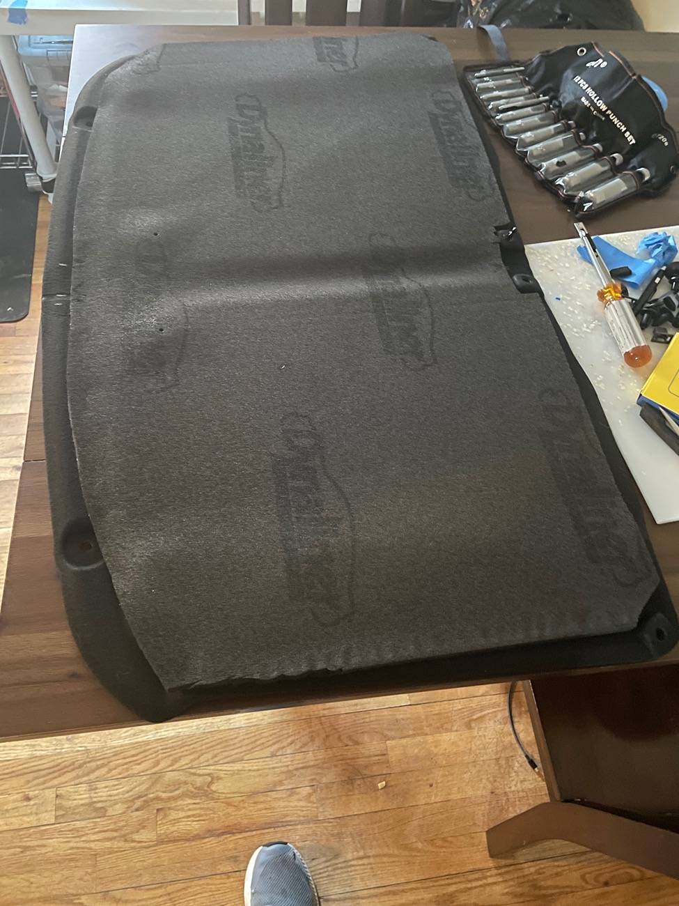

A little update: after posting pictures, my hood mat started to look a little too DIY and wonky to me. I decided to pull it back down and redo the mounting points. I really didn’t like the supplied screw and clasp hardware. After a lot of searching I found some Honda plastic rivets that worked in the square channels. Using a combination of these and off the shelf plastic pins I was able to convert all the mounting points to push type fasteners. While it was off I replaced the Amazon foam with Dynaliner.
Just a word of warning if you do install the mat; the clearance between the end of the clasp / screw hardware and the hood shell is scary close in some spots. Be very careful when tightening them down.
