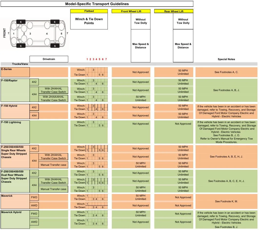

Saw this 2023_Wrecker_Towing_Guide_mcs6420.pdf while looking for some Ford info today.
It appears to me that Maverick AWD needs flatbed towing.
Took me a bit to see their reference to Maverick Hybrid AWD. :)
Transport-Guideline Footnote "K"
Please refer to the owner’s manual for stay in neutral mode.
NOTE: Stay in neutral mode is a temporary vehicle state with the ignition off. Once in this mode, sufficient battery voltage must be maintained or your vehicle returns to park.
Do not tow your vehicle in this mode.
