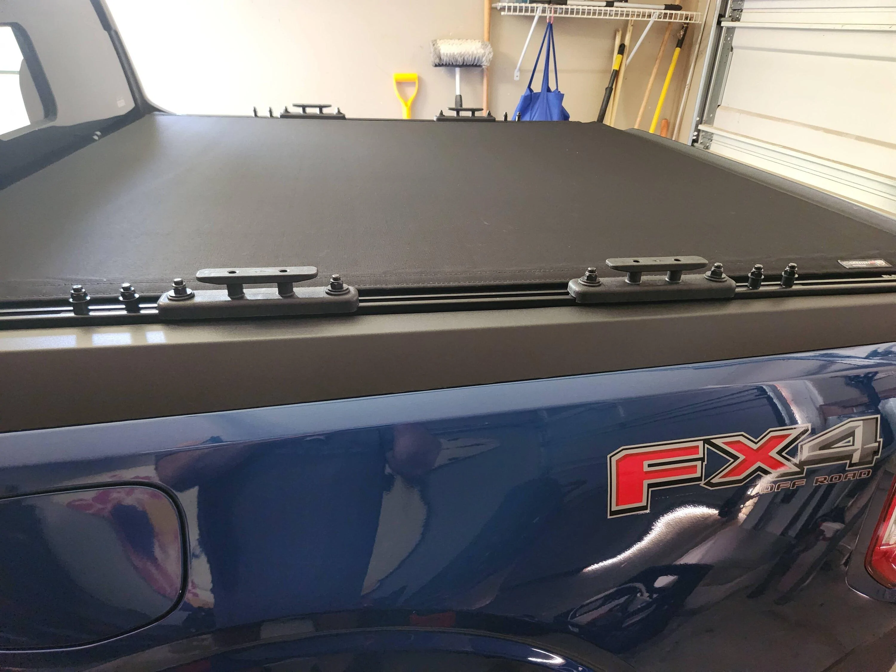

I have the undercover ultra flex. I had to move the prop rods a little (easy to do) to hold the folded cover up against the crossbar.

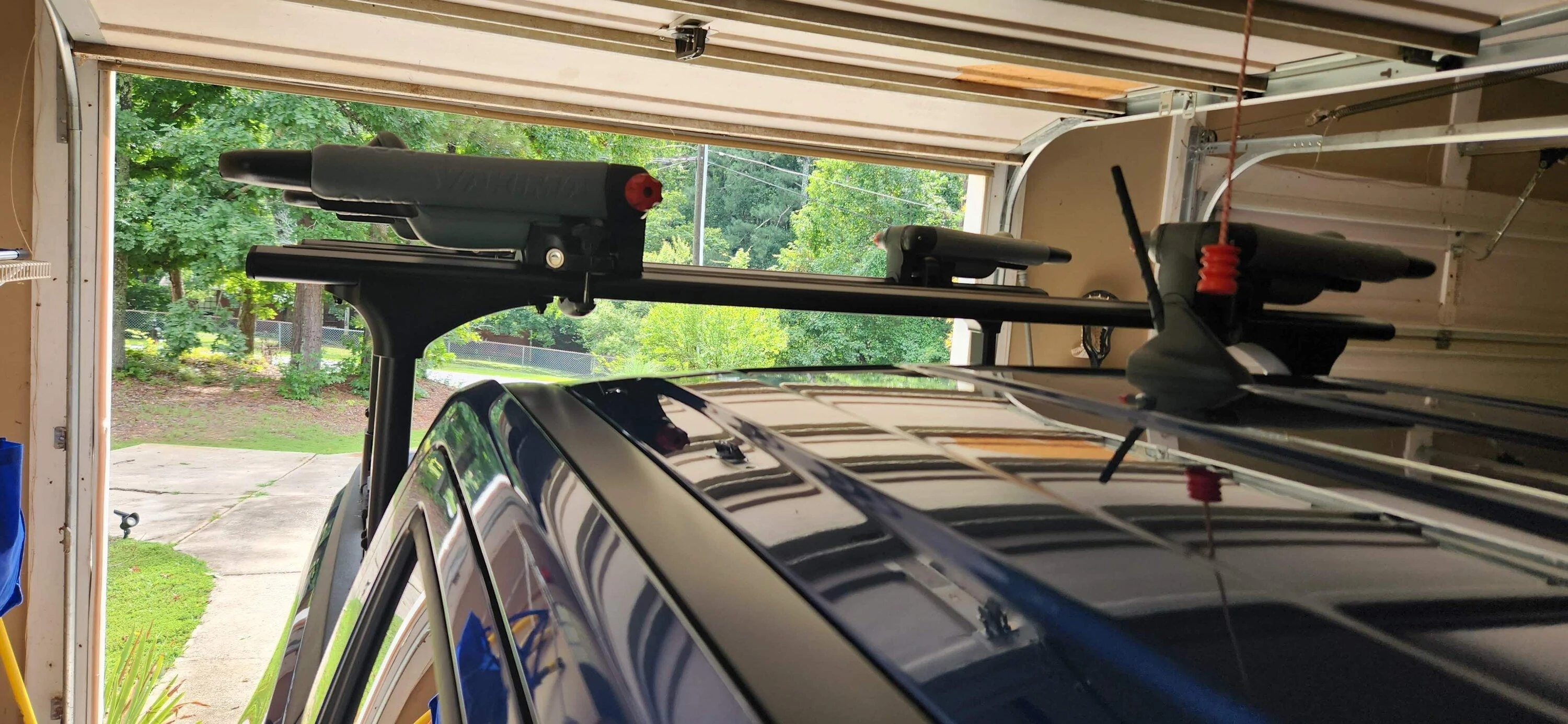

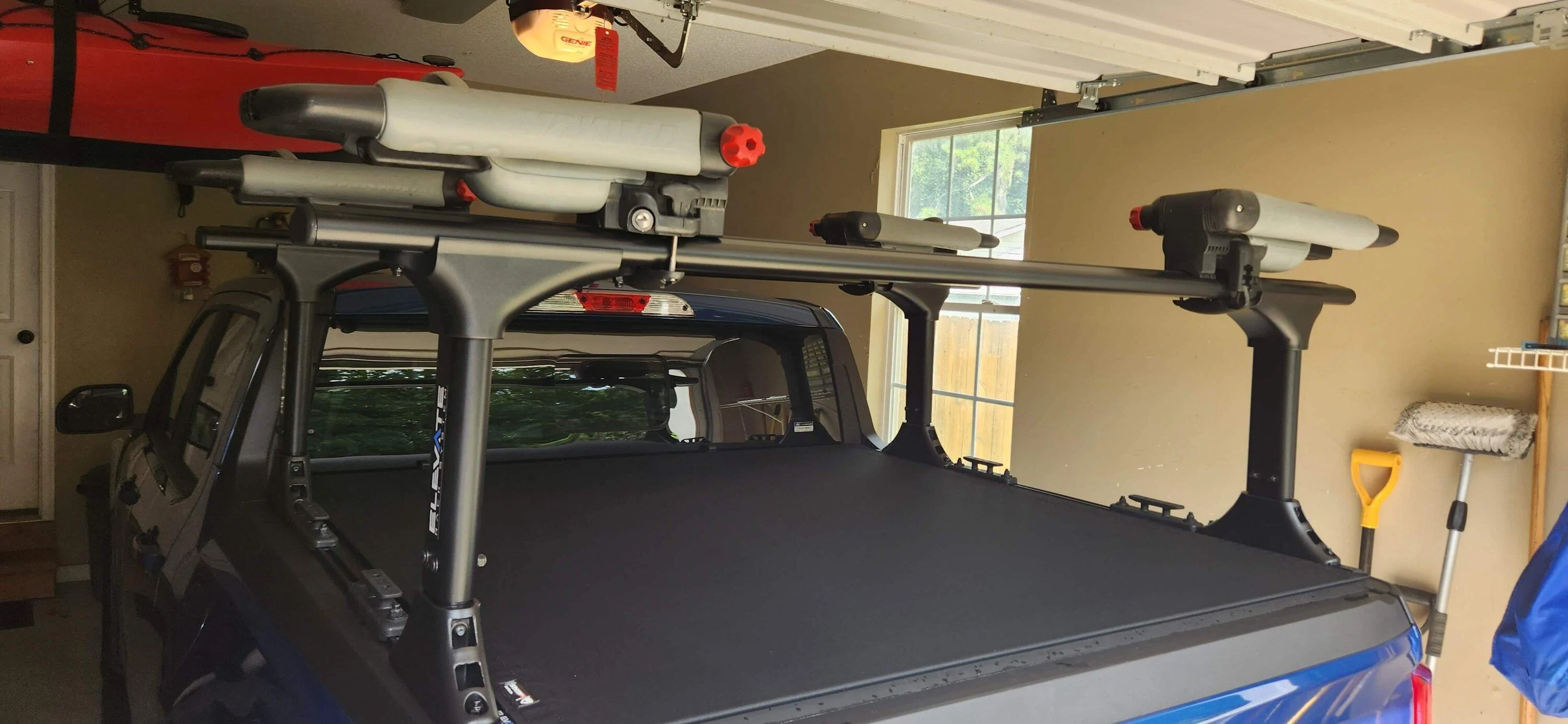

My Elevate CS racks finally arrived on Saturday. Not the best packaging from the factory. A few scuffs and a small ding. Not enough to warrant a return though.
One thing to mention, the Elevate CS racks now come with a 3rd set of holes for height adjustment. I believe they originally offered only two settings, all the way down (18" height) and all the way up (28" height). Now there is a set of holes in the middle that give a 23" rack height. The lowest setting is enough for my kayaks, but I may use the 23" height if I ever need to put something in the middle and I want to clear the sharkfin antenna.

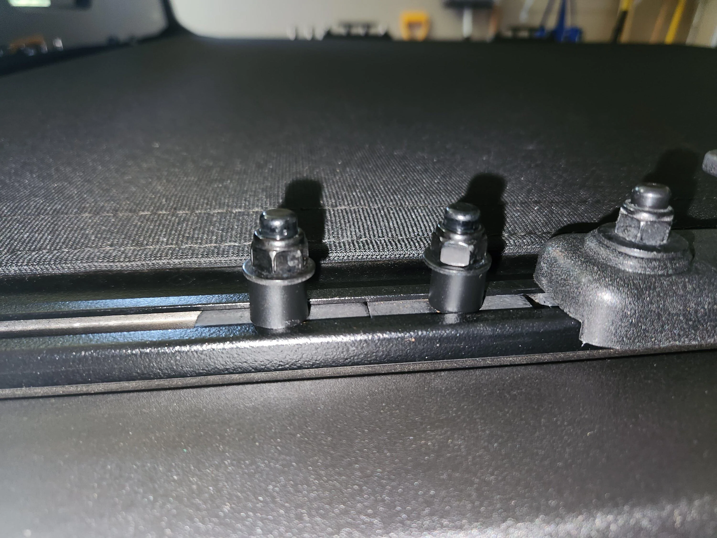

So some early posters said they did not notice a change in MPG with these installed, but I certainly did. Maybe it is because my kayak holders are larger than most? Since I installed this setup, I could not get more than 24MPG in mixed driving. The lowest tank average in the previous ~4000 miles was around 27.5MPG. It seems like the hit was greater on highway mileage as would be expected.
So, between the lower efficiency and the whistling noises that the kayak holders make, I decided they needed to be removed for daily driving and just put on when the need arises. Turns out, removing the entire Elevate CS rack is much easier than removing the key-locked Yakima BowDown holders. The entire rack only needs a quick loosening of 8 nuts and they come off easily (no binding). The problem is that I don't want to remove the end caps on the TS rails and loosen my cleats, etc. to get the T-bolts out. The acorn nuts will not tighten the T-bolts without the CS Racks installed (they will rattle and slide), and it also shows the unpainted bolt color.

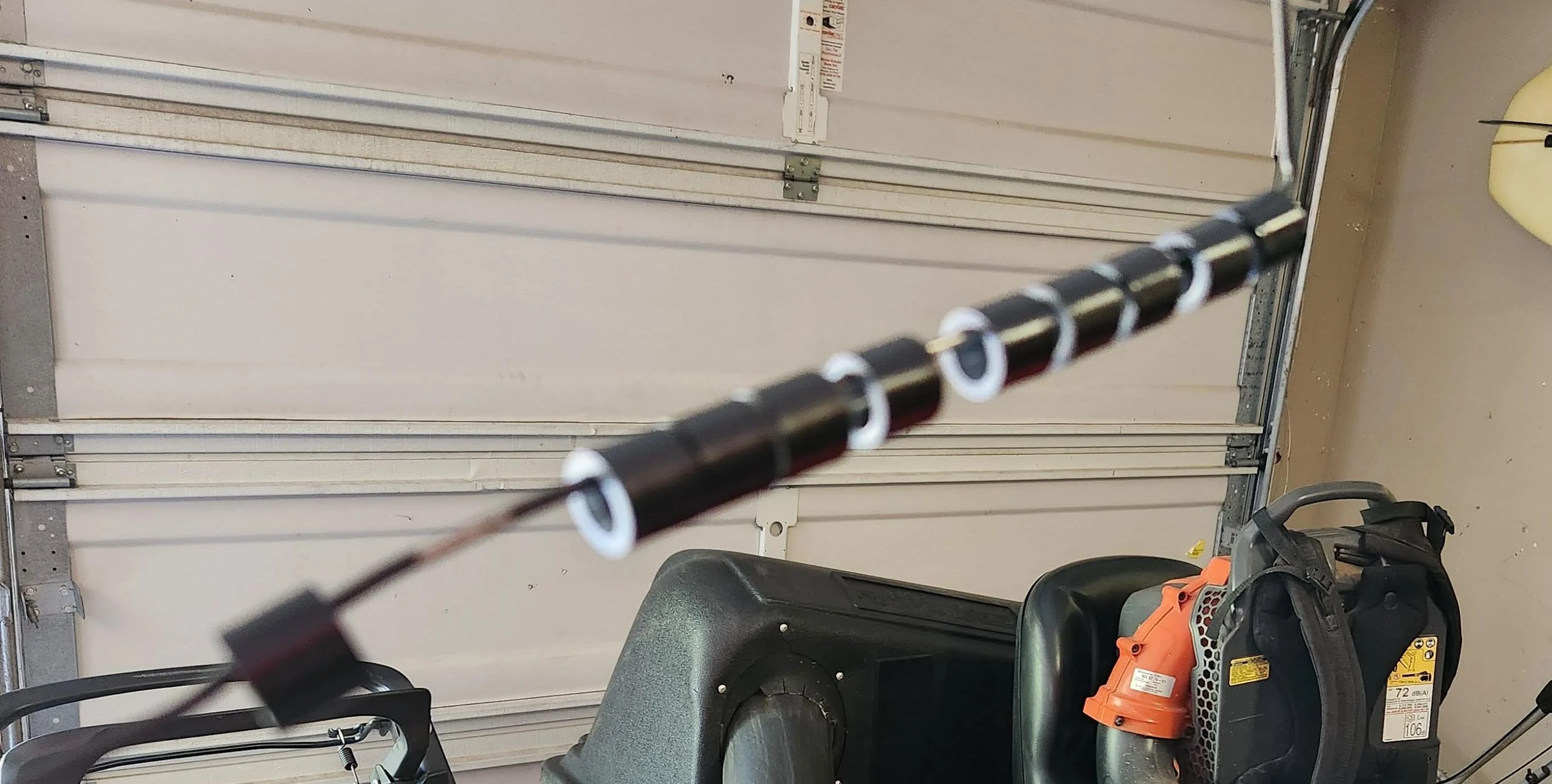

Solution? Find a spacer! Did some quick measurements with the calipers and bought 5 packs (10 pieces) of these from Home Depot (a couple spares). https://www.homedepot.com/p/Everbilt-0-38-x-0-56-x0-5-Nylon-Spacer-2PC-15R-867598/323369828
White nylon will look awful though. Wiped with isopropyl, dried and a quick spray with matte black solves that problem. Coat hanger used as a fixture to paint and dry.
Ford Maverick Elevate CS Rack installed 20230820_162346
Installed, it looks clean and should make reinstalling the CS Racks pretty simple. They are just over hand tightened as to not deform the nylon. Hopefully the paint holds up. In the 45 miles or so I've driven since taking off the racks/kayak holders, my fuel economy is back above 27mpg and that's all back road, mostly under 45mph driving.

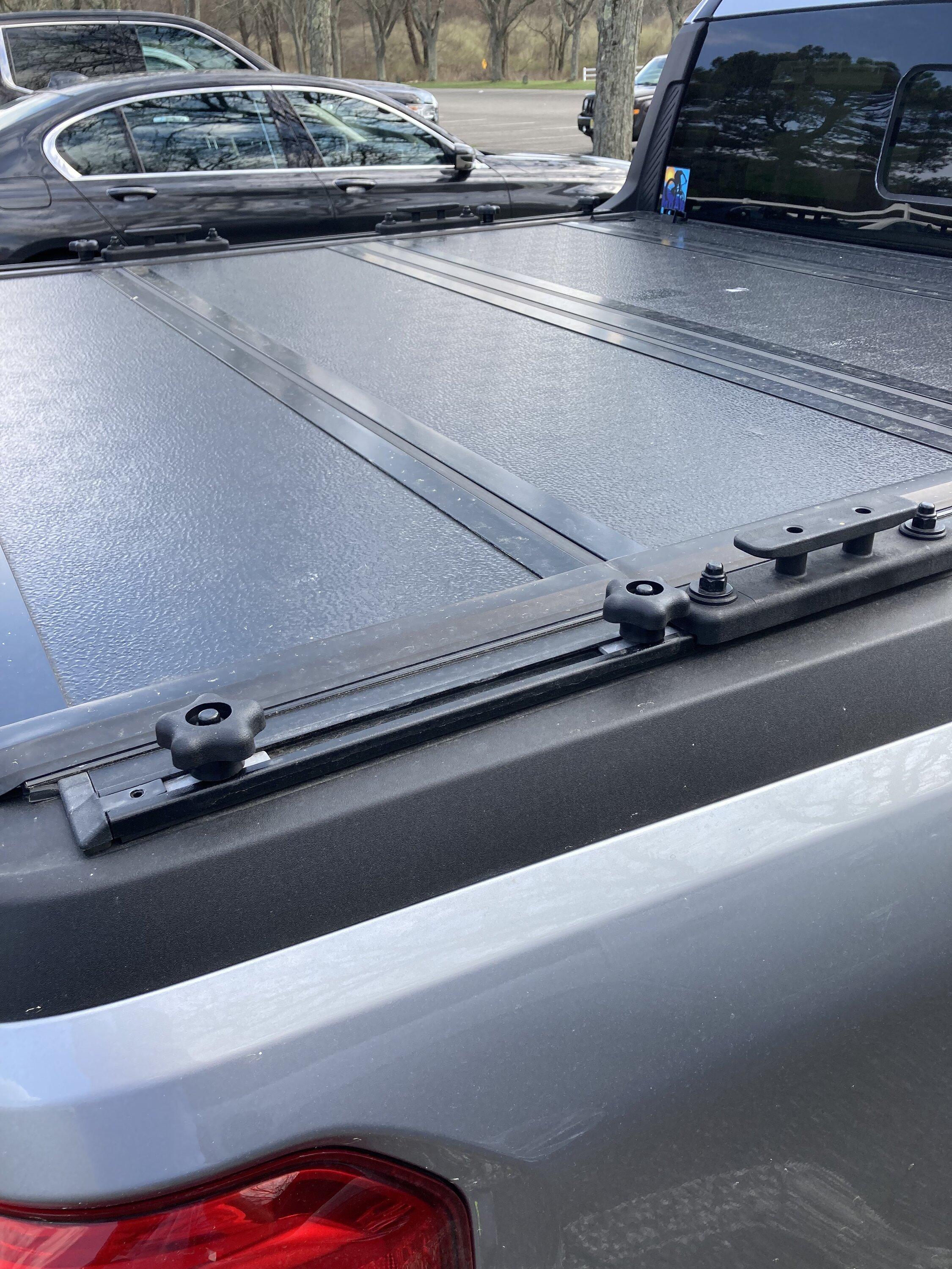

I like your solution. I tackled the same issue by purchasing threaded star knobs on Amazon that tighten down onto the bolts that stick out.

Those are nice, but I wanted something that was inexpensive and that I could get on a Sunday (this past weekend).
