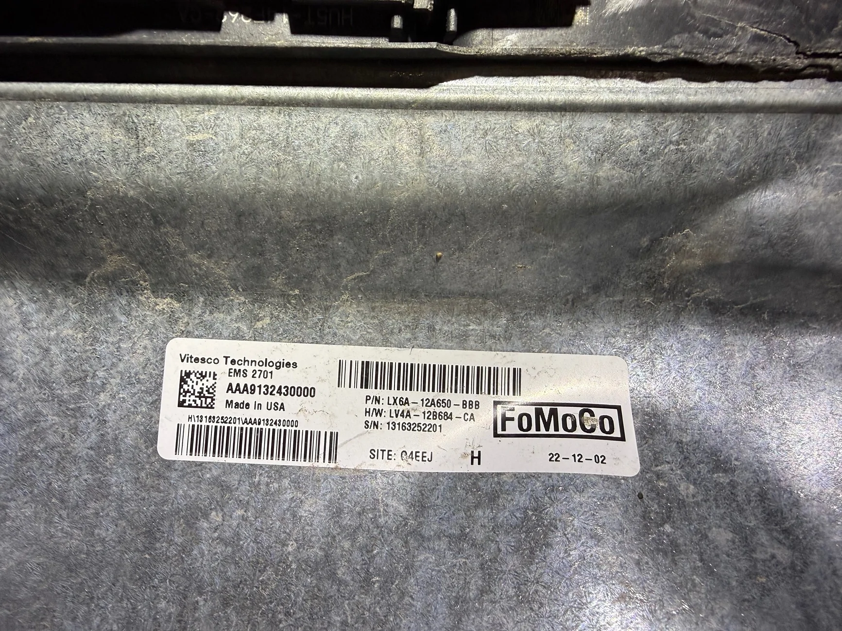

What’s the best one device to program a pcm on ford maverick hybrid 23
Mine got crashed in accident and I bought a used one
Ford Maverick Ecm program IMG_1185

I have No Clue, but based on a google search listed below, appears a ford dealer will need to be involved 🤷‍♂️
AI Overview
Programming or replacing an Engine Control Module (ECM/PCM) on a 2023 Ford Maverick Hybrid requires specialized software and hardware, as it is a modern vehicle with a high-voltage system.
The official method used by Ford is the Ford Diagnostic and Repair System (FDRS), which allows for Module Programming and Programmable Module Installation (PMI).
Essential Tools and Requirements
  • Laptop: Windows 8 or later with internet access.
  • VCI Device: A J2534-compatible passthru device (e.g., VXDIAG VCX Nano for Ford, Mongoose Plus).
  • Software: Ford FDRS software (downloadable from Motorcraft Service).
  • Subscription: 2-day FDRS license (approx. $50).
  • Power Supply: A dedicated battery charger/power supply to maintain over 12V (essential).
Step-by-Step Programming Procedure (PMI)
If replacing the ECM, the Programmable Module Installation (PMI) process is used to transfer data from the old unit to the new one.
  1. Preparation: Connect the VCI to the Maverick's OBDII port and the laptop. Turn the vehicle to Accessory Mode (key on, engine off).
  2. Launch FDRS: Open the FDRS application and ensure the VIN is recognized.
  3. Initiate PMI: Navigate to the Toolbox tab and select "Programmable Module Installation" (PMI) > "PCM".
  4. Extract Data: The software will guide you through reading the configuration data from the old ECM (if it is still communicating).
  5. Replace Module: Turn the ignition off, replace the PCM hardware, then turn back to Accessory Mode.
  6. Load Data: Select "Write" in the software to transfer the saved data to the new ECM.
  7. Complete Setup: Follow prompts to complete the installation. The software will automatically perform a "Parameter Reset" to synchronize the new ECM with the security system.
  8. Clear Codes: Clear all diagnostic trouble codes (DTCs) and perform a test drive.
Important Notes for 2023 Maverick Hybrid
  • Software Update (P2282): Some 2023 Maverick Hybrids (built Apr 11 – Aug 23, 2023) required a specific PCM update due to a potential air leak issue.
  • If Old Module is Dead: If you cannot read the old PCM, you must perform a manual installation, which requires inputting the vehicle's As-Built data from the Motorcraft website.
  • BMS Reset: After changing the module, it is recommended to reset the Battery Management System (BMS).
Disclaimer: Improperly programming an ECM can cause severe vehicle damage. It is highly recommended to have this procedure performed by a qualified Ford technician or experienced shop.

Pretty much only FDRS will do it.
The major modules are encrypted & must be reset using the trusted module reset procedure "TRON"
I'm not aware of any other equipment capable of it
