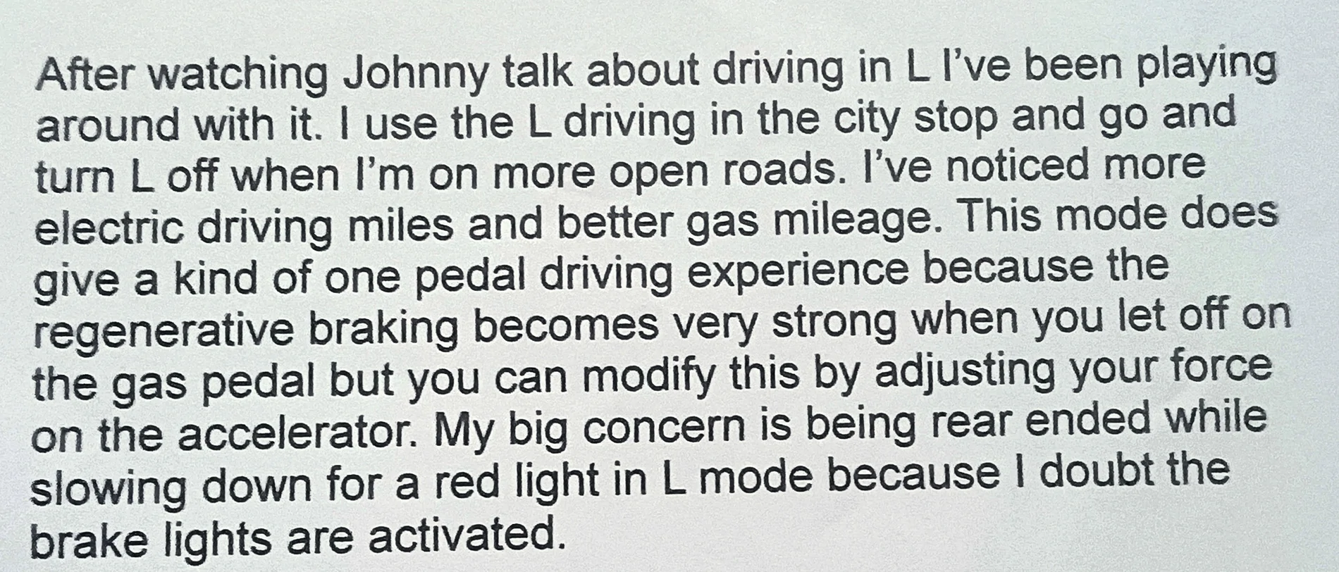

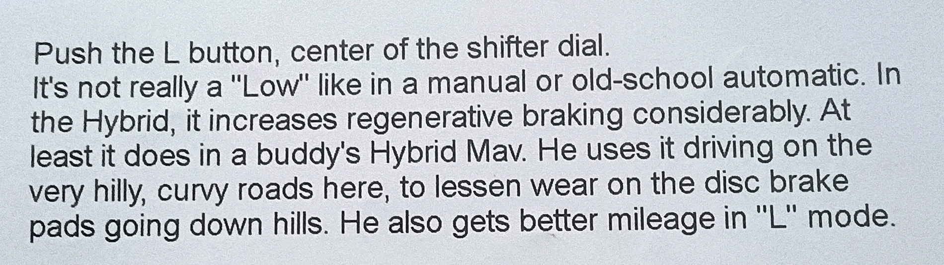

check out these two comments from past threads
Will driving in L save on fuel?
Ford Maverick driving my Hybrid in 'L' saves on gas? IMG_20260718_132357121_AE
Ford Maverick driving my Hybrid in 'L' saves on gas? IMG_20260718_132347682_AE
