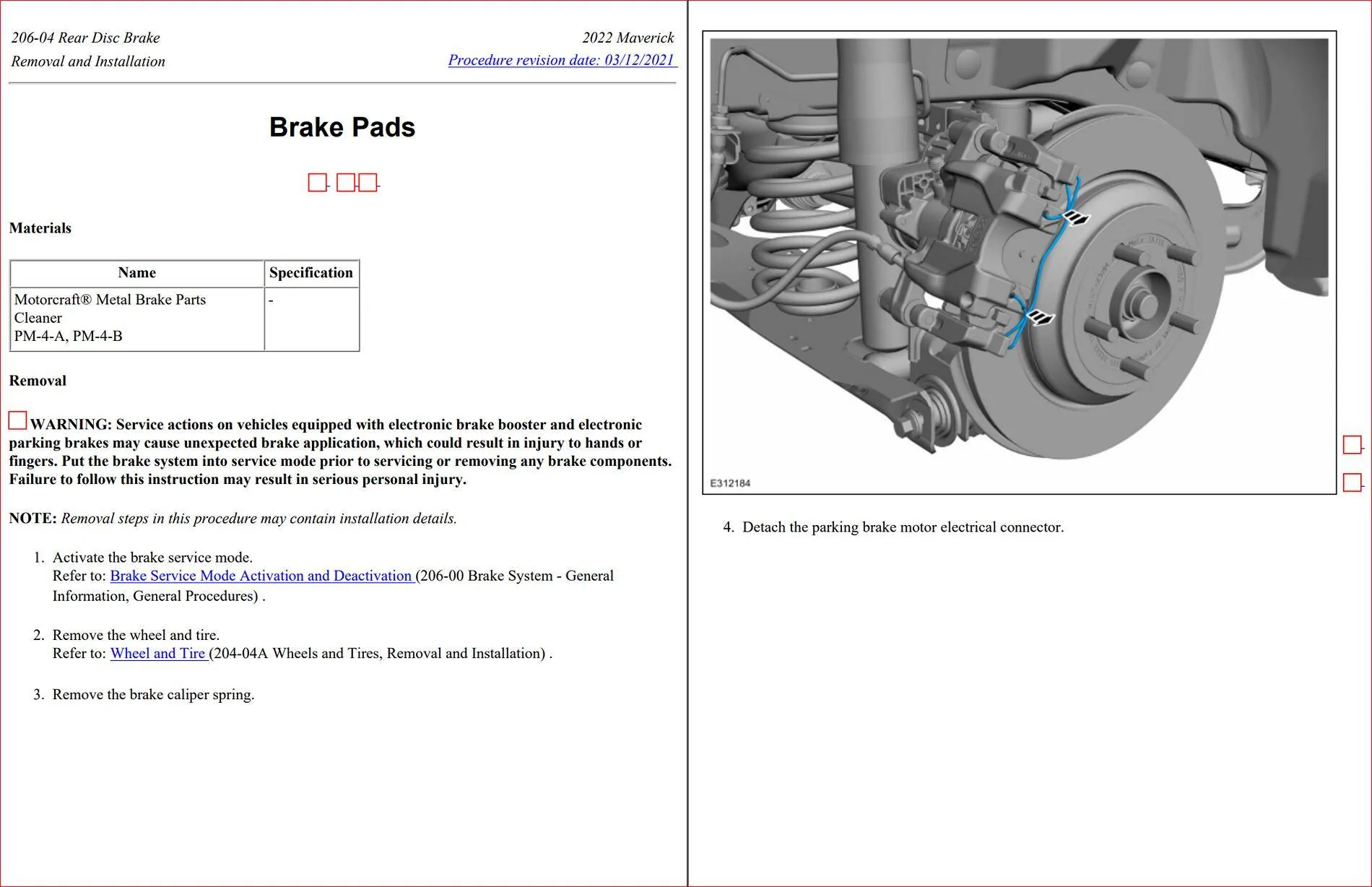

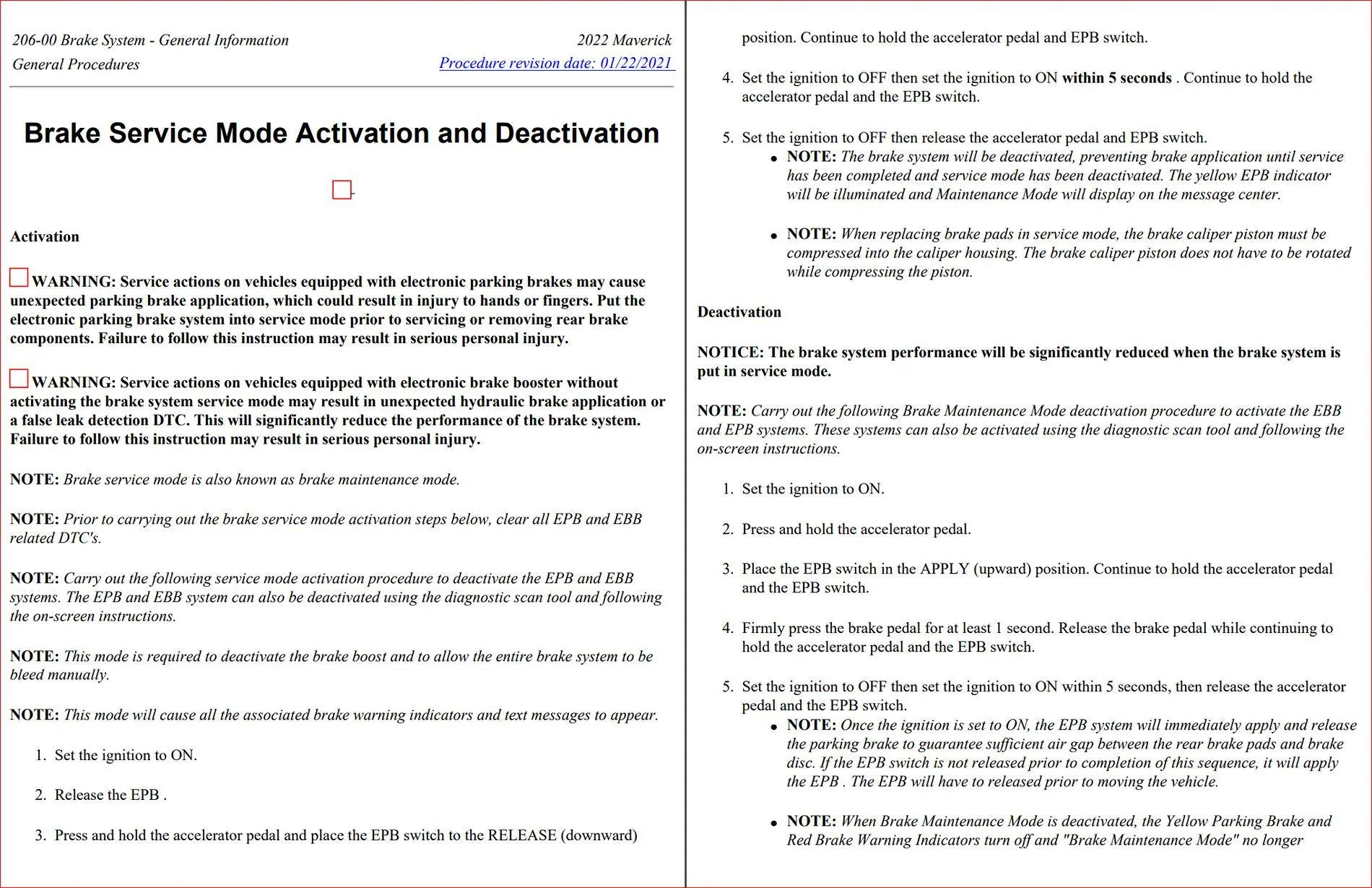

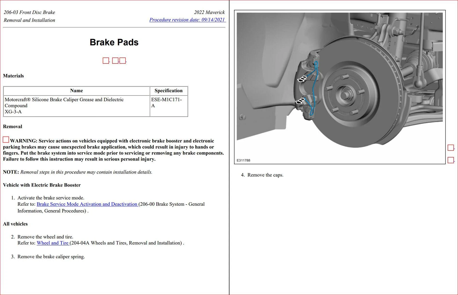

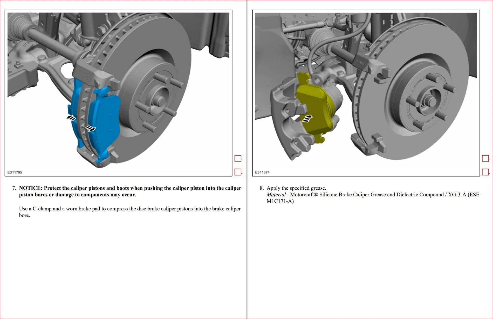

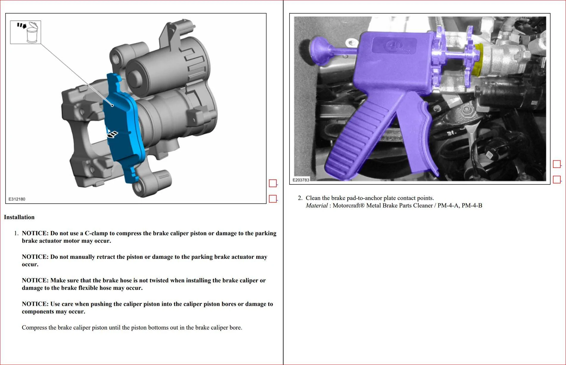

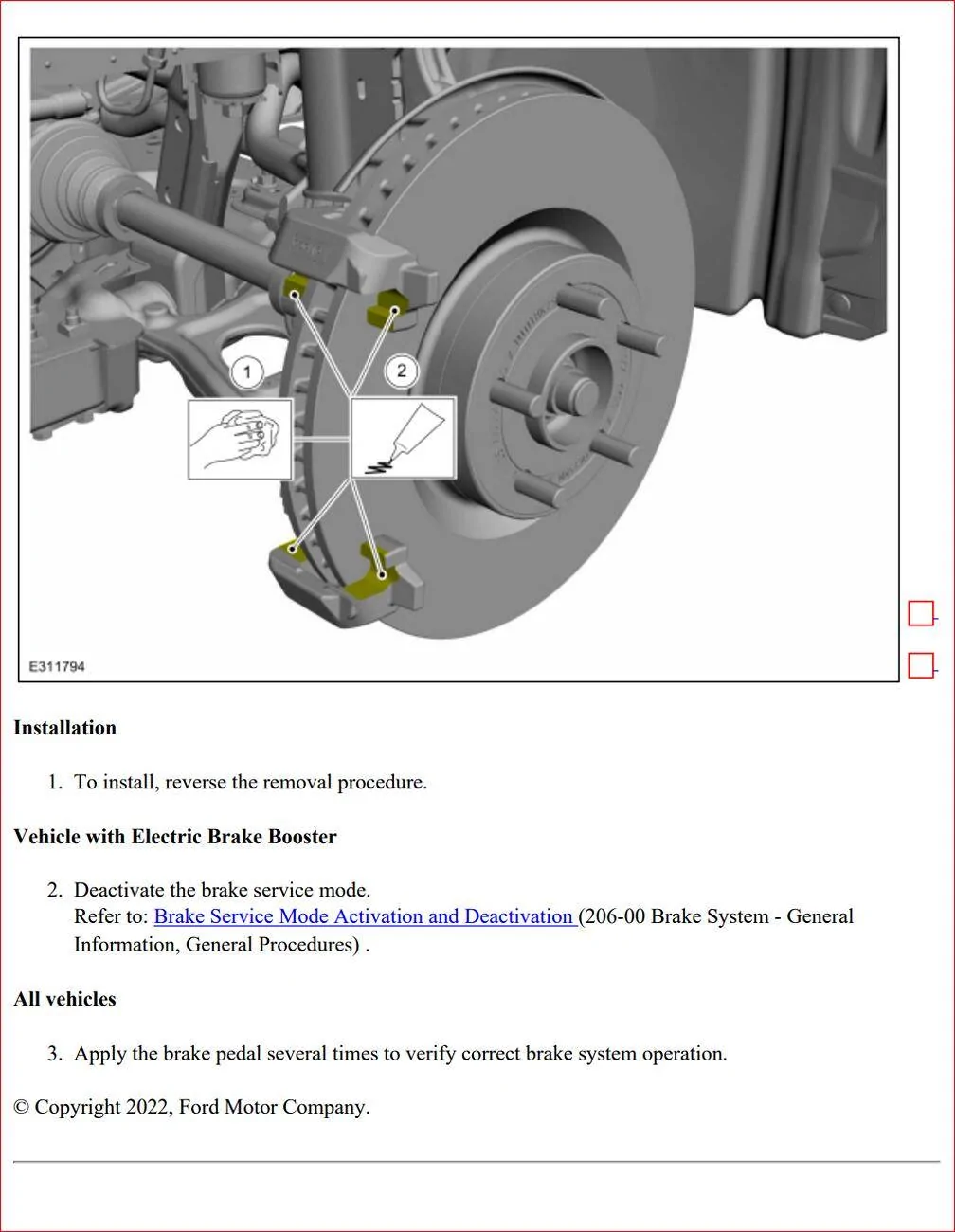

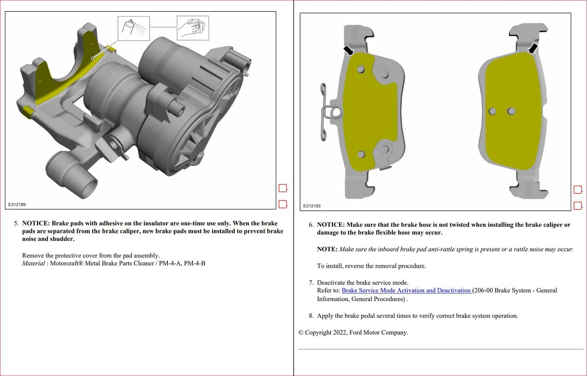

Might be time for me to get a controller that will execute the brake service/maintenance mode. My Subaru needs it as well, I didn't want to invest $300-400 on an OBD tool, so I bought all the rotors/pads myself. Did the front brakes myself, and then handed the rear parts to a friendly shop and they did the rear for $150.
Theoretically the tool would pay for itself in 2 uses. Anybody know how expensive of an OBD tool to pull off the Maverick's brake maintenance mode?
All Fords are the same, and no tool is needed.
Electronic parking brake
Some vehicles have an issue with going into the mode itself. If so, you can unplug the parking brake motors in the rear and just use a standard brake tool to wind the calipers in I believe. The fronts push in like normal IIRC.
Any scanner that works with Forscan or Forscan Lite on mobile device - will allow that program/app to do the Service for that mode enable/disable.
That allows avoiding the convoluted process that appears to required 3 hands at some point.
Obviously that doesn't help the Subaru situation, but some other scanner apps that work with the same OBD adapters also have service modes for same make/models. Not sure if the same cheap $7 Forscan is. And you'd want to confirm the app does the make/model, or ask around.
