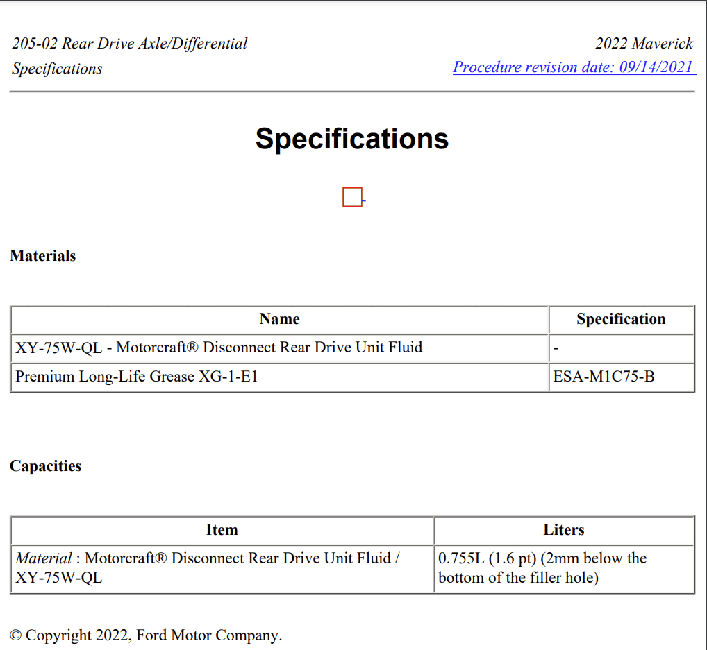

But all the service manuals make no differentiation between fluid specs. Since the manual also covers Hybrid equipment, it's safe to assume if there were any changes to be made they would be in there. If you need extra clarification, I'd check with the local service dept but this was sent to me in a PM from a service tech on this forum for the 23/24 YM and it's the same as the previous ones:

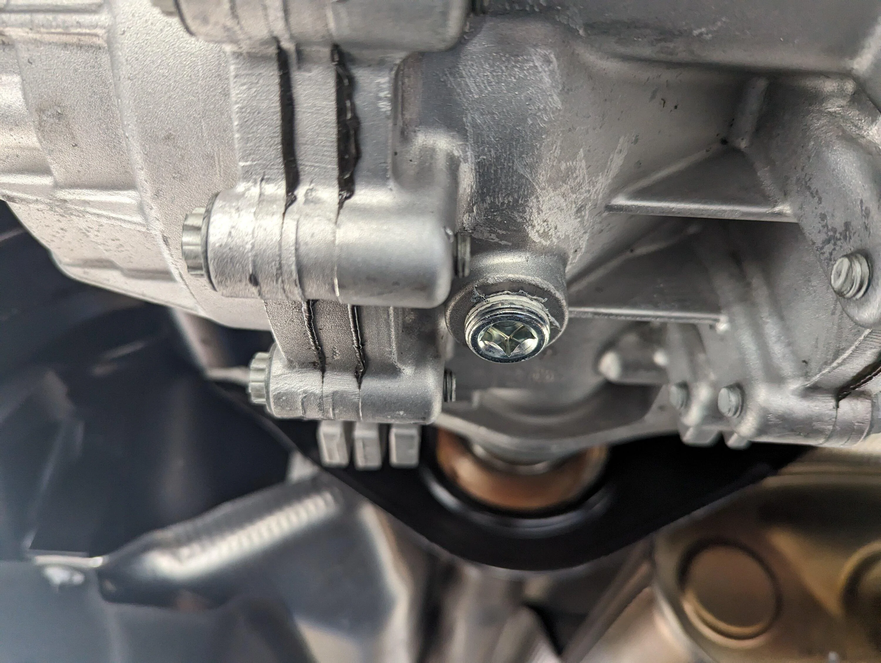

I got under my 2024 Lariat Tremor today to have a look and compare to what you shared here.
I have some pics which might show it
The PTU is different and those steps won't work. Just like the bronco badlands the drain plug appears to have been filled with a sensor. I think you'll have to remove the liquid cooler to drain it.

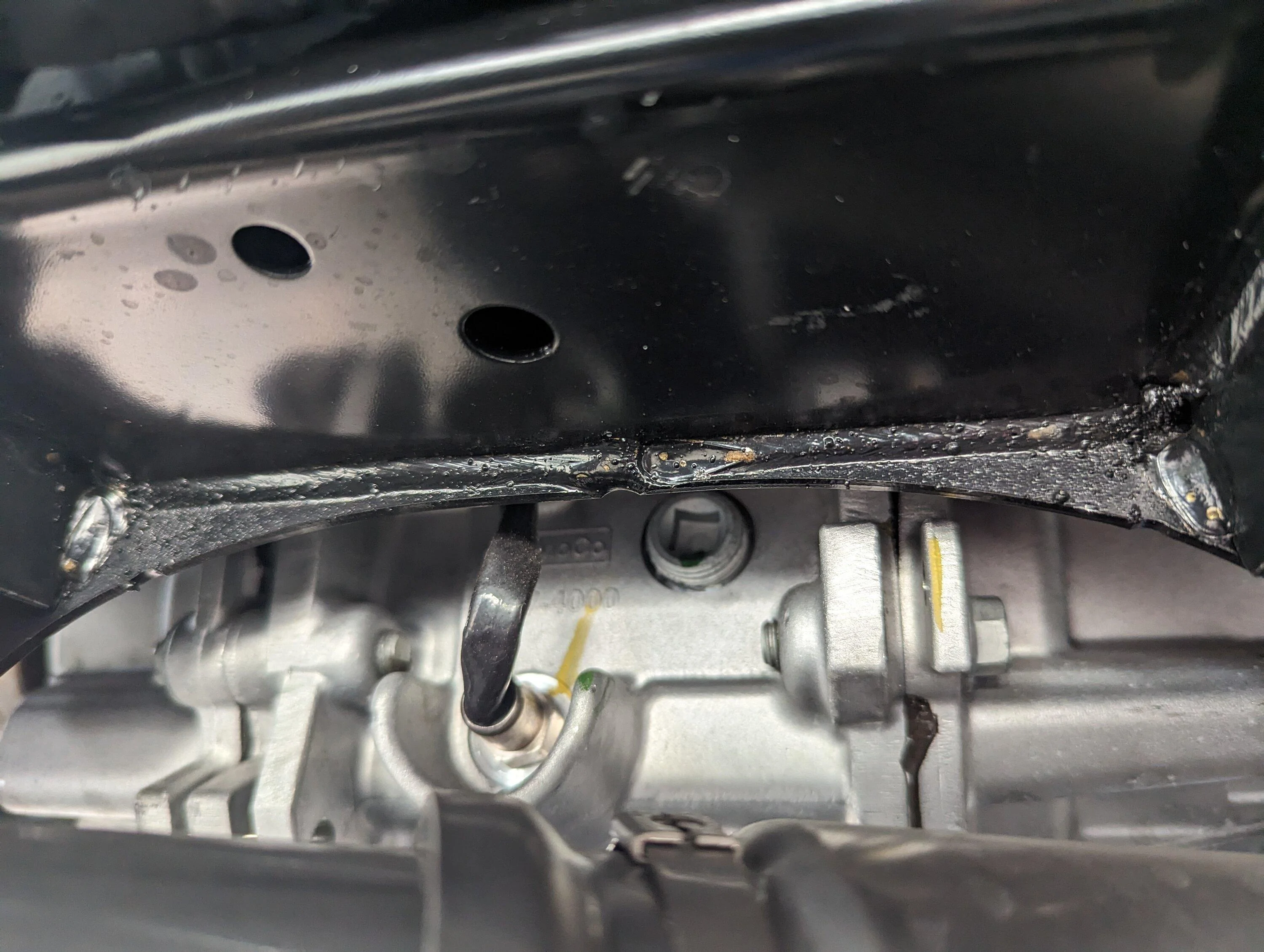

Here is the fill plug, up the passenger side like you expect
Ford Maverick Does tremor use different rear ptu fluid? PXL_20240203_204157242
But no drain plug, it appears to be holding a sensor.
Ford Maverick Does tremor use different rear ptu fluid? PXL_20240203_204132681

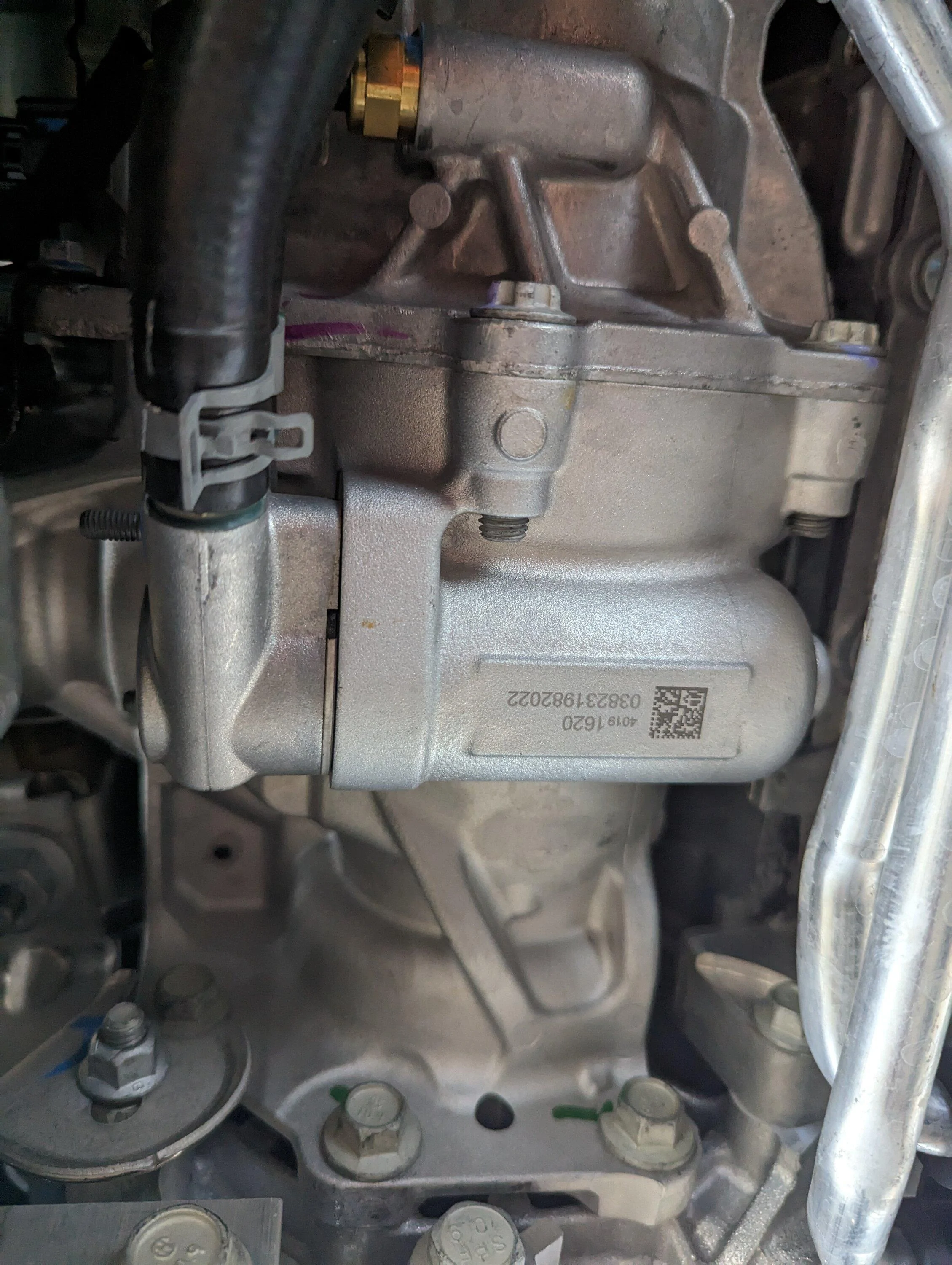

The RDU also looks slightly different but it appears to have a viable drain and fill plug just the same.
Ford Maverick Does tremor use different rear ptu fluid? PXL_20240203_184613905
Ford Maverick Does tremor use different rear ptu fluid? PXL_20240203_184606626
