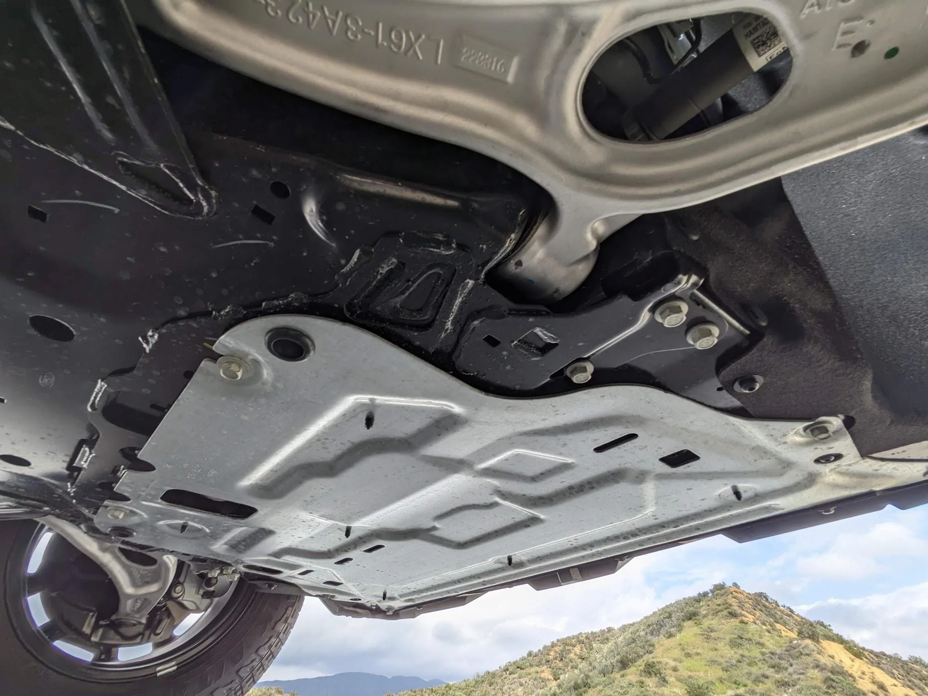

I think the FX4 has a metal panel in front of the skid plate that is under the engine, But the tremor does not have this. The tremor starts sloping up to the bumper right at the end of the skid plate. The filter on the fx4 is behind the panel, so on the Tremor is it under the skid or behind the bumper?

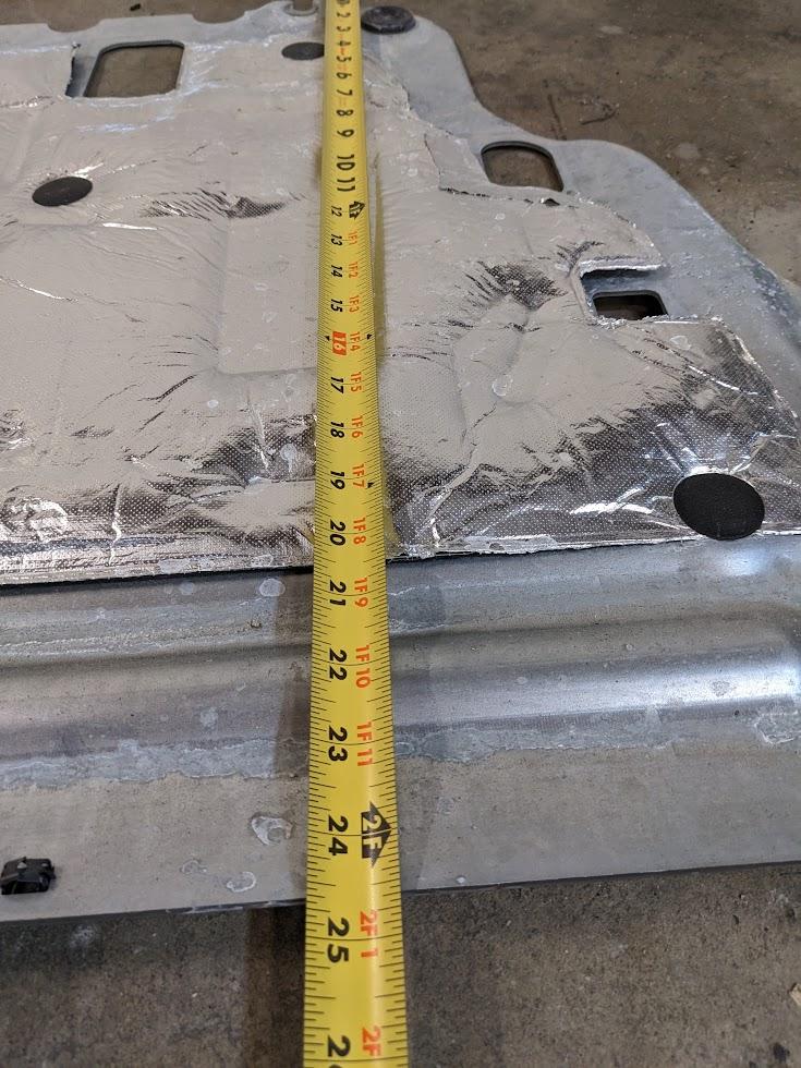

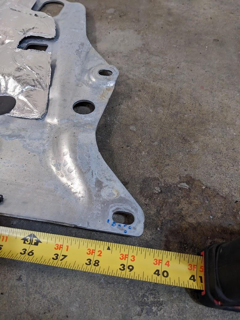

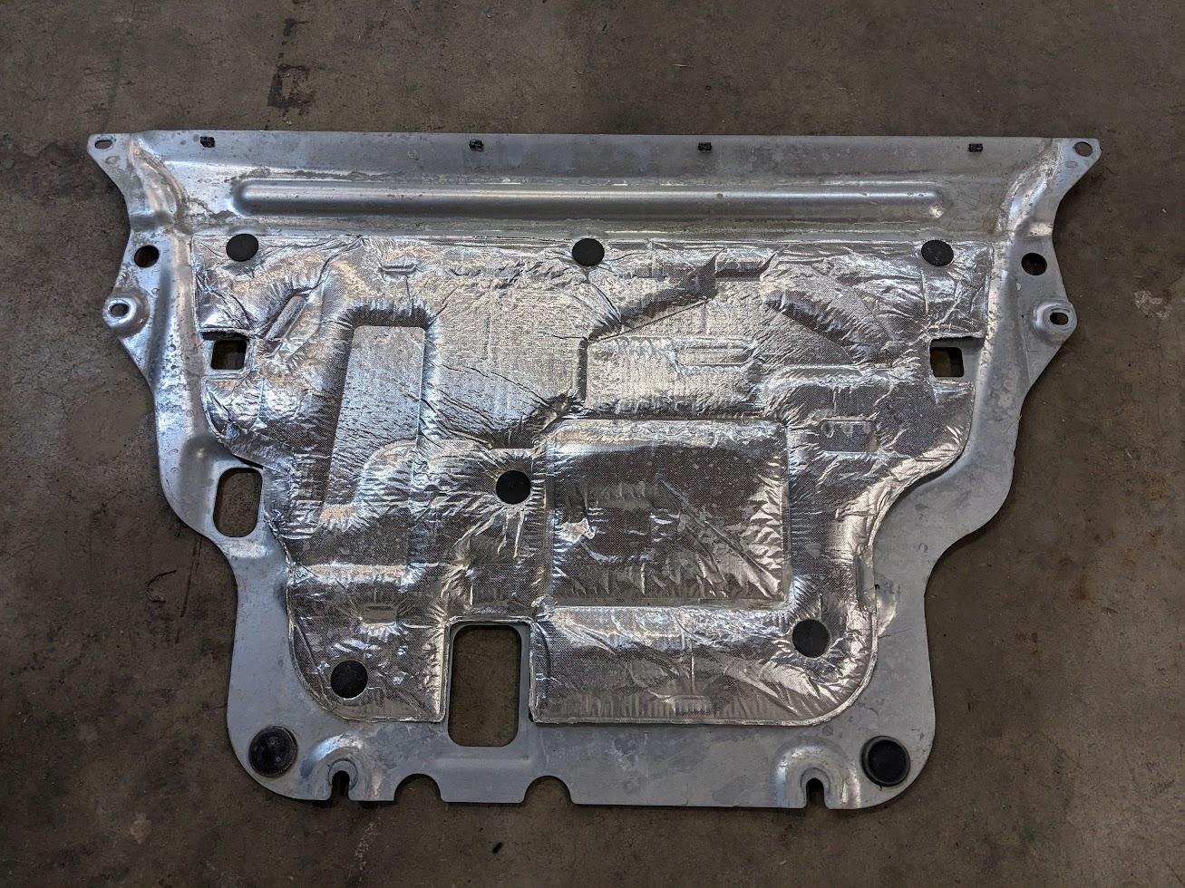

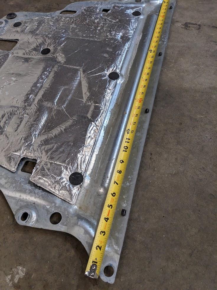

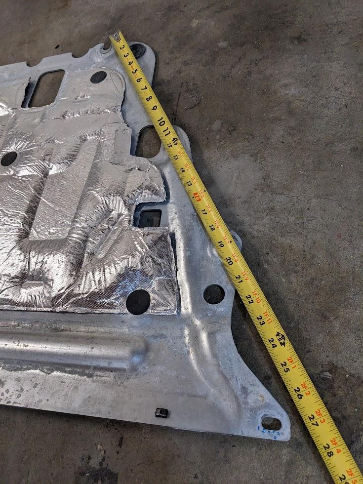

Some more photos of the skid plate and measurements.
Ford Maverick Tremor Skid Plate is different than FX4 (photos) skid
The slots are at the back of the skid plate. The front is at the top of the photo. The 4 T30 Torx go at the front to hold the bottom of the bumper under the skid plate.
Ford Maverick Tremor Skid Plate is different than FX4 (photos) wide 2
Just over 39" wide at the front
Ford Maverick Tremor Skid Plate is different than FX4 (photos) length
from back to front 24.5"
Ford Maverick Tremor Skid Plate is different than FX4 (photos) side
The side

Looks like the real deal.
A very robust galvanized steel plate.
I wonder what the Ford dealer cost will be?
