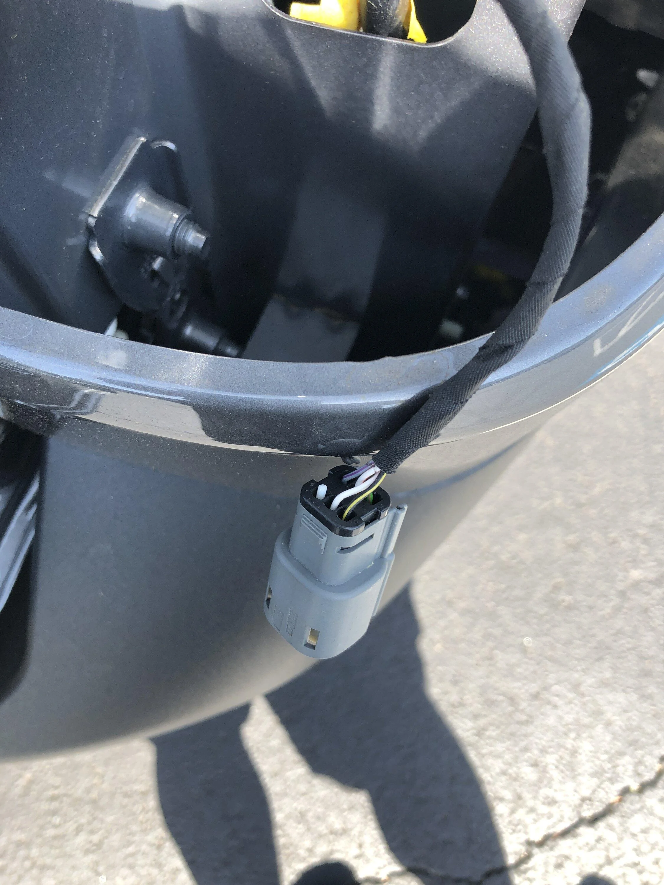

Does anyone know the wiring diagram for the tail lights ?

Too many wires in the clip and I’m trying to figure out which is signal and which is brake light
Ford Maverick Does anyone know the wiring diagram for the tail lights ? IMG_8524
Ford Maverick Does anyone know the wiring diagram for the tail lights ? IMG_8526

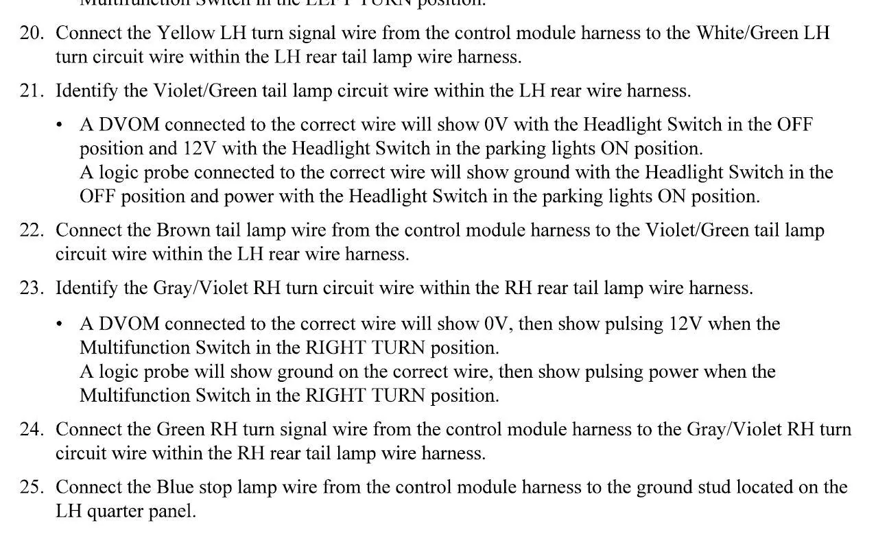

see below,,,,, Violet/green for taillight circuit
HRG
Ford Maverick Does anyone know the wiring diagram for the tail lights ? Mav lamp wire colors
