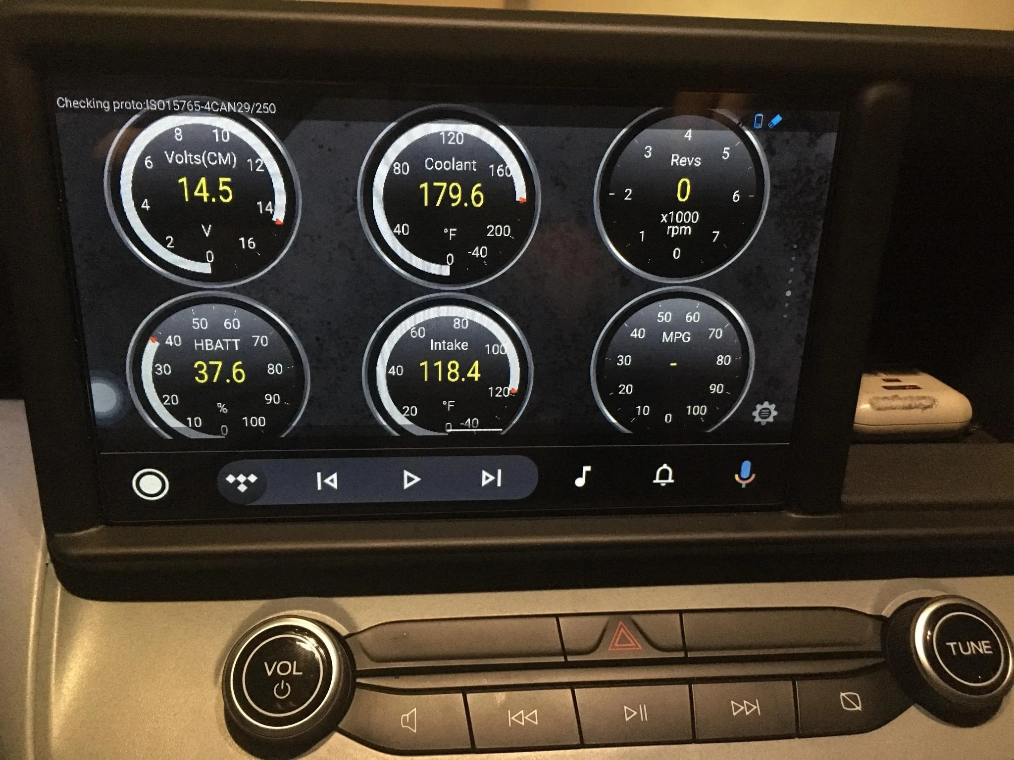

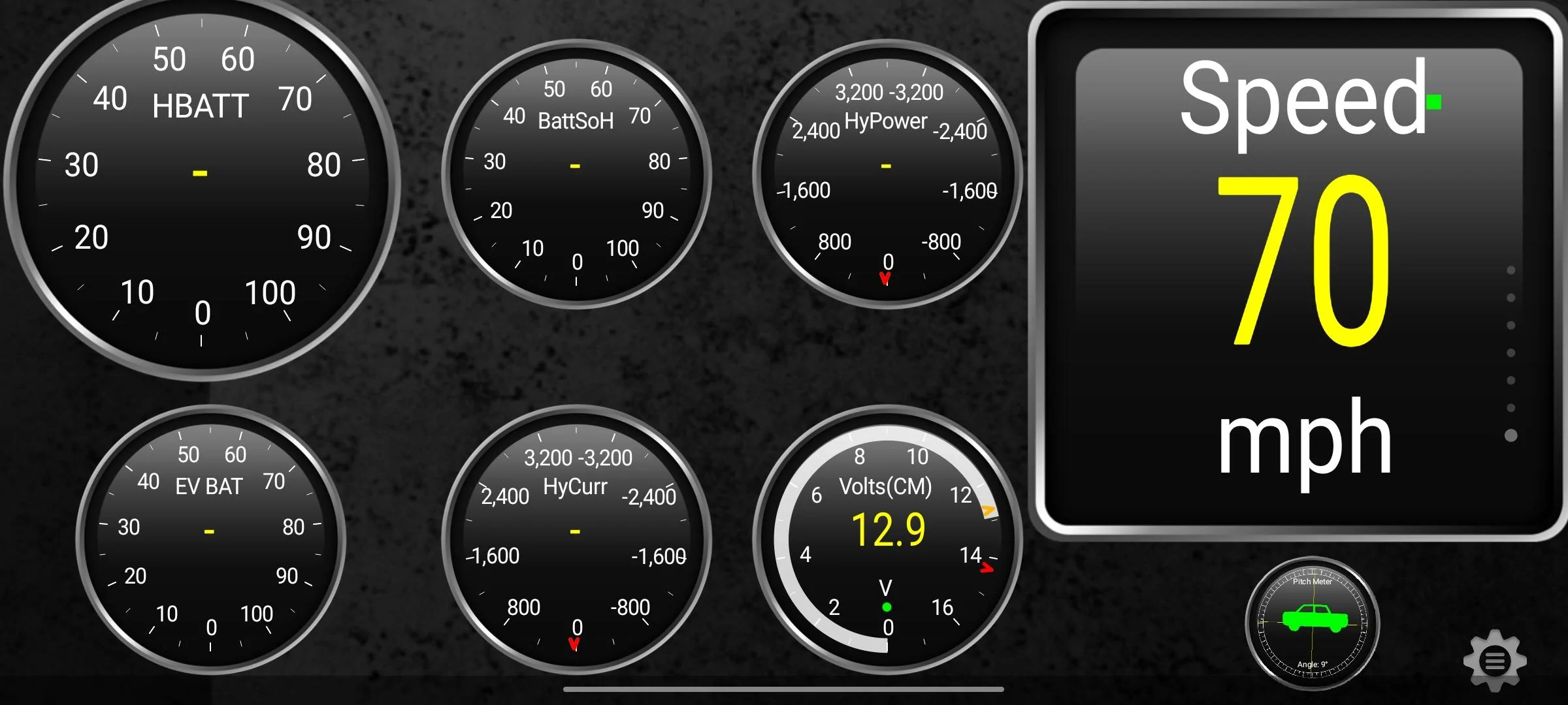

Torque Pro Android app works well with a cheap Bluetooth OBD2 adapter.
Gullzway, did you have to do anything special for Torque Pro to read the Hybrid Battery metrics?
No. Make sure both connections are checked on the status screen, if not try exiting and opening the app back up.
If that doesn't work your OBD2 reader may not be compatible. What kind do you have?
I use this one with torque.
Panlong OBD2 Scanner Bluetooth OBDII Diagnostic Tool Car Code Reader Turn Off Check Engine Light Support Android Torque App https://a.co/d/9rwKevY

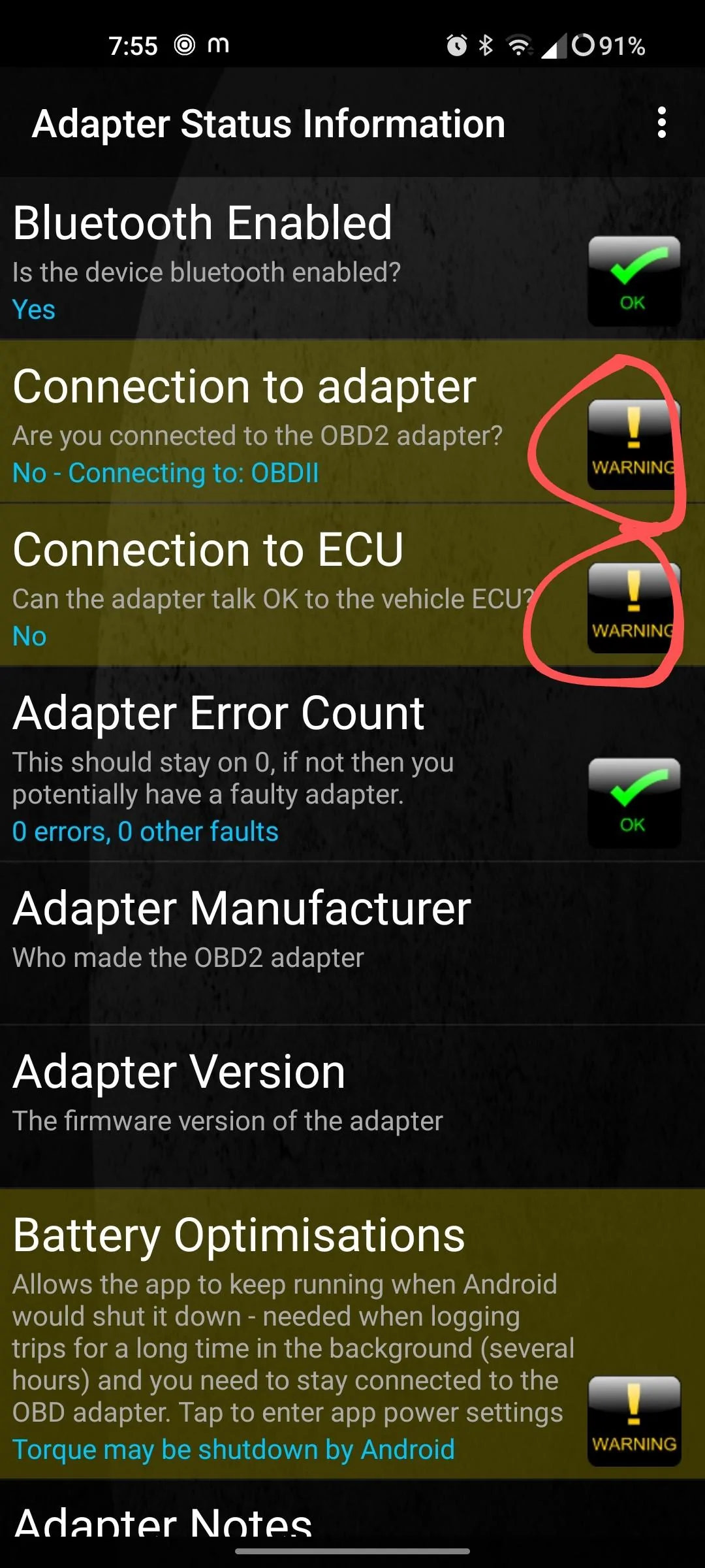

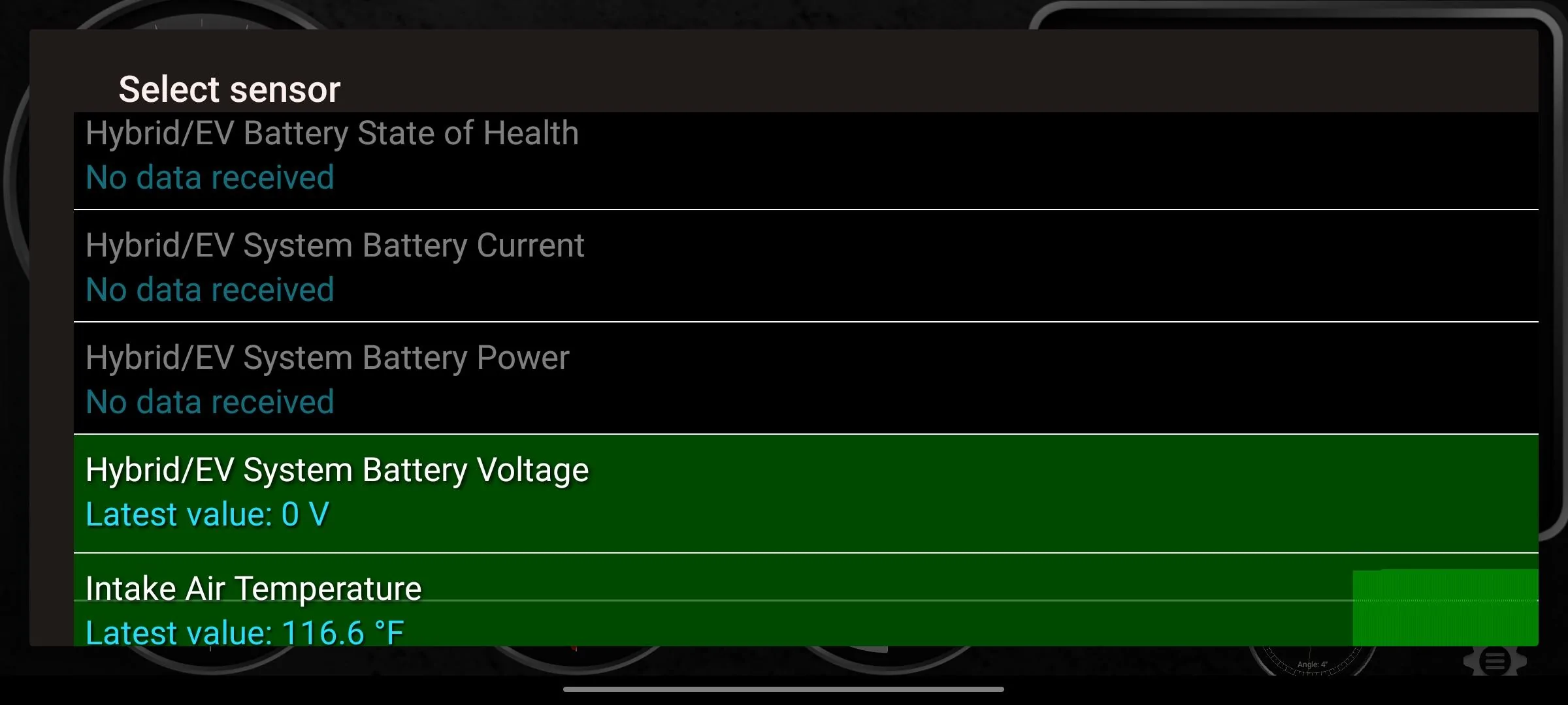

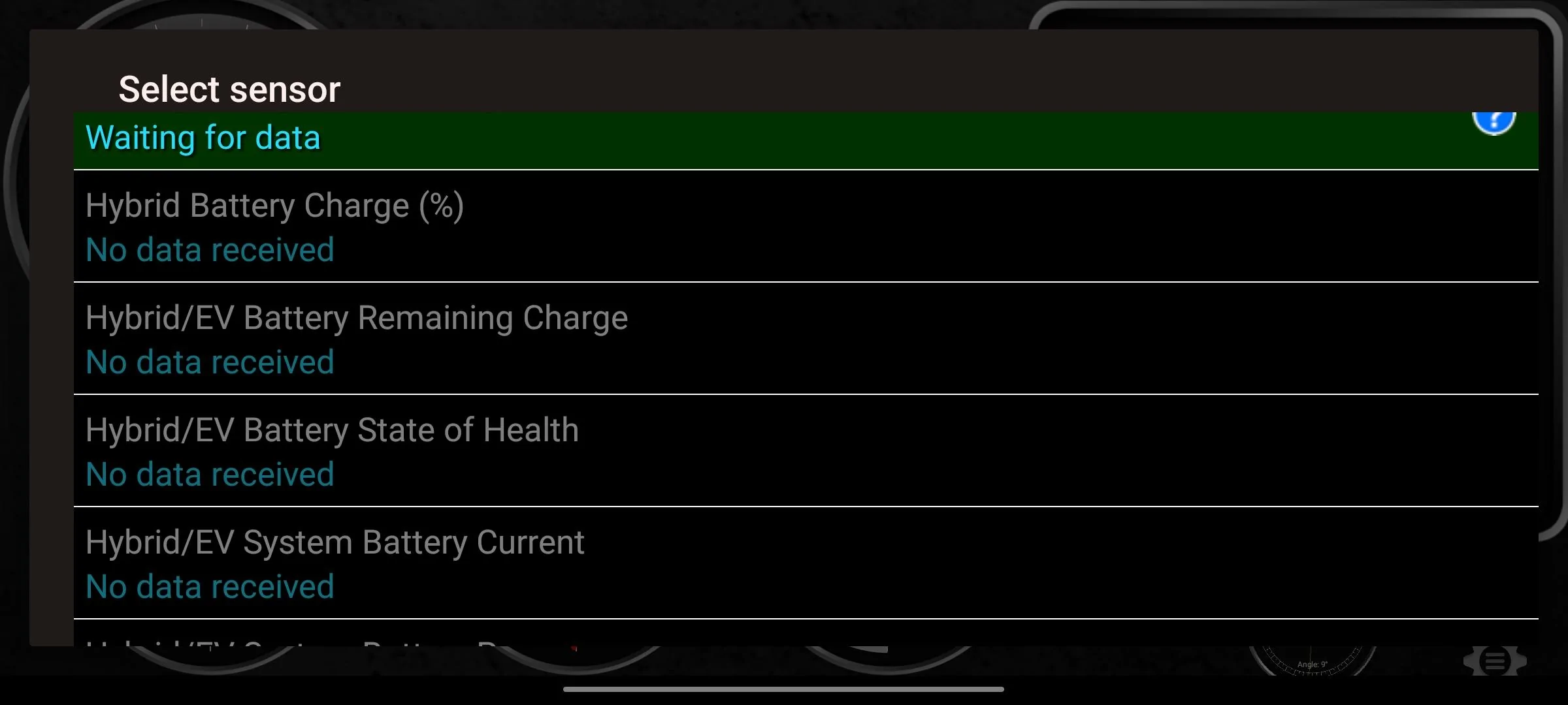

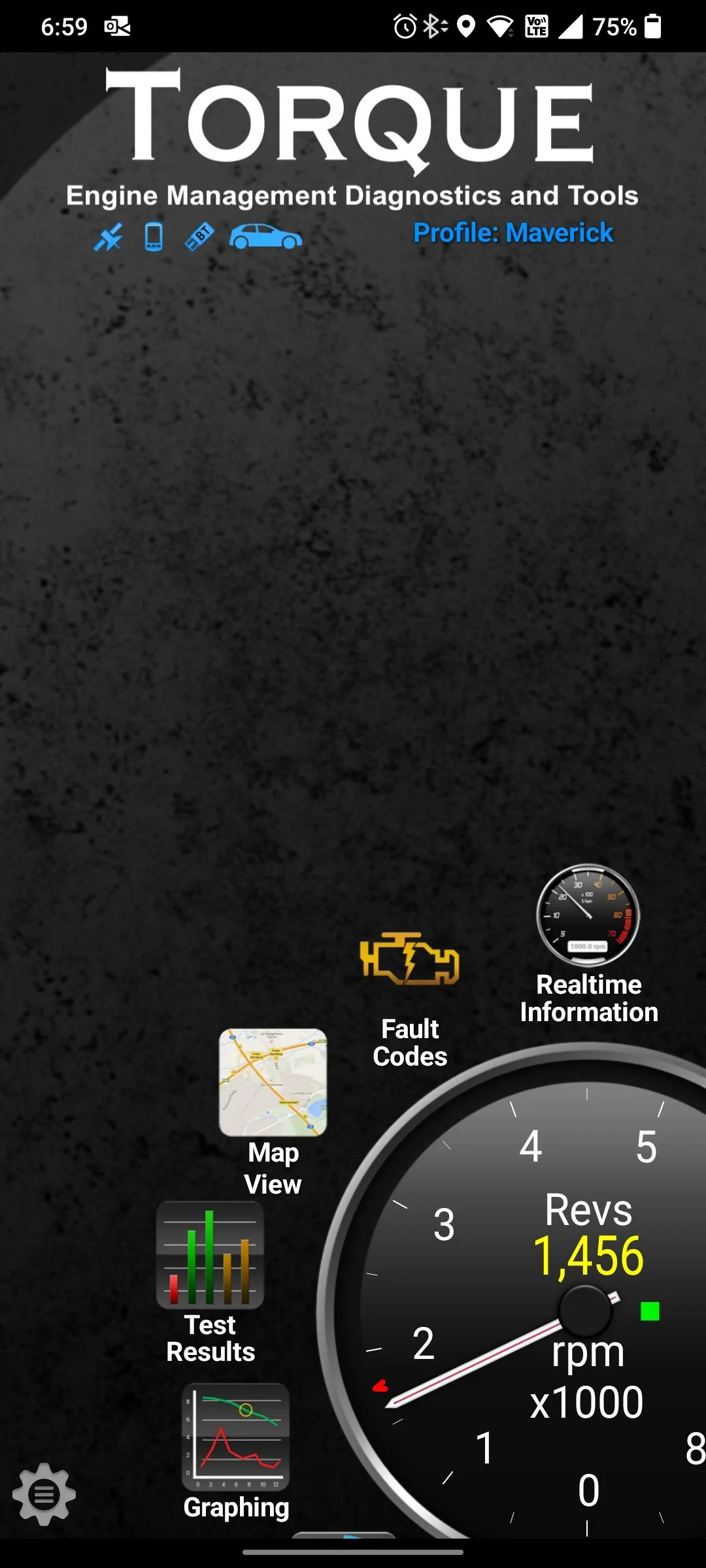

I am using this one with my 2023 XLT:
https://amzn.to/3DbgQoK
It appears to read a lot of the OBD2 info, but I think I will go ahead and order the module you have as well and test again.

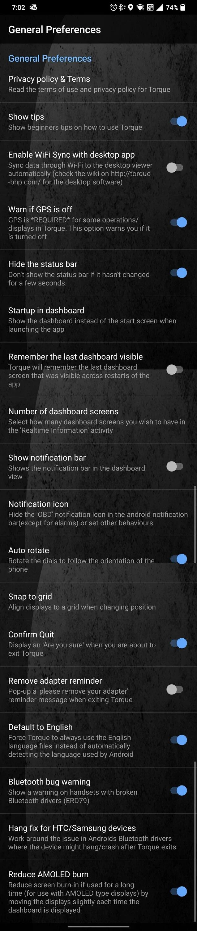

I am not sure what you mean by 'Make sure both connections are checked'?

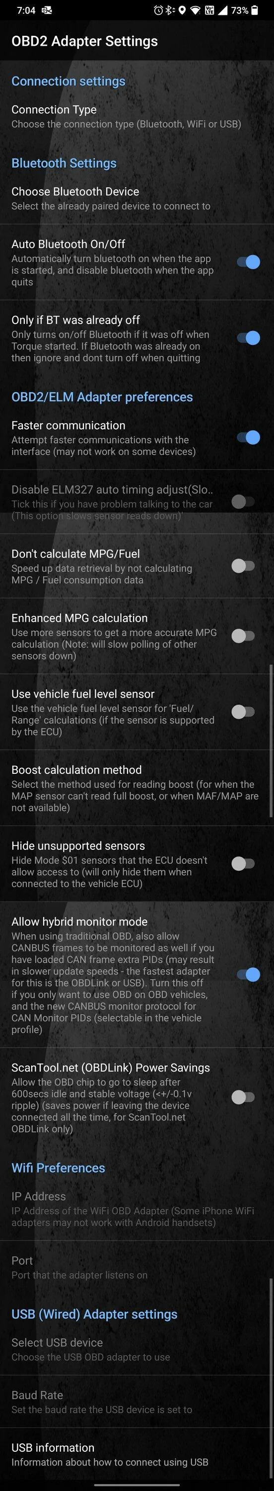

Here are my settings:
Thanks!

Under Adapter Status, both of these should have a green check mark.
