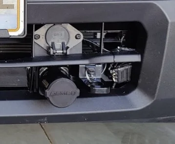

I'm nearly done with the install of a Demco baseplate on my 2024 Lariat Hybrid. Everything is going smoothly, especially with BradnChristine's helpful posts. But since Demco doesn't provide a good mounting solution for the 6-pin connection to my RV, I'm looking for suggestions especially with pictures. If you have installed the Demco baseplate and the 6-pin connector and brake-away switch, I'd appreciate your help.

I used a smaller plate from Amazon...less than $10. I mounted it hole-side up (as opposed to hanging down) and the flat metal lip us forward and tucked into the grill slot (Lariat). It is held there with 3m VHB tape, and I hold the sides of it when I push in the plug. Pulling out the plug is easy, as the lip holds it from pulling out.
When I put the 6-pin in, I had already wired the taillights and had brought the wires forward. I terminated the light wires and the charge wire into a 4-pin plug (the lights and ground) and 1/2 of a 2-pin plug, terminated to the right of the 6-pin. Then I took the rubber boot that came wit the 6-pin socket and cut it down. I made the wires bent and come out the right side of the back of the socket at a 90 degree angle. Then i taped the rubber over the back of the socket to keep it all from rubbing anything...and then I connected the plugs. Here's the end result. Demco was ZERO help in how to do this...we are on our own.
Ford Maverick Demco Baseplate Wiring for flat towing finished electric closeu

How did you attach your breakaway switch?
