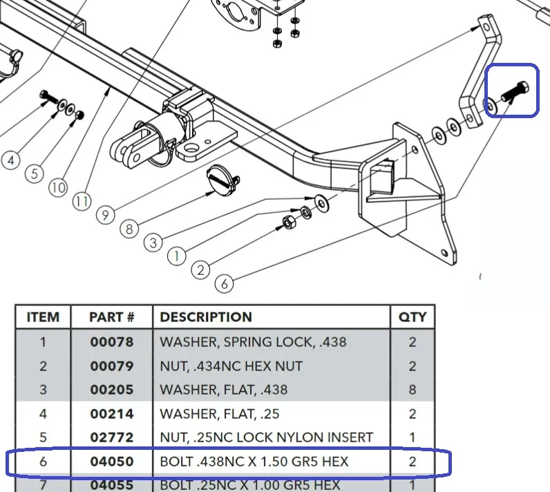

Ford Maverick Demco 2024 baseplate failures IMG_5833
I’m looking at going with the Blue Ox baseplate based on some additional feedback that others with 2025 Mavericks have given, but haven’t decided yet and plan to quiz the technicians at etrailer prior to making a final decision.
