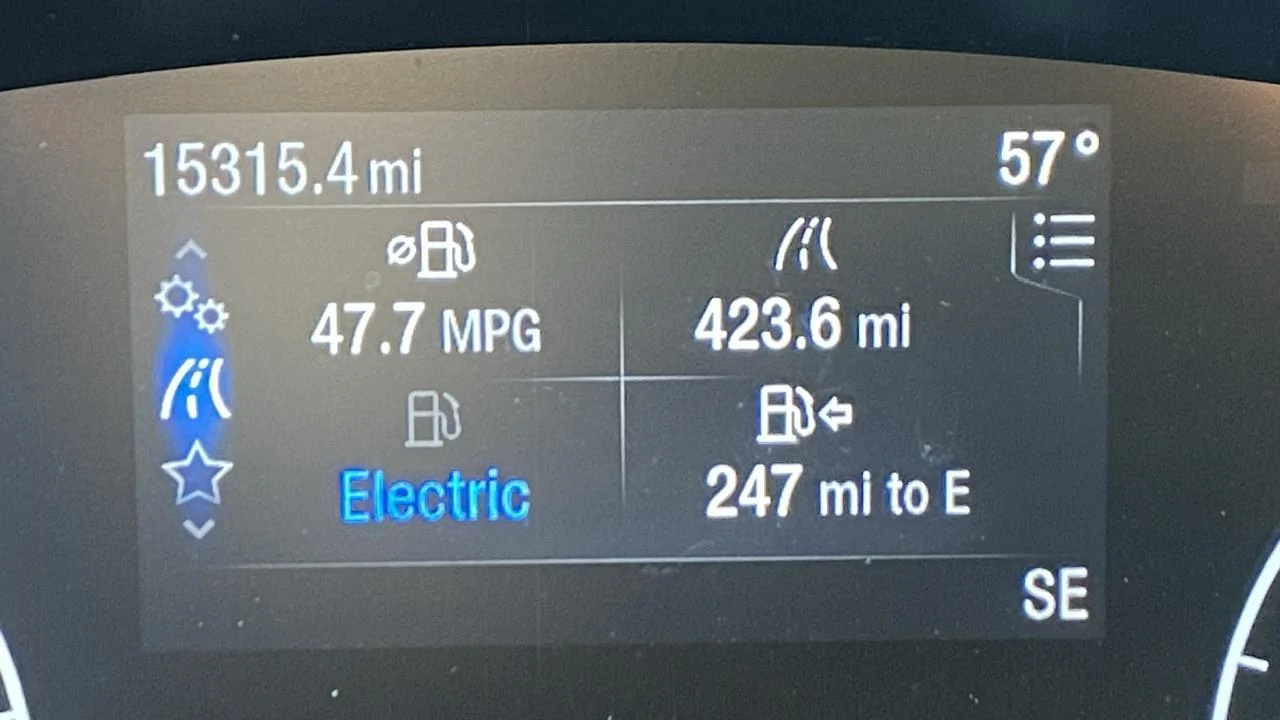

Ford Maverick 2024 Hybrids IMG_8535
YOU DO 420 MILES DIVIDED BY GALLONS USED.
I've used 8.88 gallons.
My needle (sorry I missed it in the shot) is showing 3/8 Full.
I calibrated my average fuel economy screen using engineer test mode so it matches pumped gas very closely now.
I traveled 423.6 miles so far, after refueling.
423.6 mikes divided by 8.88 gallons = 47.7 MPG.
Miles traveled divided by gallons used is all you need to do. It is not different than any other car.
Having an electric battery pack and an electric motor is not part of the equation. Electric miles are not part of the equation. Think of electric miles as driving downhill. Do you deduct downhill miles from your other cars?
You shouldn't and I don't think you do. Because how did you get uphill before driving downhill? Unless you purchased the vehicle on top of that hill, you had to burn twice the gas to go up, then had great gas mileage going downhill, and overall; you had a normal MPG for the round trip.
