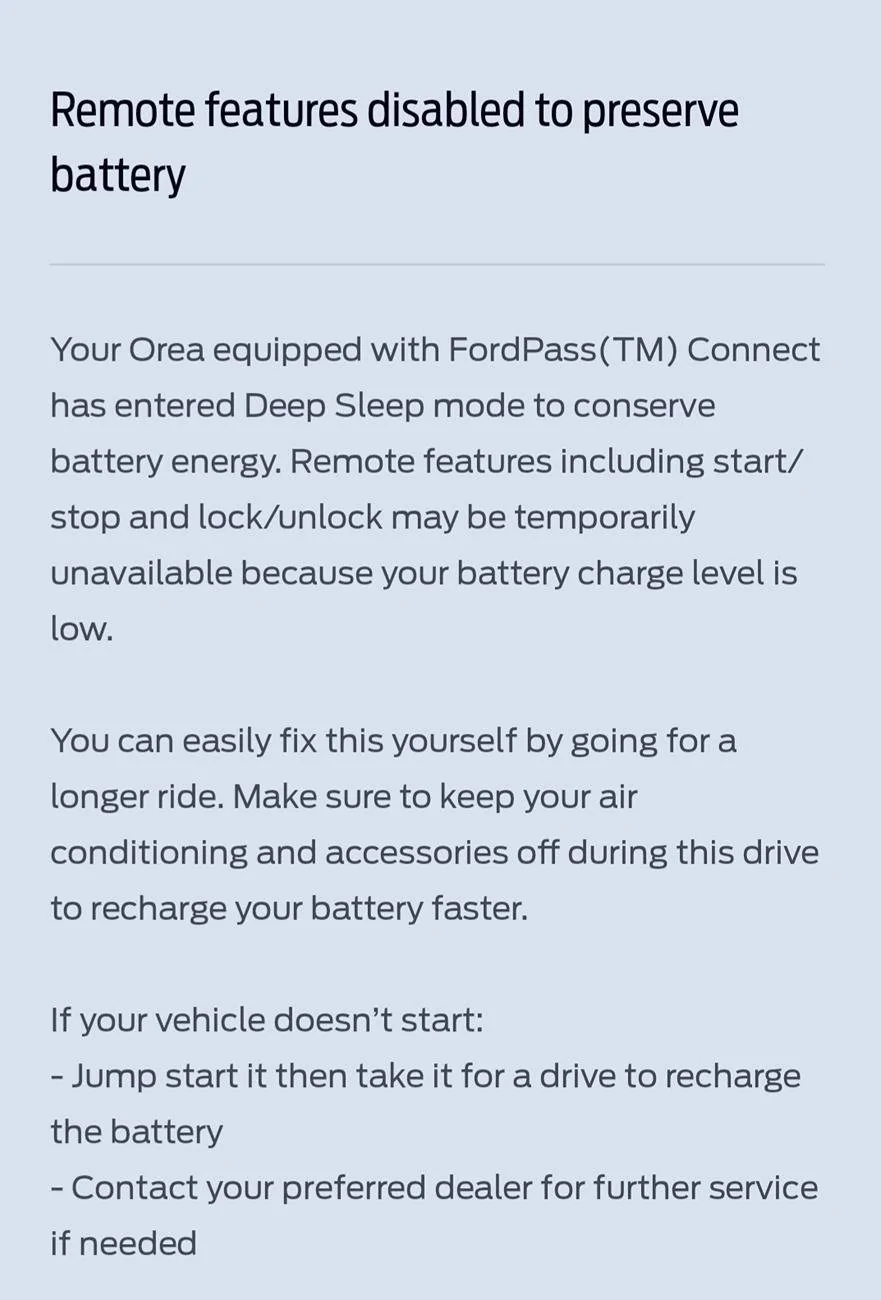

I have a 2.5 month old 2025 Ford Maverick XLT hybrid, with a Ford AGM 12v battery. This evening my Ford app delivered a Deep Sleep notice.
I went to the garage and was able to start up with no problems. My OBD2 software said the 12v state of charge was at 42%, which is typical over time.
Took the truck for a half mile drive, SoC went up to 48%.
Not sure what to think about this warning... Thoughts?

So much confusion on Deep Sleep warning.
Doesn't mean the truck won't start.
Means remote features have been disabled - specifically the modem, so as to remove a potential drain because system has no idea how much longer you'll not be starting the truck, or battery could drop too low to start it to charge.
<9.5 V, <50% SOC, 14 days no start. (and the 50% doesn't seem to be accurate anymore)
Battery Saver features usually kick in earlier and lights start turning off sooner and sooner.
Same purpose. I believe many have found at about 12.1 that starts.
Usually Battery Saver starts first, but right time of year may never notice.
So if Deep Sleep kicked in with no Battery Saver happening over some days - you may have had an issue dropping the battery faster for that time period.
Modem with no AT&T signal, attempting to connect to upload final parking status, stuck in a loop?
AC system kept something running? - that's probably going to get ugly.
Other module stuck on attempting to do something?
