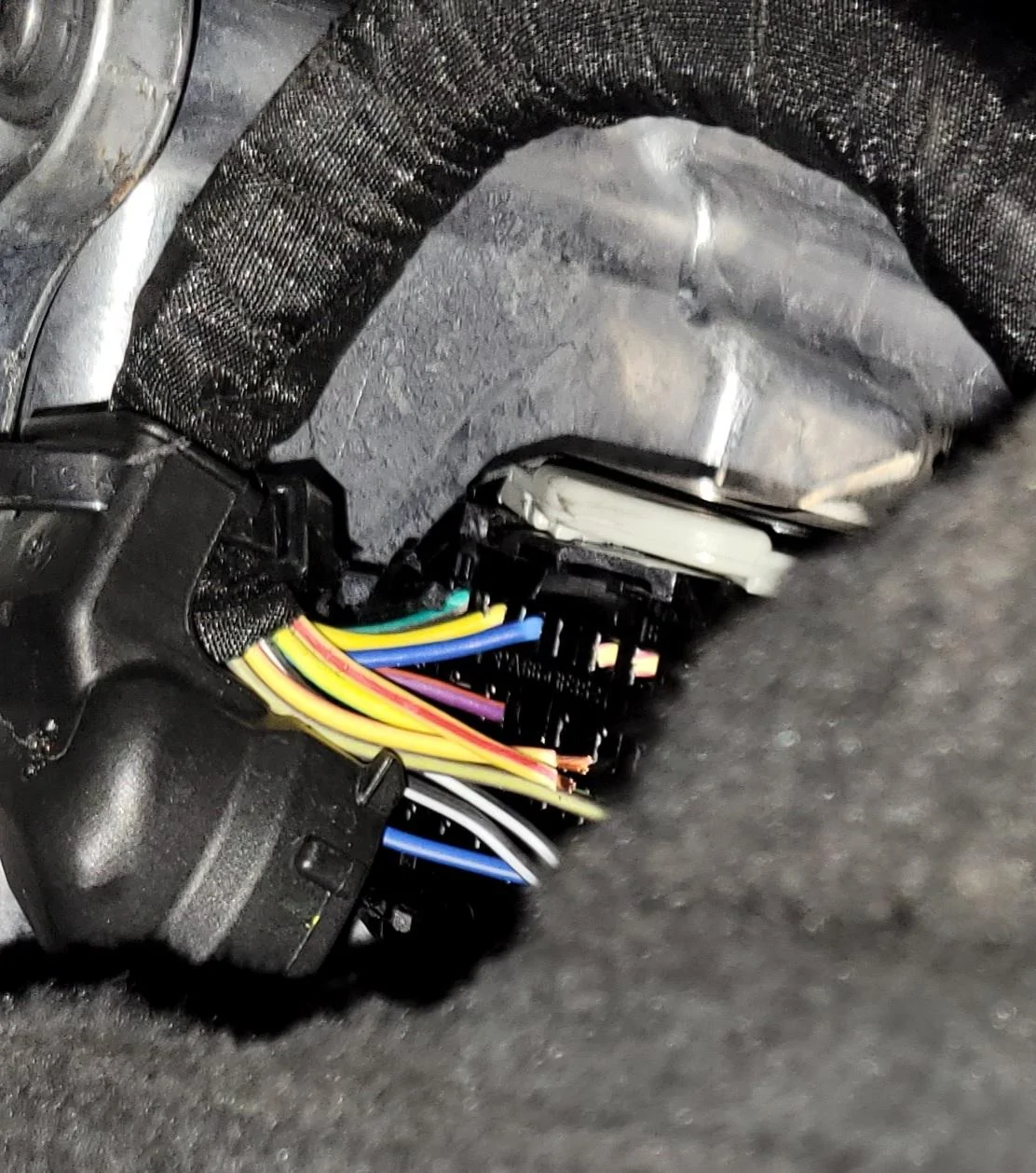

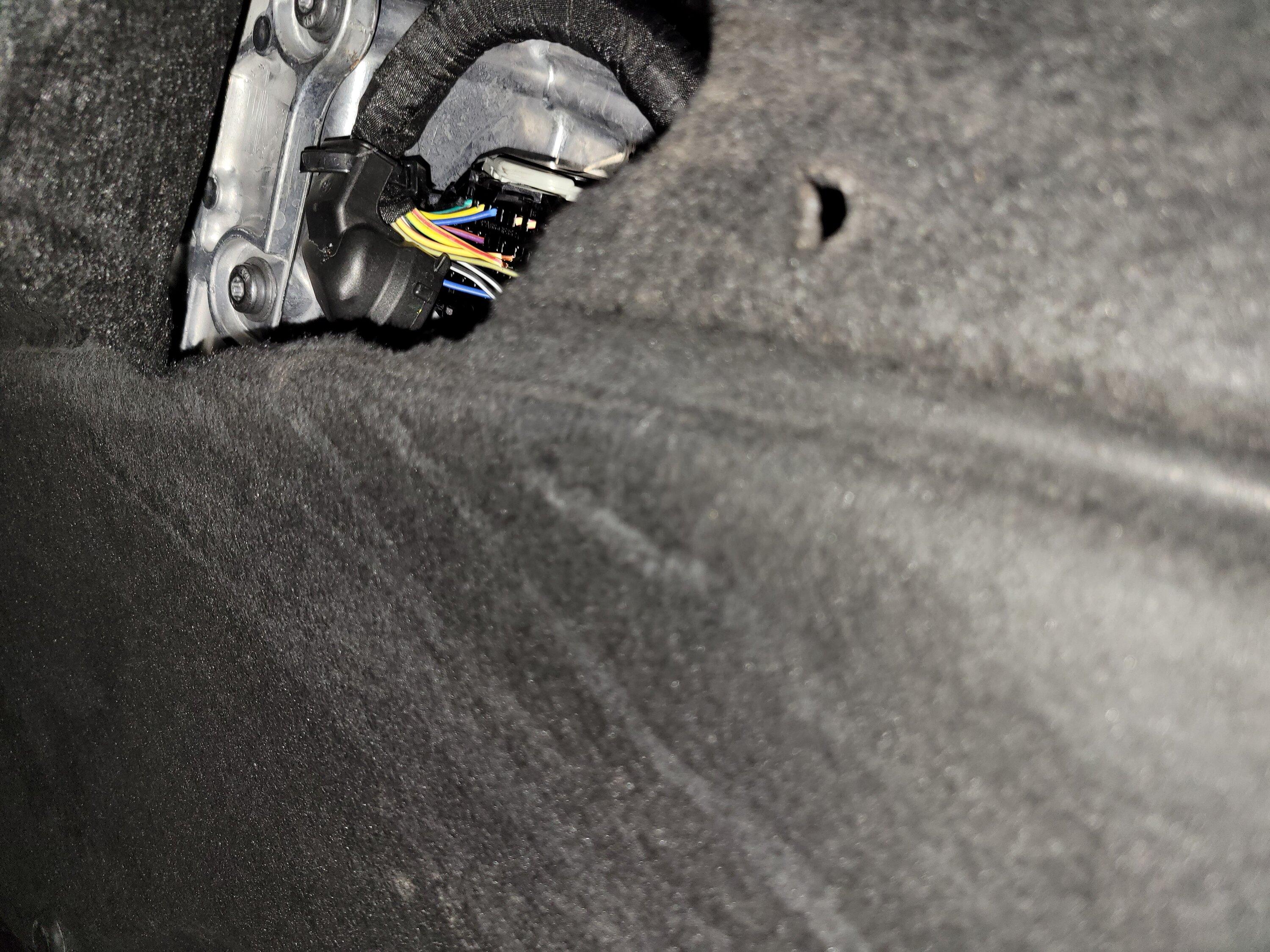

Damaged electrical hybrid system connector after pass over a piece of brick.
Carlos
Jan 5, 2022
Houston Texas
MaverickXLT 2023, BroncoSport 2022, Silverado 2020
Guys, I sadly report I was driving home last Wednesday 03/22 when suddenly a half piece of a brick appears on the road, I couldn't avoid take it with the front right tire, I heard a hitting noise under the passenger seat zone, I didn't give it relevance but 3 seconds later I got the warning "Stop safely now", and "Check hybrid system" or similar. I stopped in the next gas station and the Maverick dead. Cause: The stu**d brick damaged the electrical conector. There is a cover but is too thick, didn't help the brick make a hoke on it. I asked for towing to take the truck to the dealer and they confirmed my theory, the spares are ordered, I hope don't take so long. Advices fellows?

This is at least the second report we have had of something very important being damaged when it busted through that flimsy underbody protector.

I believe this generally falls under "Comprehensive" on your insurance...just like hitting a deer. May or may not be worth your deductible.

It's not a skid plate and has never been presented as such. It is not the problem here.
It protects against fluids being splashed up off the road and provides better aerodynamics, that's all it's responsible for.
Potentially fragile exposed wiring is the real problem, and anything can be damaged with a hard enough impact.

Advice? Don't drive over a brick! Seriously, hope it gets repaired quickly.
So far the estimated for parts + labor exceeds by $150 my deductible, I'm starting to file mi claim in case this goes higher.
