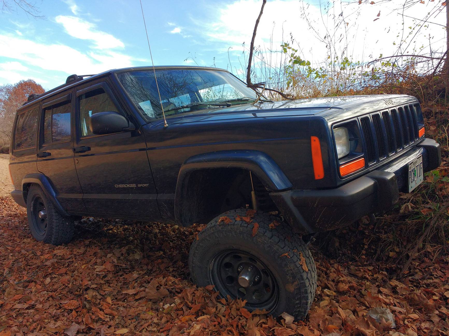

I have a unibody Jeep XJ (Cherokee) that is frequently put through extreme flex situations off-road and has never had a cracked windshield. That chassis was first manufactured in 1984.
Thanks for info. I had a Jeep like the one picture. Cherokee Country. Windshield was replaced twice. Drove up same driveway the Maverick goes up. LoL.
