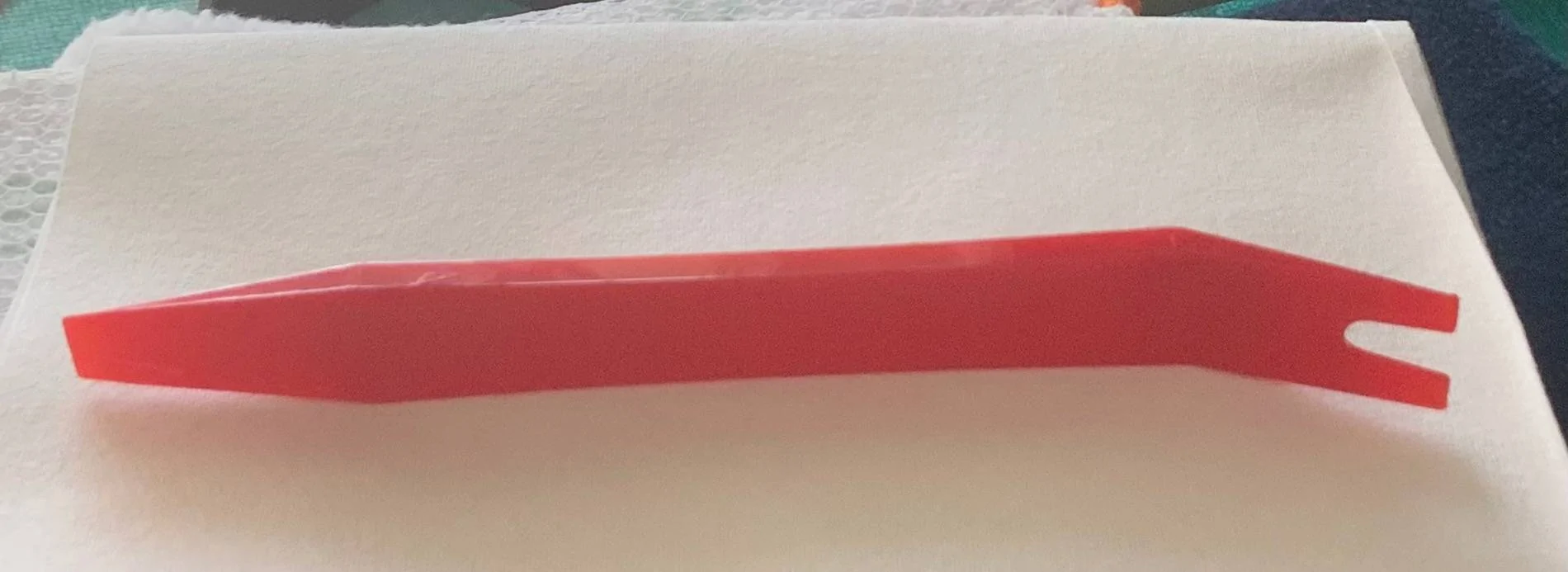

🤓 If I had something to get off, like the little lights on either side of the front lower fenders, or the fender vents I used this.
to edit this it was kind of easy. I just sat on the ground next to the car and popped those little lights right out. Put the new bulbs in put the lights back in place and everything works just fine.
