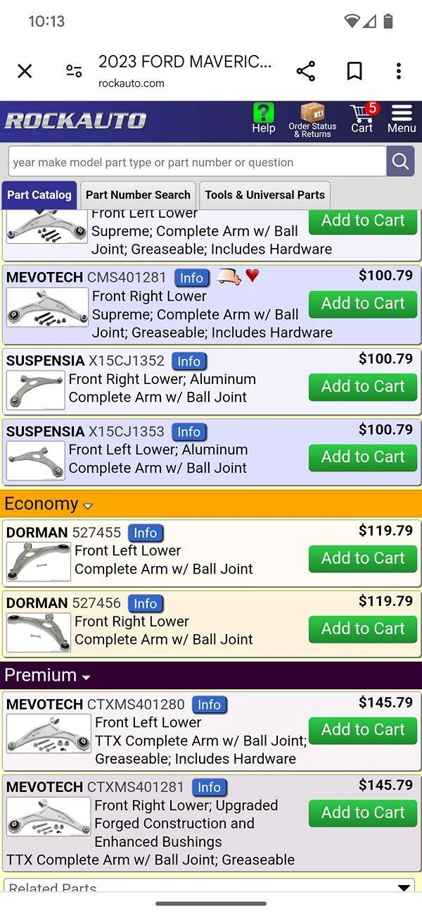

I can still detect a vibration after getting new axles installed.
It's only at higher speeds, and not during acceleration.
Tires are getting old, might also be worn control arm bushings???
I'm out of 3/36k warranty, so will be changing control arms myself when needed.
Thankfully, we've already got some decent aftermarket parts options...
Ford Maverick Control arm replacement after axle replacement? Screenshot_20250131-101314
