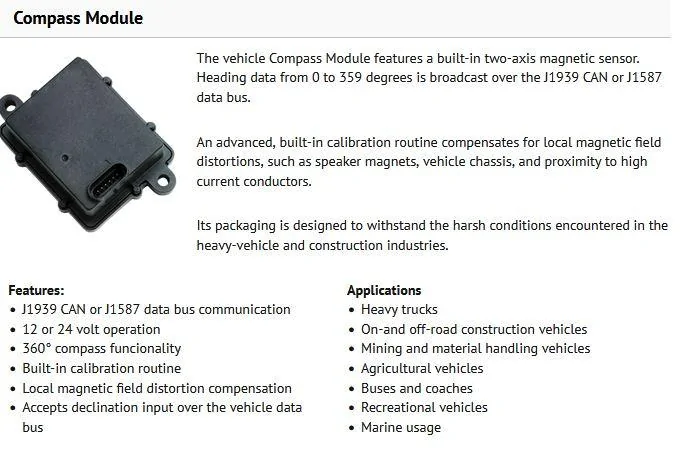

No idea where the compass module is, but any chance you have something in the cabin magnetic? Possibly skewing the compass?
No, nothing that would interfere. Need to go in for the battery cable recall. I’ll add that to the list for them to look at when I go in.

As far as I know compass location is provided by the GPS module.
Similar issue reported in the Sport forum required a new module in one case and software update in another.
Oh, then disregard my post. I thought it may have had a magnetic module, like this one (even though it claims to have magnetic field distortion compensation):
