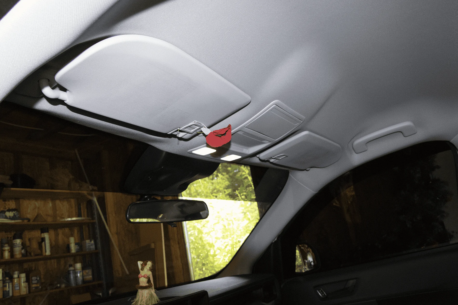

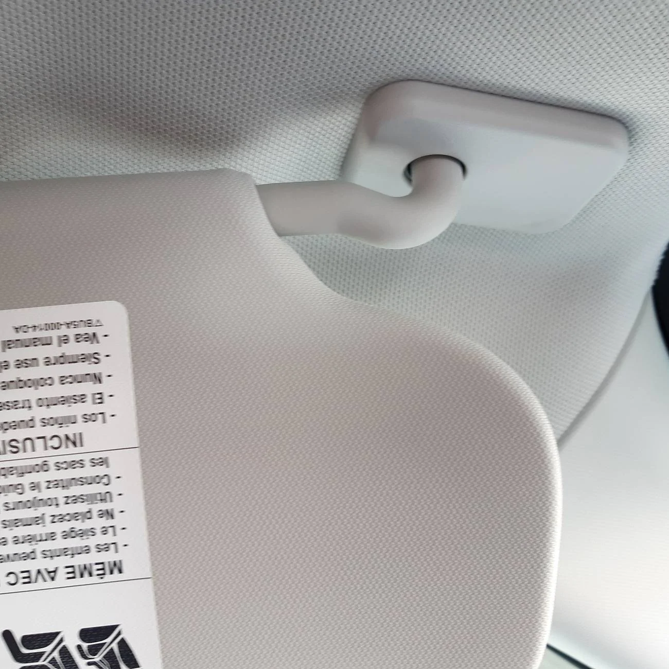

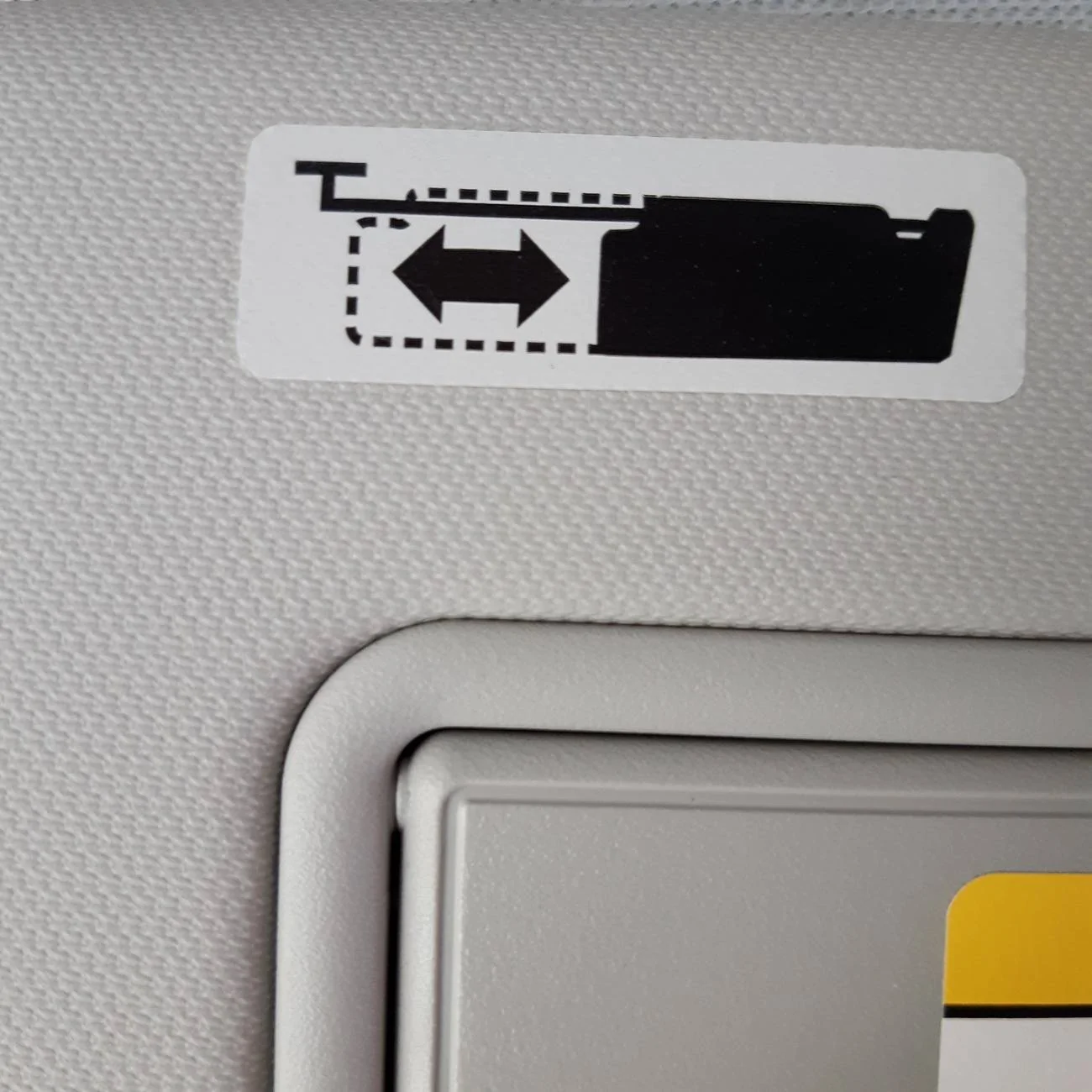

I don't know about replacing the visor, but I do wish the visor had an extension that can be pulled out when the visor is positioned to block sunlight on the driver side window. Just about every vehicle I've owned had a visor with extension. It does come in handy at times.
"ExpoGuy",

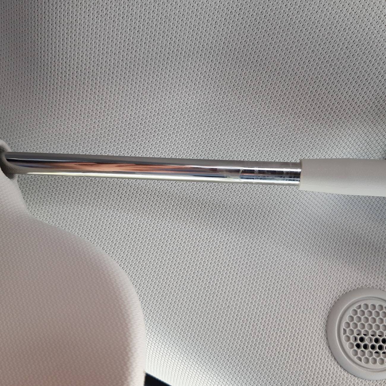

You do not state what trim package you have XL, XLT or Lariat.
My XLT has an extendable visor.
As I show in the pictures below.
Ford Maverick Clean Removal of Sun Visor Stickers? 20241103_130452
Ford Maverick Clean Removal of Sun Visor Stickers? 20241103_130500
Ford Maverick Clean Removal of Sun Visor Stickers? 20241103_130520

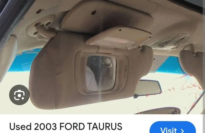

What was really nice was my Ford Taurus's had 4 windshield visors.
Both the driver and passenger had 2 visors. The main visor that you could pull down and swing over to the side window and then there was a second visor that you could pull down to the windshield.
Ford Maverick Clean Removal of Sun Visor Stickers? 20241103_131811

I believe he is talking about a sliding extension. Like a plastic piece that is inside the visor and extends it increasing the total width.
You’re showing the movable visor.

I know exactly what he's talking about. I also believe "ExpoGuy" may not know that the visors slide 6" or so.
The cars that I owned that had a insert piece that slid out, did not have a sliding visor.
Good luck finding a visor that has a sliding insert. Since they started making sliding visors, they've quit making the insert Style.

Thanks guys. I didn't know the visor slides. That's good.
I was looking at the visor at the dealership but didn't notice that it slides.
Every time I visit this site I learn something new.

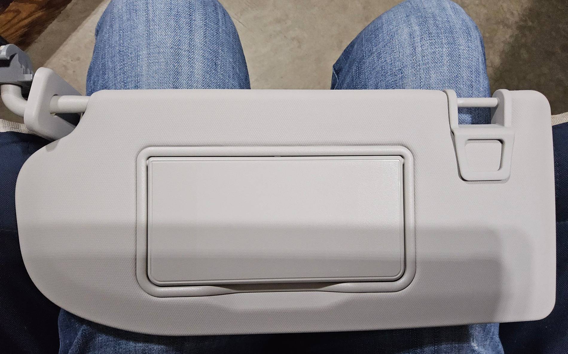

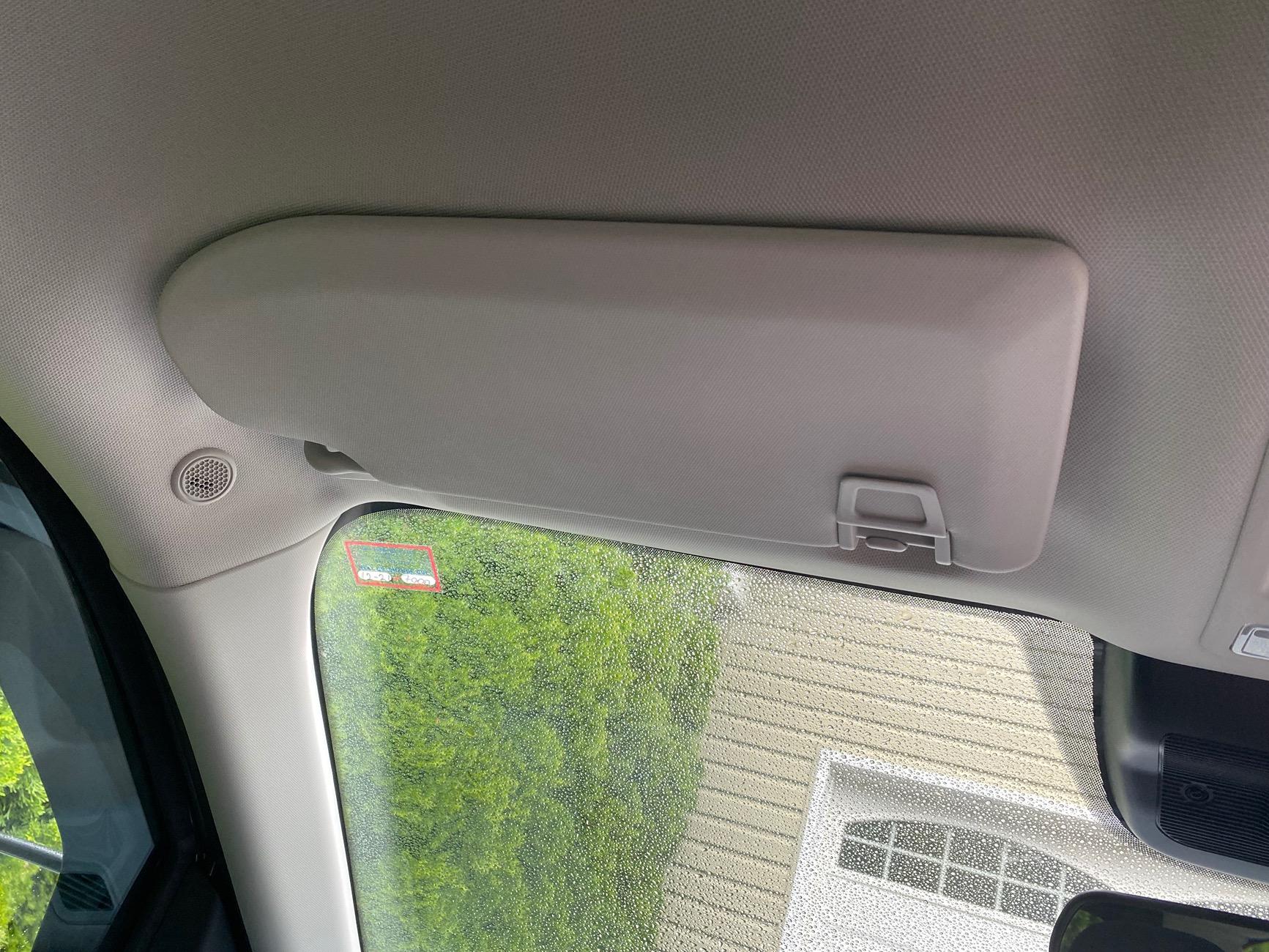

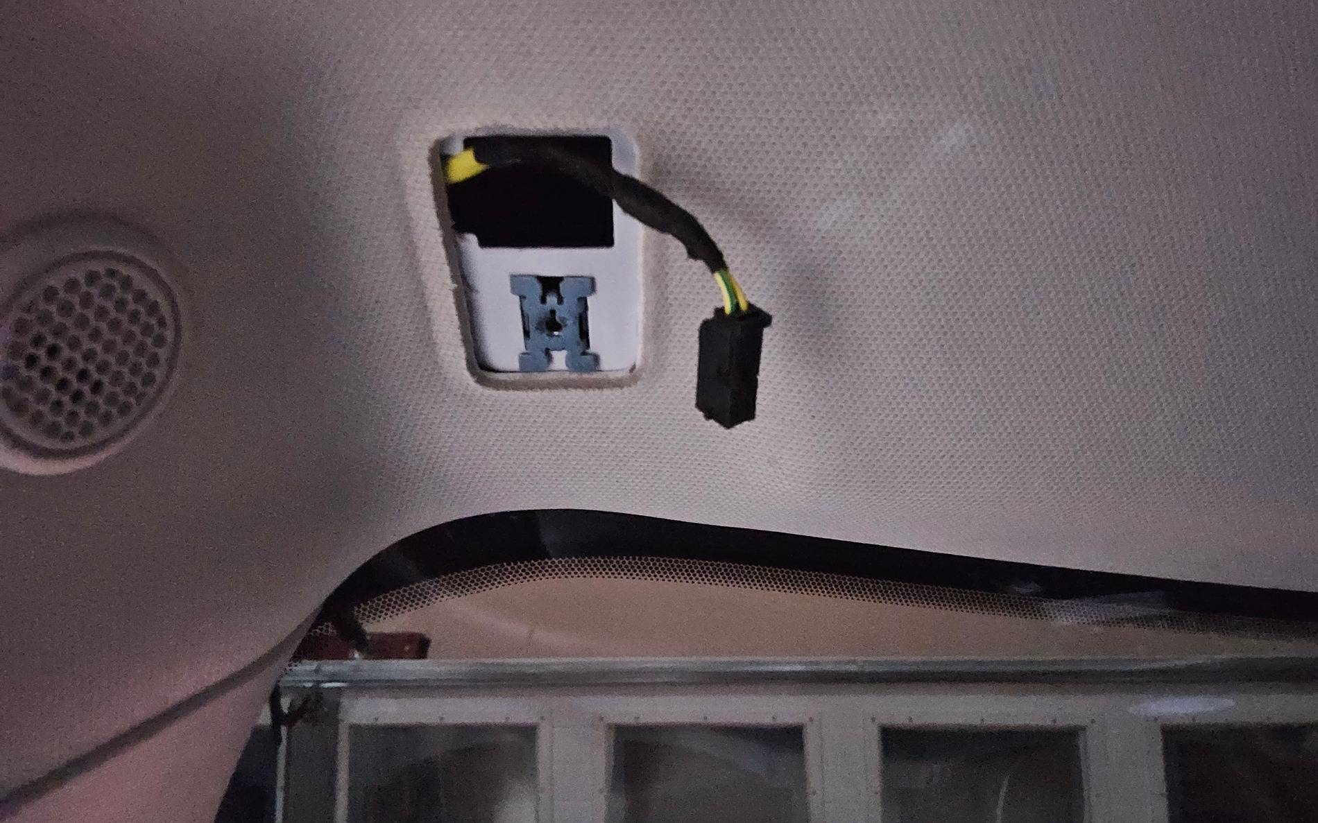

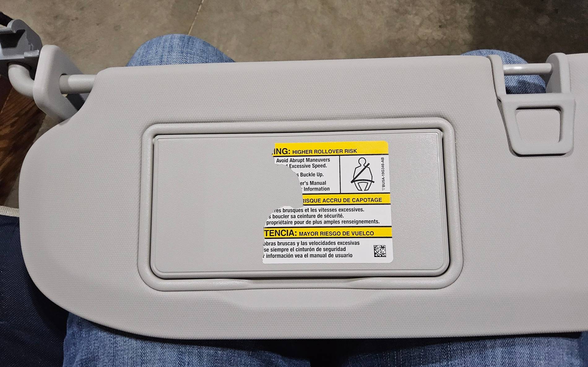

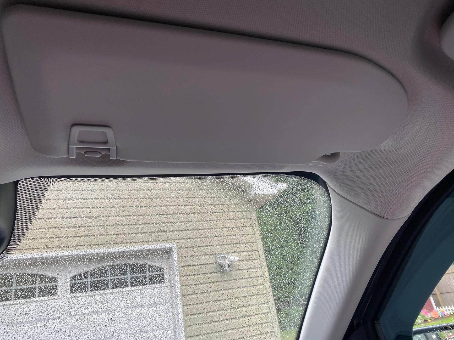

They are a pita... What cracks me up as there's an actual wiring harness in the headliner for the visor lights even though the XLT and XLs don't have them in 24.
So if you wanted to upgrade to the lariat visors with lights you can do it without having to run any wires, as the connectors are already there and connected to the visors.
Update: 15 minutes later, that was a pain in the ass...
At least removing them isn't bad. You pop the plastic cover off first from all four sides, then remove the t20 torx screw. Next put the visors in their original position and tilt them back towards the windshield and they slide out.
Ford Maverick Clean Removal of Sun Visor Stickers? 20241104_234457
Ford Maverick Clean Removal of Sun Visor Stickers? 20241104_234528
Ford Maverick Clean Removal of Sun Visor Stickers? 17307864229932927251407463628006
Ford Maverick Clean Removal of Sun Visor Stickers? 17307873447302944772992797789951
