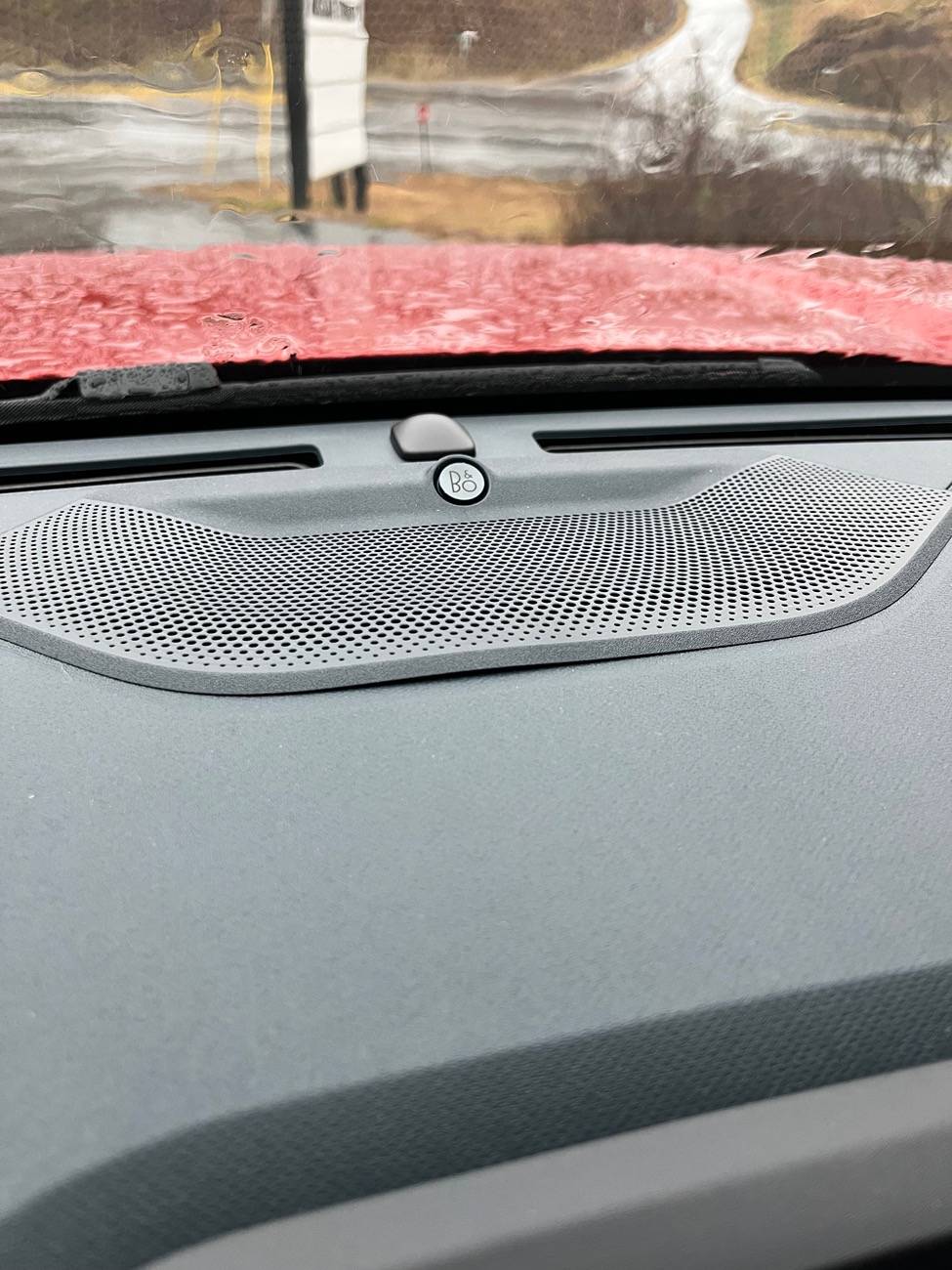

Center dash speaker warped already
Cherokee
Jan 3, 2025
49
3,697
6,900
dhaskit
Dann
Jan 2, 2025
420
1,172
2024 Maverick FX4 Lariat

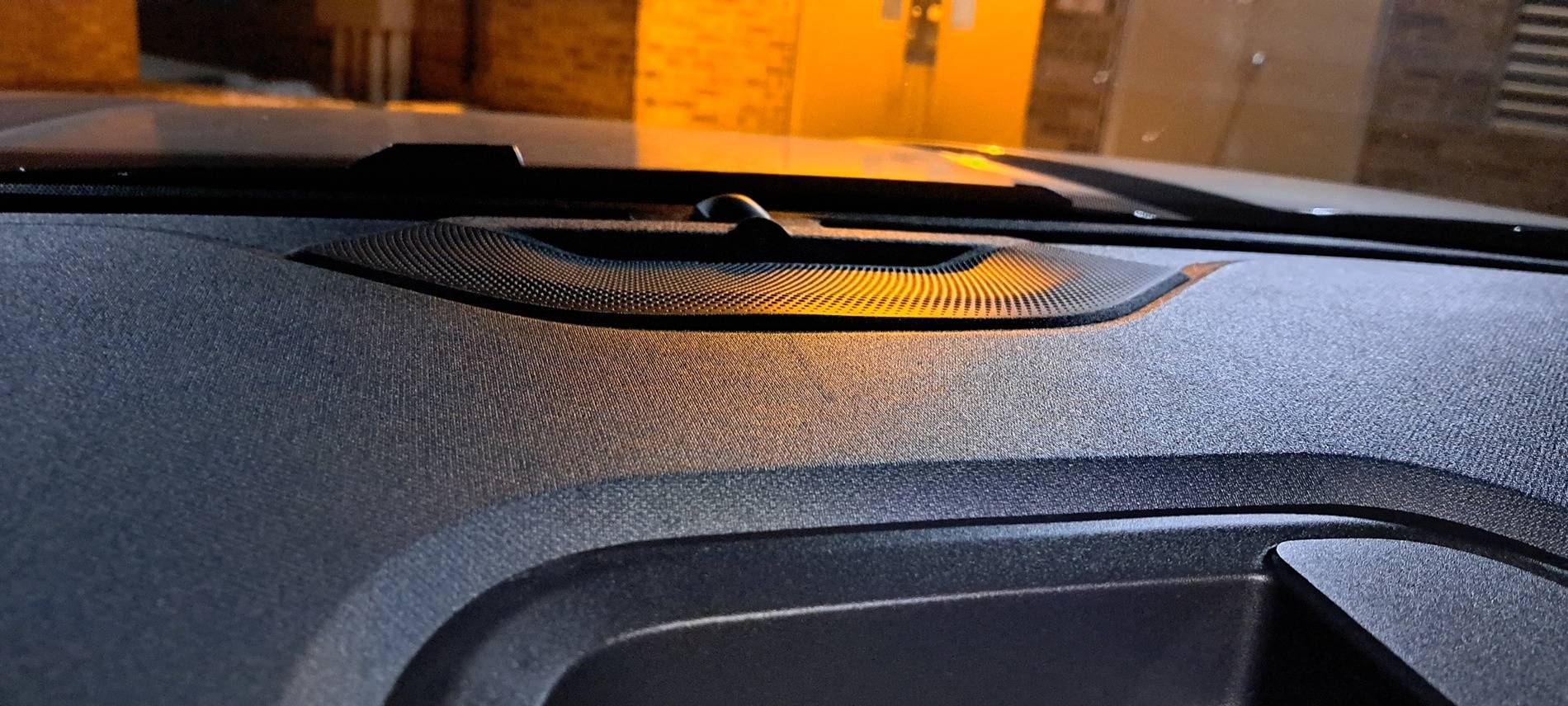

Yup, mine looked like that too when I took delivery.
Not a huge deal. A tiny bit (ie, 1 drop) of E6000 adhesive applied with a popsicle stick and put a weight on it for a couple of hours corrects the problem.
…or get it replaced under warranty with a new part that is likely to warp in the same way.
It’s not like the new part is any different or better somehow.
The choice is yours.
