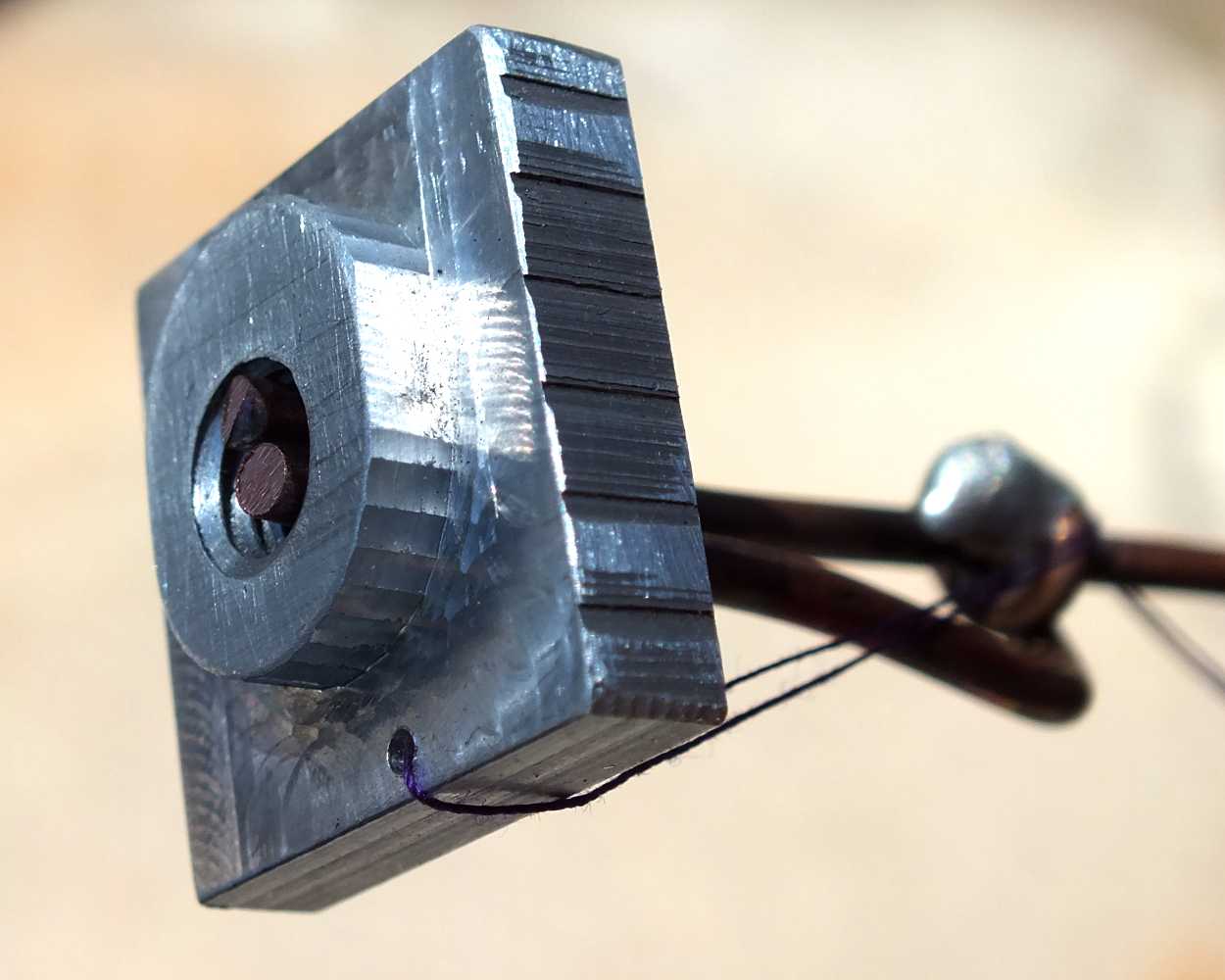

I made a custom nut for the tailgate damper from a scrap piece of aluminum, and made the oval raised section (shown here) a bit shorter than the hole in the tailgate so it could slide to align with the damper bracket screw. It has to be oblong to prevent spinning. I then used a fairly long piece of #12 scrap copper wire to place it. For insurance, i attached some thread to the nut so I could retrieve it when it fell off the wire inside the tailgate (which happened several times).

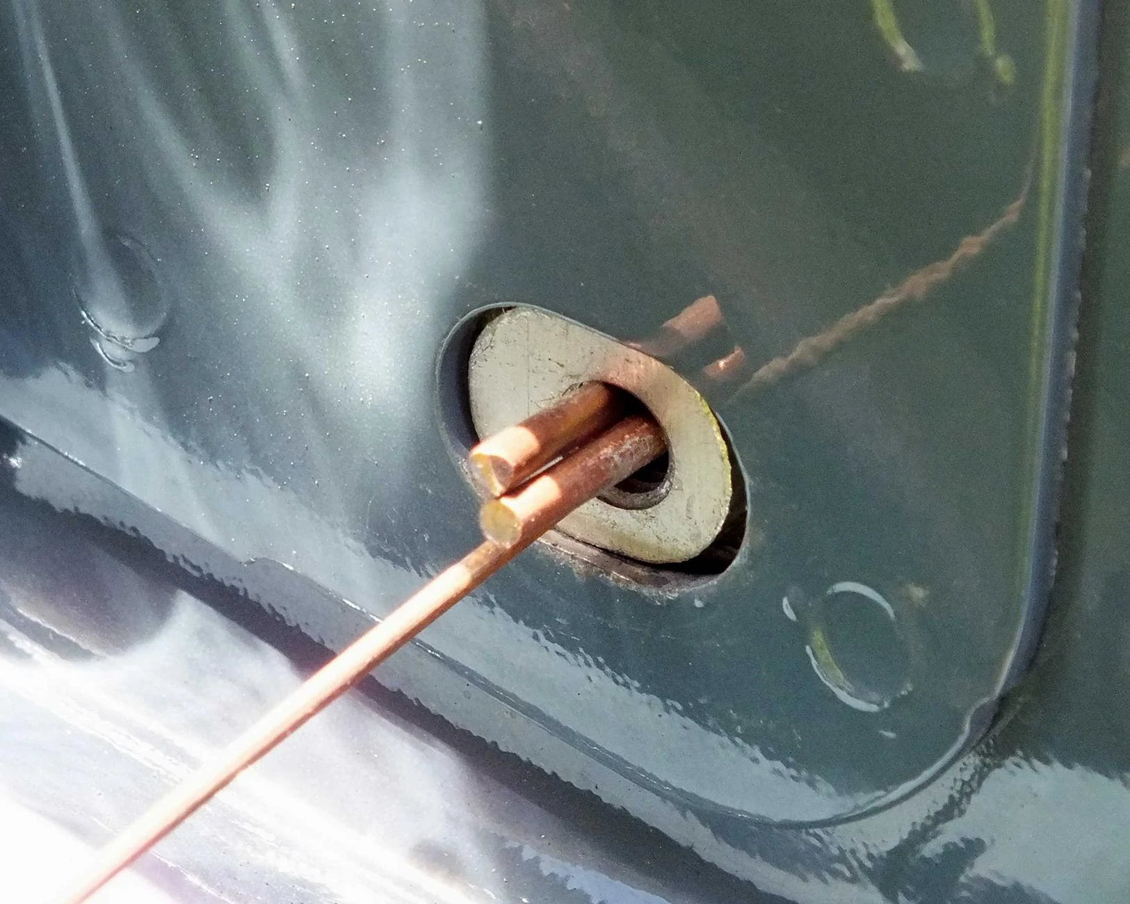

Ford Maverick Can't get bottle opener off. M2
I was able to reach thru the reinforcement holes using that wire, and eventually placed my nut in the requisite location. Yes, it took a number of tries. Did I say I was really grateful for that recovery thread?

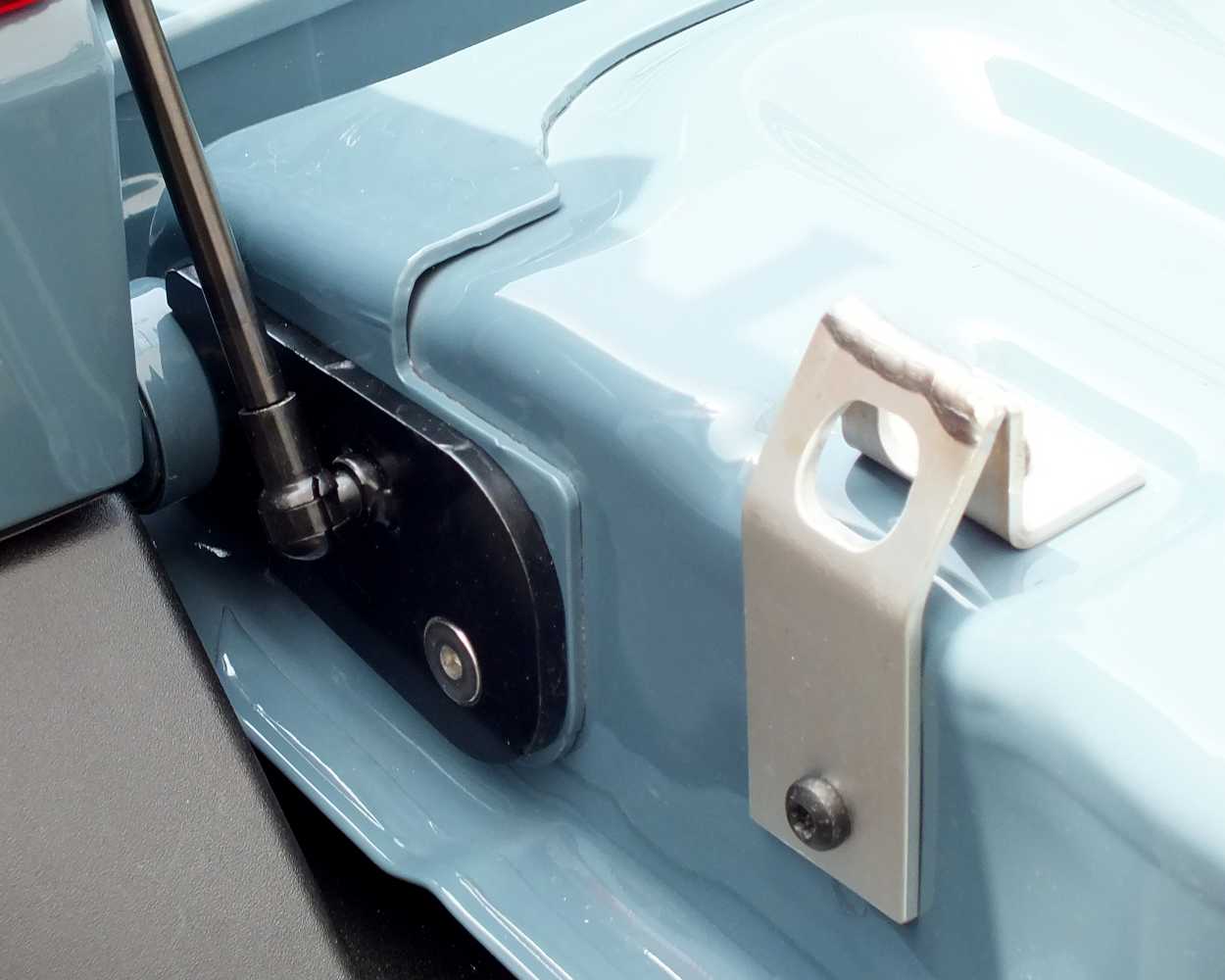

I wedged the nut in place with a small screwdriver when removing the wire and starting the bracket mounting screw. Only after the bracket was done did I break that thread. I'm happy with the result, but it was indeed much more of a hassle than such things should be, and I hope I never need to undo this mod.
My cheesy aluminum replacement tie-down bracket works fine, but it sticks up above the tailgate so I have to keep this in mind when loading. The shape and location clear when the tailgate is closed.

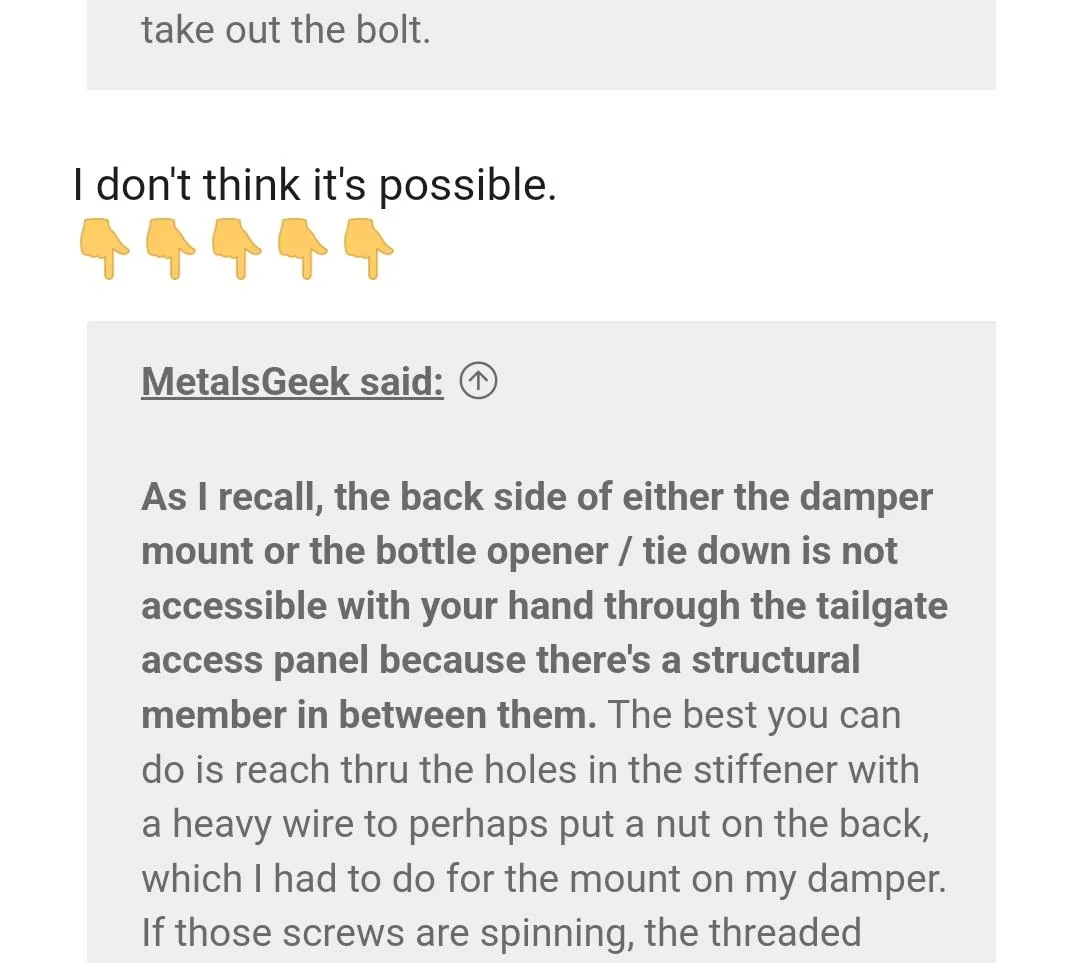

I was just quoting you.
I have no idea what is under the access panels.
Ford Maverick Can't get bottle opener off. Screenshot_2024-07-12-15-03-46-38_40deb401b9ffe8e1df2f1cc5ba480b12

Ooops. I see that now. Hopefully the first photo will answer someone else's questions on what's inside the tailgate.
So does this mean you don't agree with yourself??? 😱 😁😁
