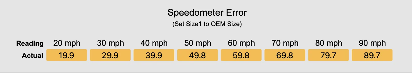

The one question I have though is the speedo. Per the Tire Size Calculator in the earlier post, it shows the speedo being off. I noticed the tires/wheels were reversed in the one shown so I went to the calculator and reversed the sizes and it sows when the truck is 20 MPH with OEM 18's, the 17's would be 19.9 MPH and changes the faster you go. So I guess there is an impact with the smaller 17's on my truck. Can that be adjusted or is it worth it?
Top is the OEM 18's. So when you are driving 60 MPH you are really going 59.8 MPH on the 17's.

I wouldn’t be concerned with that small of a difference. All tires will probably change .1 mph@ 20 just from new vs worn out (if not more). IMO, it’s not worth it to try and have the speedo corrected for 2/10ths @60.
hell, my Ducati motorcycles stated in the owners manual that the speedo would read 8% high from the factory!

Your speedometer isn't calibrated to that level, typically about 5% is what I've noticed against radar and gps. Ymmv though.

Okay, THANKS guy's. Gonna start looking at 17's in case the deal doesn't go through. Appreciate the input as that was my only lingering question.
